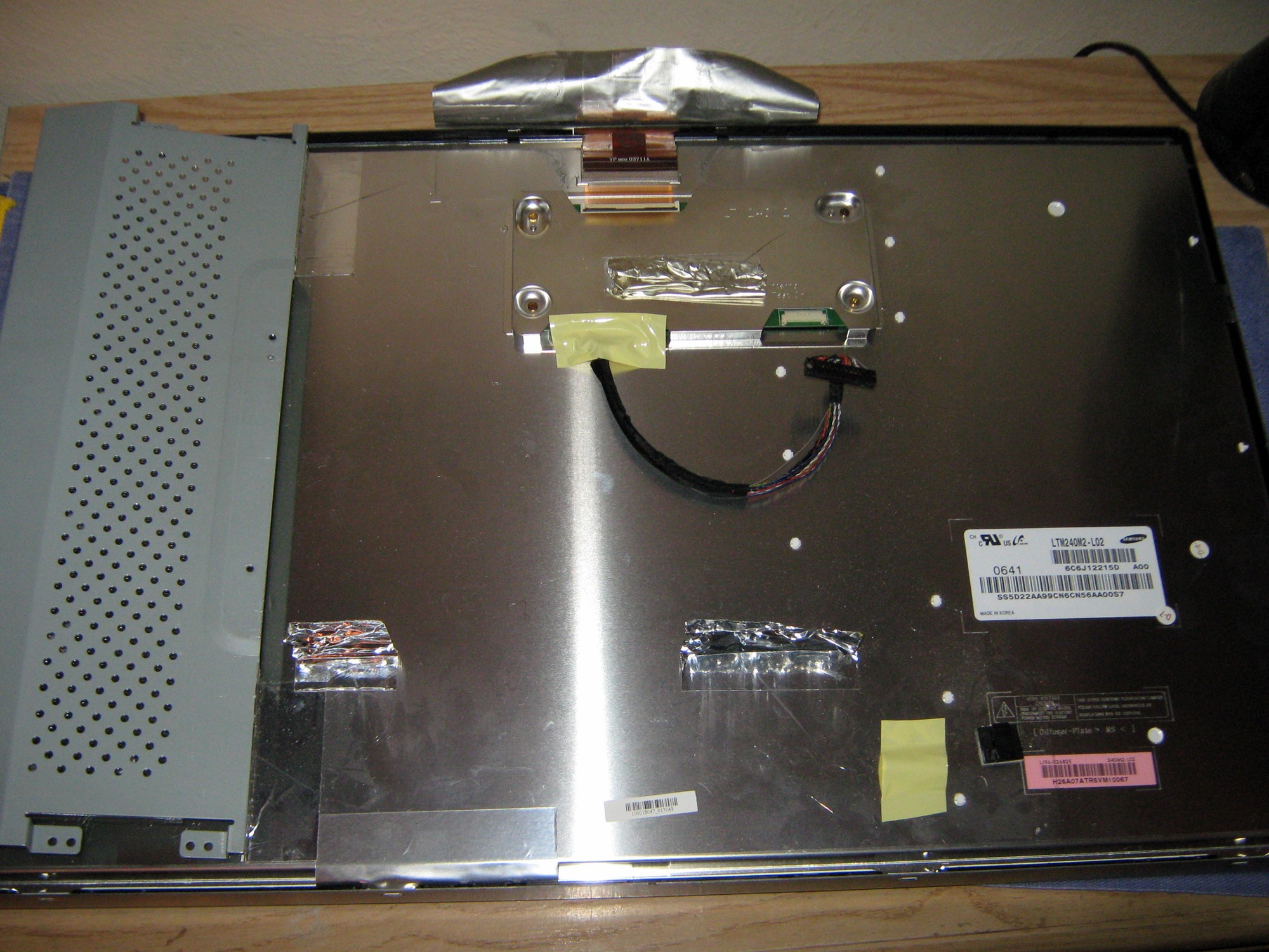

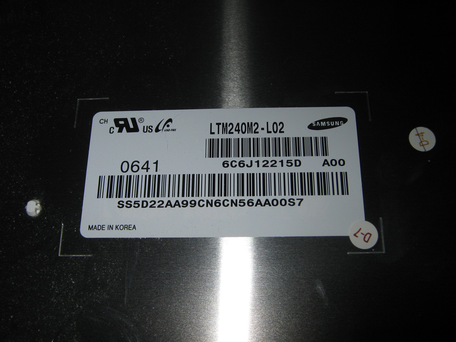

    Ok, I have the monitor torn down to the panel. Surprisingly, it is a Samsung LTM240M2, which is an S-PVA screen. Odd, because I looked up the specs for the AL2423W and it shows it to have an AUO M24OUW01 panel, which is a P-MVA screen. It looks like I ended up with a very nice panel, but the problem is that I cannot seem to get it open. It has a metal bezel around the outside that's held on by metal tabs. I popped these tabs, but it does not want to come off, so I suspect it is being held in place by some sort of adhesive. I don't want to be too forceful and risk damaging the screen. Anyone had experience with this panel or similar type before?
    Sorry about the flash in the pics, but it's nighttime so I really had no choice.

      4 or 6 screws on vertical sides? Keep working around the panel gently prying up on the inside backplate. It is probably just stuck from factory assembly. No, they don't use an adhesive.

        Well, I've killed it. I got the bezel off and was in the process of opening the panel when the screwdriver I was using to pop the taps slipped and tore off one of the flexible PCB cables. The worst that could happen did happen. Nothing more than than a $600 heap of garbage now.
        I guess I can sell it for spare parts, but that's about it. FML.

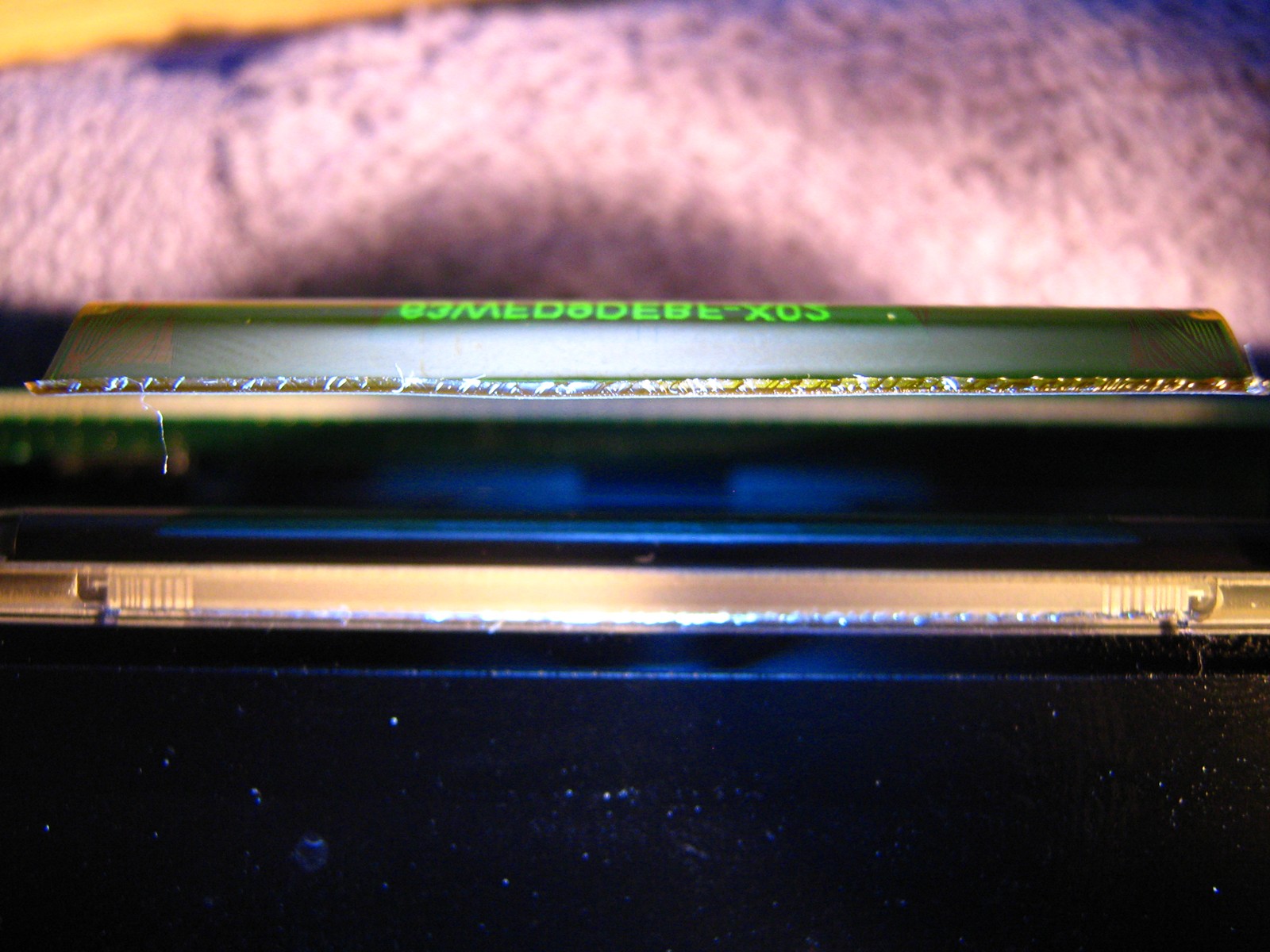

                Ok, another update. I finally got around to opening the panel up (propping the tabs open with paperclips - should have thought about that before). Tested the CCFLs and they all strike, lighting about halfway down the tube before the inverter cuts out. So, I assume all the lamps are good then? And the inverter is toast? Just gotta figure out what is good and what isn't. Might sell the parts or find a replacement panel and drop that in for a spare monitor or sell it and recoup some of my loses.
