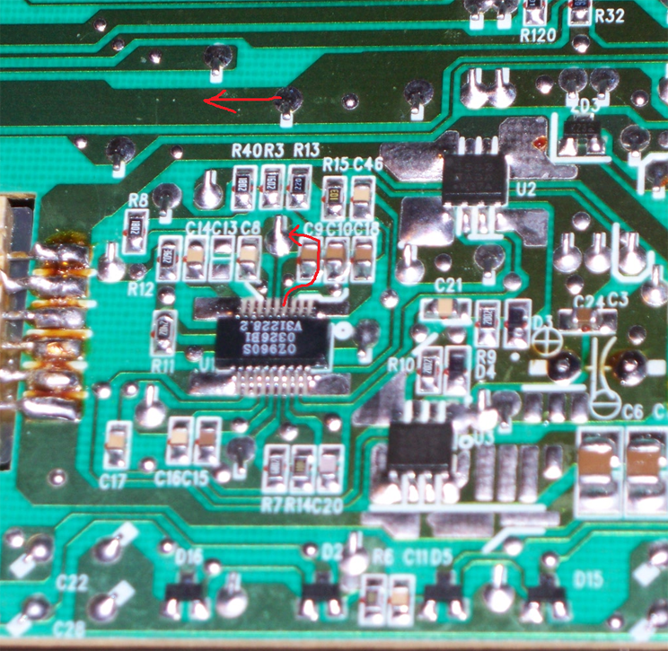

    This is a low probability, but just for my own curiousity, can you carefully measure the voltage across the main filter capacitor (the big one) and see if you get steady DC voltage?
    You are looking for a steady voltage while the screen is flickering. You can use the original ccfls for this test.
    For this test, I like to use aligator clips with my multimeter so I can do this measurement without using my hands. It is high voltage that you will be measuring (about 165V DC).
    When the lamps are off, it read 153.6 to 154.6 VDC. When the lamp flicks on, it drops down to roughly 150 VDC. The lamp doesn't usually stay on long enough to get a very precise reading with my DMM.

      Originally posted by torin3 View Post
      U2 = 4542 / (logo)AD(Delta smbol) / W37A
      U3 = same as U2
      Datasheet for 4542 is at
      http://pdf1.alldatasheet.com/datashe.../KI4542DY.html
      Let's see if U2 and U3 are good?
      If any ohm reading is less than 30 ohm you might have shorted mosfet. Remove from circuit and repeat the tests to verify.
      Some mosfets are more than 3 pins. To test those, identify the part number and search for its datasheet. Once you find the datasheet, the pins will be designated source (S), gate (G), and drain (D). It will probably be documented as S1, S2, G1, G2, D1, D2.
      Simply test
      a) black on pin S1- red on pin G1 - record ohms
      b) black on pin S1- red on pin D1 - record ohms
      c) black on pin G1- red on pin D1 - record ohms
      Repeat for the "2" pins. That is S2-G2, S2-D2, G2-D2.
          Would I need to test out of the circuit if all are over 30 ohm?
          Code:
          -------U2----U3
          S1-G1 100K 100K
          S1-D1 OOR  OOR
          G1-D1 OOR  OOR
          s2-G2 736  737
          S2-D2 460  460
          G2-D2 72K  72K
          OOR = Out Of Range on the 2000K selection
            #45
            Re: Sony SMD-HS73
            U2 and U3 test/look fine. You would need to test out of circuit if the readings are less than 30 ohms.

                      Re: Sony SMD-HS73
                      May I suggest that you take some voltage measurements off of the OZ960 (U1). Pins 2 (OVP), 5 (VDD), 10 (CMP). Use Pin 6 for ground.
                      With power off and monitor unplugged, try checking/measuring the capacitance of the cap off of pin 4 (SST) of the OZ960.
                        #51
                        Re: Sony SMD-HS73
                        I'll get the voltage readings in just a bit. I had to jury-rig some leads for the capacitance reading. My meter than has capacitance (only up to the 20uf range) has just the 4 holes for sticking in cap leads. I tested the leads I made against a 1uf cap I'd tested the normal way and the readings were the same. So I think I'm ok with this method.
                        C9 = .82uf
                        C10 = .17uf
                        C18 - .84uf
                        (C locations from the photo, not a data sheet)
                        Edit: Pin 2 mostly at 0VDC, but bounces up to .74VDC
                        Pin 5 seems to mostly stay around 1.17VDC, but bounces from nearly 0 to up to around 5-6VDC
                        Pin 10 seems to stay mostly at .47VDC with drops down to about .05VDC and up to about 1.2VDC
                        Last edited by torin3; 12-12-2010, 10:45 AM. Reason: Double checked to fix memory error

                          Re: Sony SMD-HS73
                          Pin5 (VDD) is the voltage supply pin required by the chip to operate. The specs call for a voltage between 4.7-5.5V and is generally supplied by the 5V output of the power supply. If it's bouncing around, then I suggest you check the components connected to that pin to see if anything is open or shorted.
                          Also, make sure you're still getting a steady 5V and 12V output from the power supply.
                            #53
                            Re: Sony SMD-HS73
                            If I'm understanding the path from pin 5, it is going through C9 and then to J7 where it jumps directly to ground. Other than going through C9, it appears to follow the same path to ground as pin 6.
                              #54
                              Re: Sony SMD-HS73
                              Check out Figure 1 on the spec sheet. It's really simplified, but should give you a better idea how this chip works. From Fig 1, the cap connected to pin5 has one end at ground and the other end to 5V. The question is: what other components are between that cap and the 5V that causing the low VDD?
                                #55
                                Re: Sony SMD-HS73
                                Ok, I'm lost here. Looking at the schematic, I see there should be an R1 at 33 ohms in between pin5 and 5VDC. I found a location marked R1 on the bord, but there is no component there, just 2 solder balls. Just for the heck of it I check the resistance, and between each side, it was 102ohms.
                                Also, the pins aren't matching up in the schematic to what is on the board. Pin 4 on the schematic goes to C9, but on my board it goes to C10. Pin 5 in the schematic goes to C2, but on my board it goes to C9. C2 is on the other side of the board and it is marked E 222M 3KV. If I understand the datasheet it is 2200pF ceramic cap.
                                Anyway, I don't seem to be able to trace where the circuit goes, as I don't have a schematic for it, and visually following the traces isn't working. The component numbers aren't matching up for the datasheet schematic you attached. I really don't know what to do.
                                Help?

                                  Re: Sony SMD-HS73
                                  What are 5volts pins doing on CN1, steady or coming and going?
                                  Al.
                                  Whatever I do, I consider it a success, if in the end I am breathing, seeing, feeling and hearing!
                                    #57
                                    Re: Sony SMD-HS73
                                    Help?
                                    Let me explain. What's supplied by the manufacturer of the chip is meant as a guide to help the designer understand how the chip works. It is in NO WAY meant to correspond to the configuration of your board. It's up to the designer to determine how much of the chip manufacturer's design they want to use. It could be some of it, or none of it. Since I don't have a schematic and only photos to work from, I have to use something besides words to get the point across. At this point, it's going to be rough if you can't trace the voltage feeding the OZ960.
                                        I didn't think there was an exact correlation, but I was grasping at straws here. I'll post a real closeup if I can of the area, but I really don't see where it is getting the 5VDC from. Unless there is another layer to the board with hidden traces. But it doesn't look like a multi-layer board as far as I can tell.
