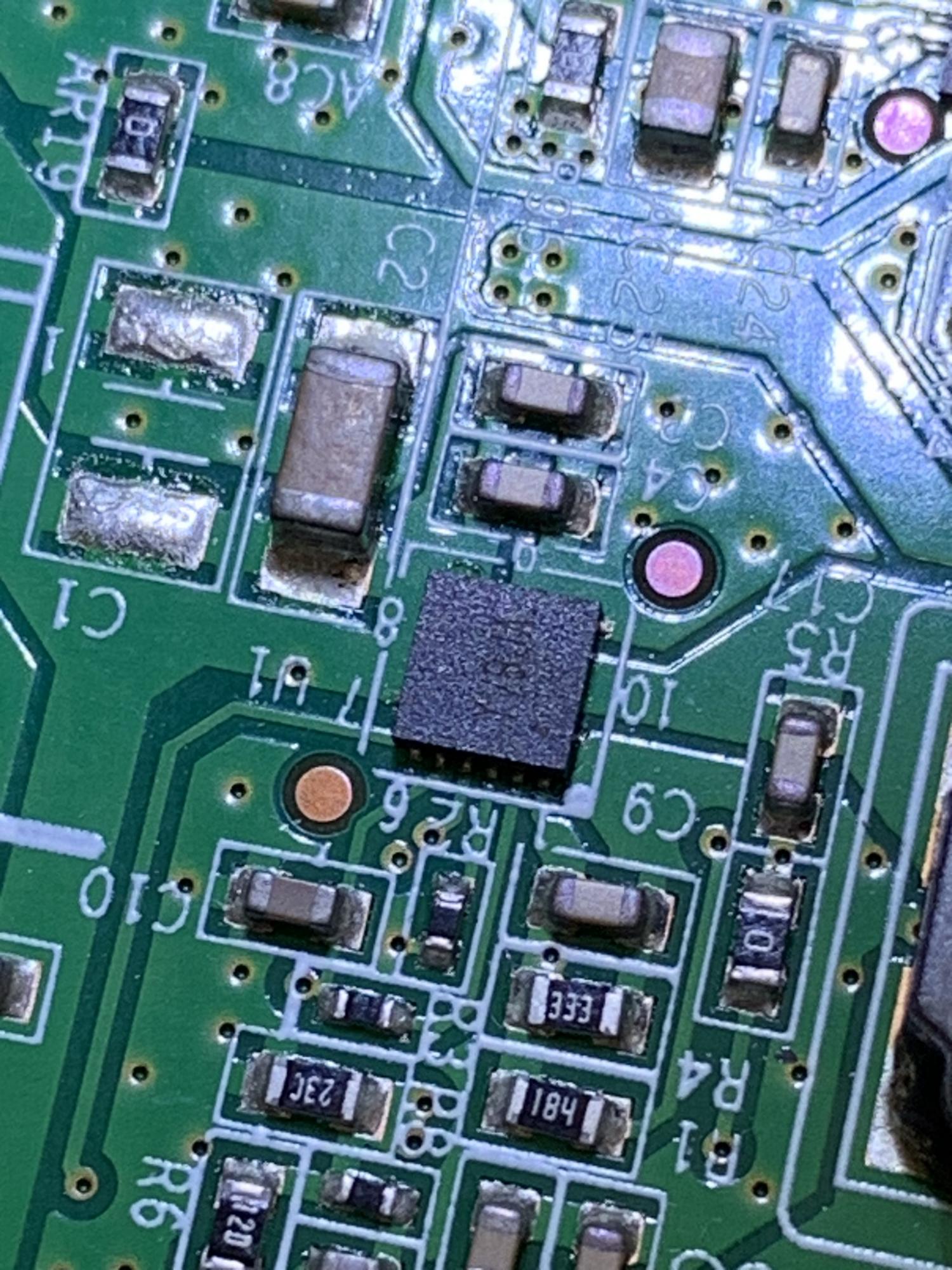

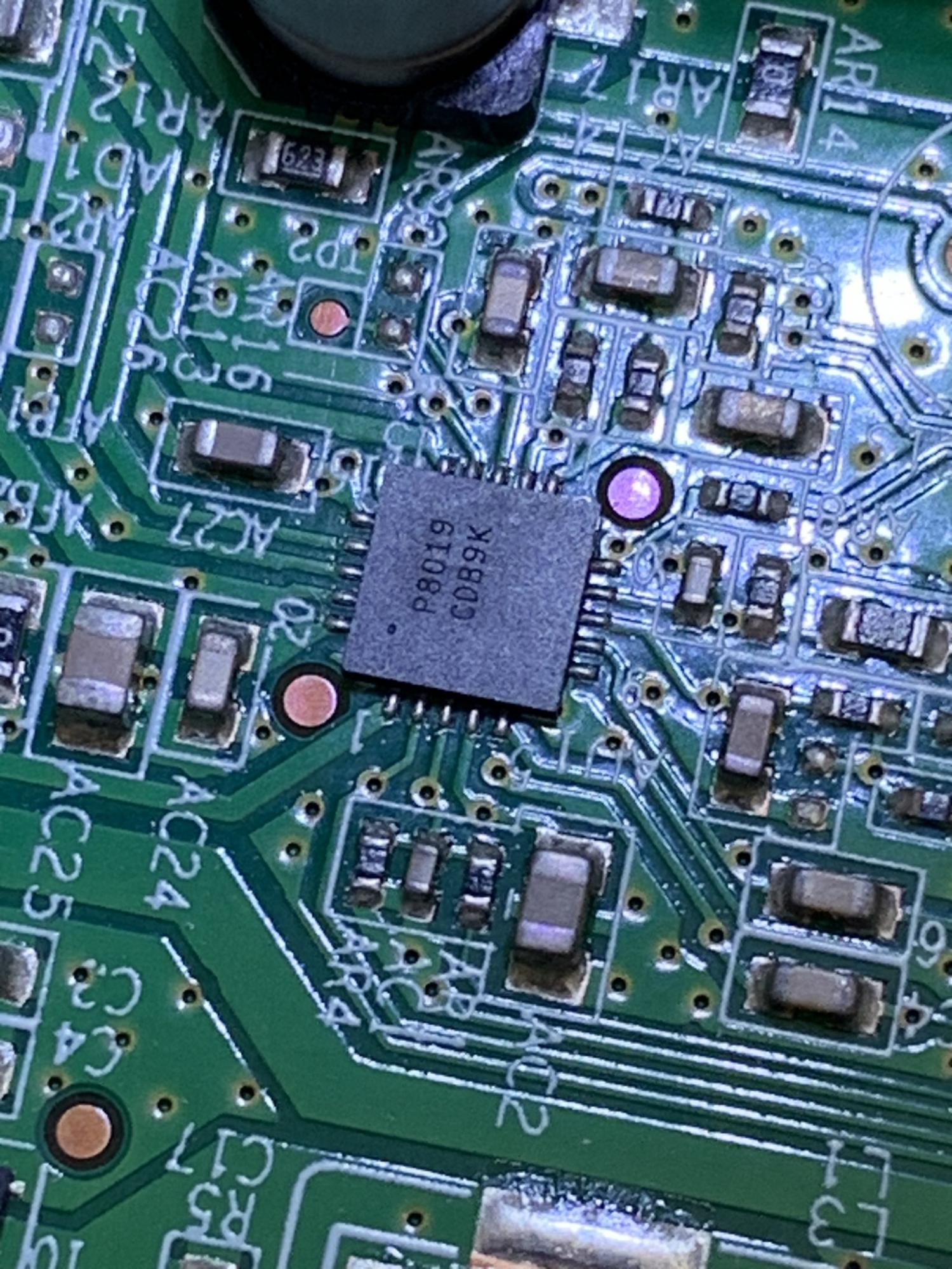

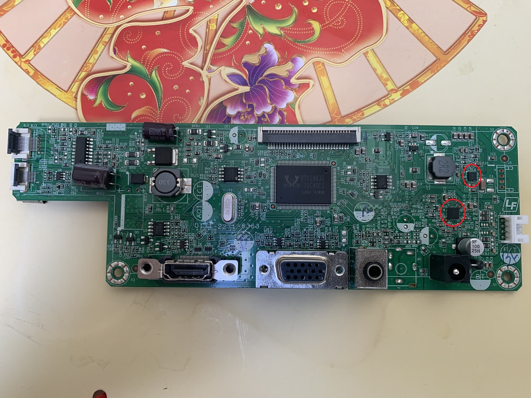

    I found that when turned on, there is no voltage on all capacitors. So I suspect that something wrong with the chips. I started with the two chips closest to the power input, the one with the markings of "P8019 CDB9K" and "YVBJA". But I could not find any information from the internet. Could somebody please help me to find the information/datasheet on these two chips?
    Of course, any suggestions on how to fix this monitor will be welcomed.

    Re: Asus vz239h-w no display
    YVBJA = SY8366QNC
    P8019 CDB9K = APA2604CQAI

          Sorry, I made a mistake. I mentioned that there were no voltages on all capacitors after turning on the monitor. That is incorrect. I just found that the power plug is loose making no contact at certain angle and so I could not get any voltage. But the no display problem and other founding are still true.
          I am now trying to check which components might be defective by following the service manual provided by Lisa Su.
