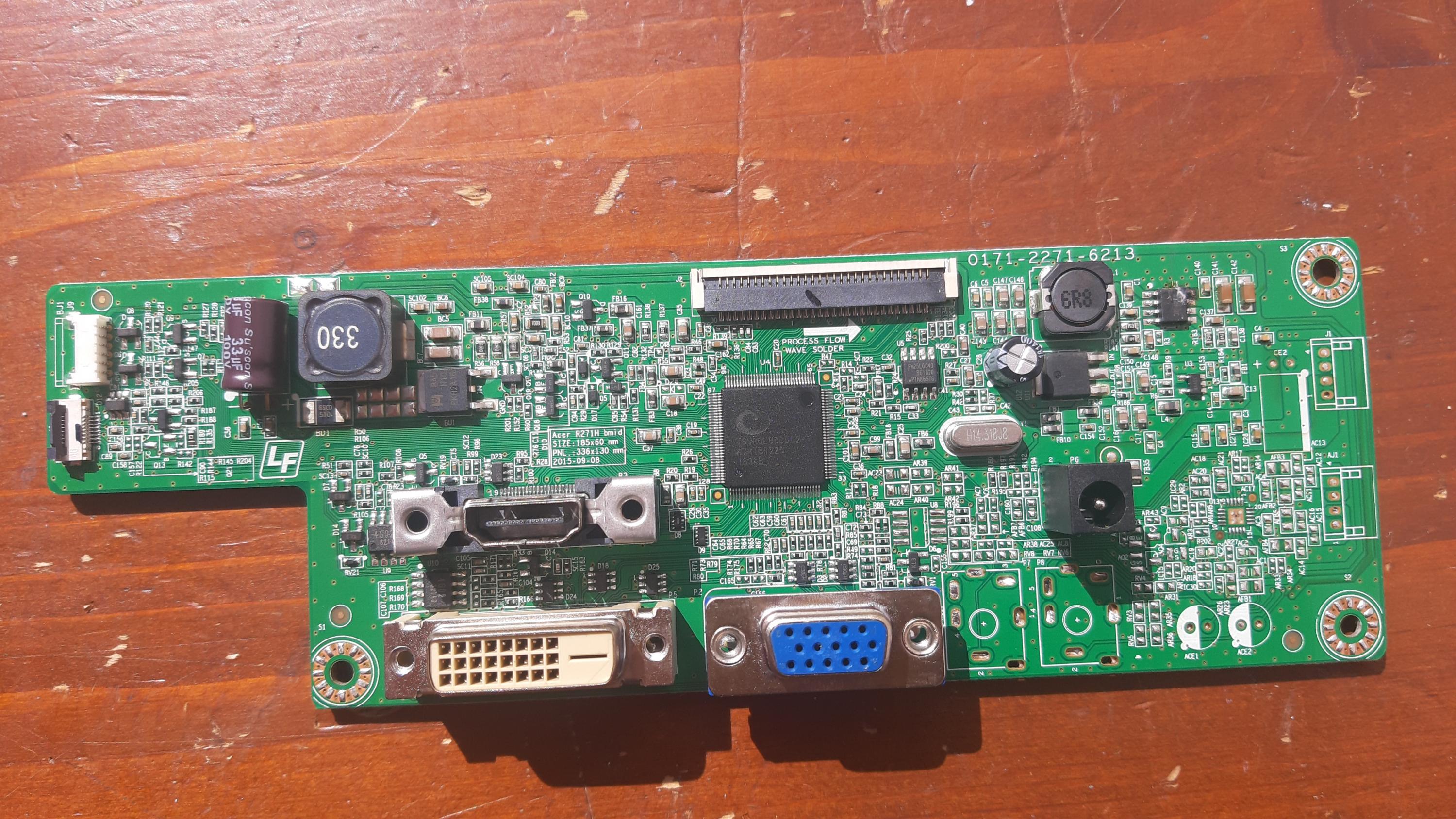

    I am currently trying to repair an acer R271 monitor board 0171-2271-6213 with a shorted ?voltage regulator TJ1119CG but can't find.
    any one help.
    It is the one just below the 6R8 inductor top right hand side if board.
    thanks andy

    Re: Acer R271 Monitor
    Look at the last numbers (Fixed Output Voltages : 1.0V, 1.1V, 1.2V, 1.8V, 2.5V, and 3.3V), they indicate the output voltage on this regulator, you can pick up analogues.
      Thanks at have ordered some.
      thanks again
      andy
