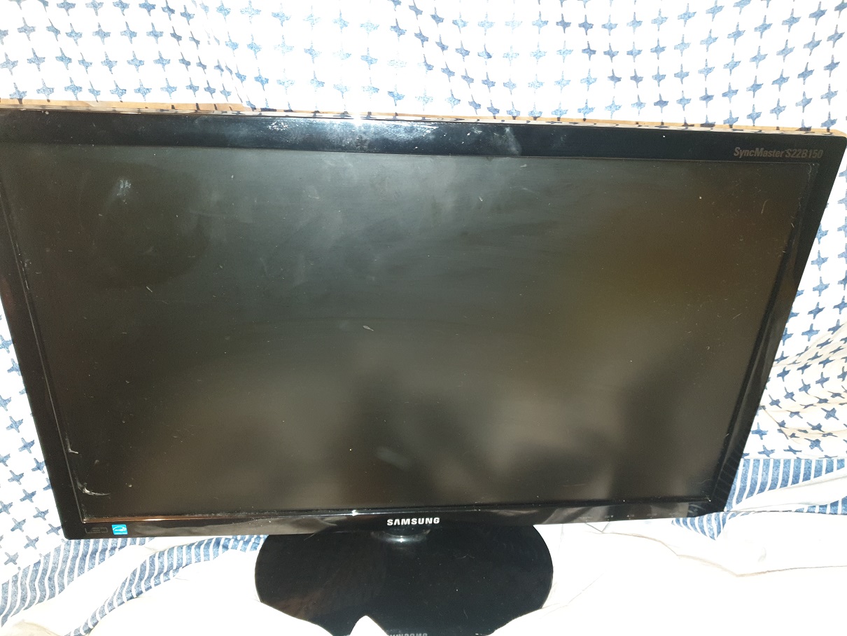

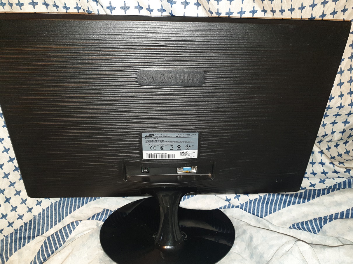

    I found a Samsung S22B150N in someones dump pile next to the road, so I grabbed it. Dunno if it works or not, physically it looks fine, but we had a little rain, so there's some wet spots (though it doesn't look like it got drenched, maybe a little sprinkle).
    Anyways, I haven't plugged it in, I wanted to inspect the insides for water before doing that. Only issue is, I don't know how to open it...
    I thought maybe the front bezel pulls off, but it's hard to get a grip and feels like it's on there good. I don't want to pull too hard and break something. I can't see any additional screws wither.
    Anyone familiar with this monitor? Are there sections with a tab you push in? I can't see any...
    Thoughts ?

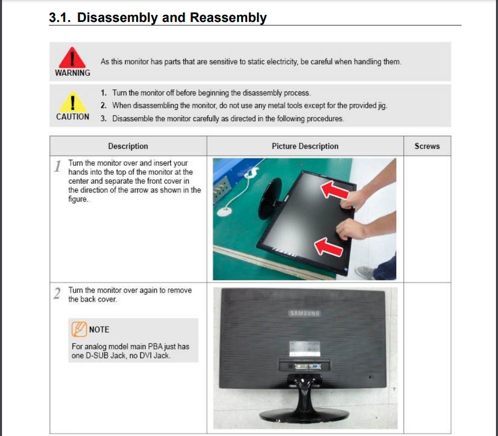

    Disassembly and Reassembly

      Awesome, thank you Lotas . Curious where you found it. Service manual?
      Step 1 got me stumped for a little bit I must admit. Thought it was telling me to lift and slide the front face downwards, but I just had to lift and unclip starting at the top and moving downwards. Got it in the end though.
