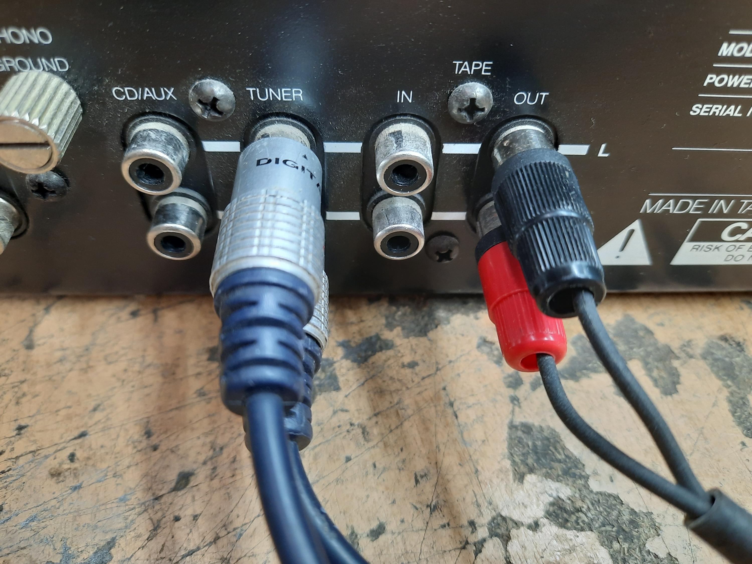

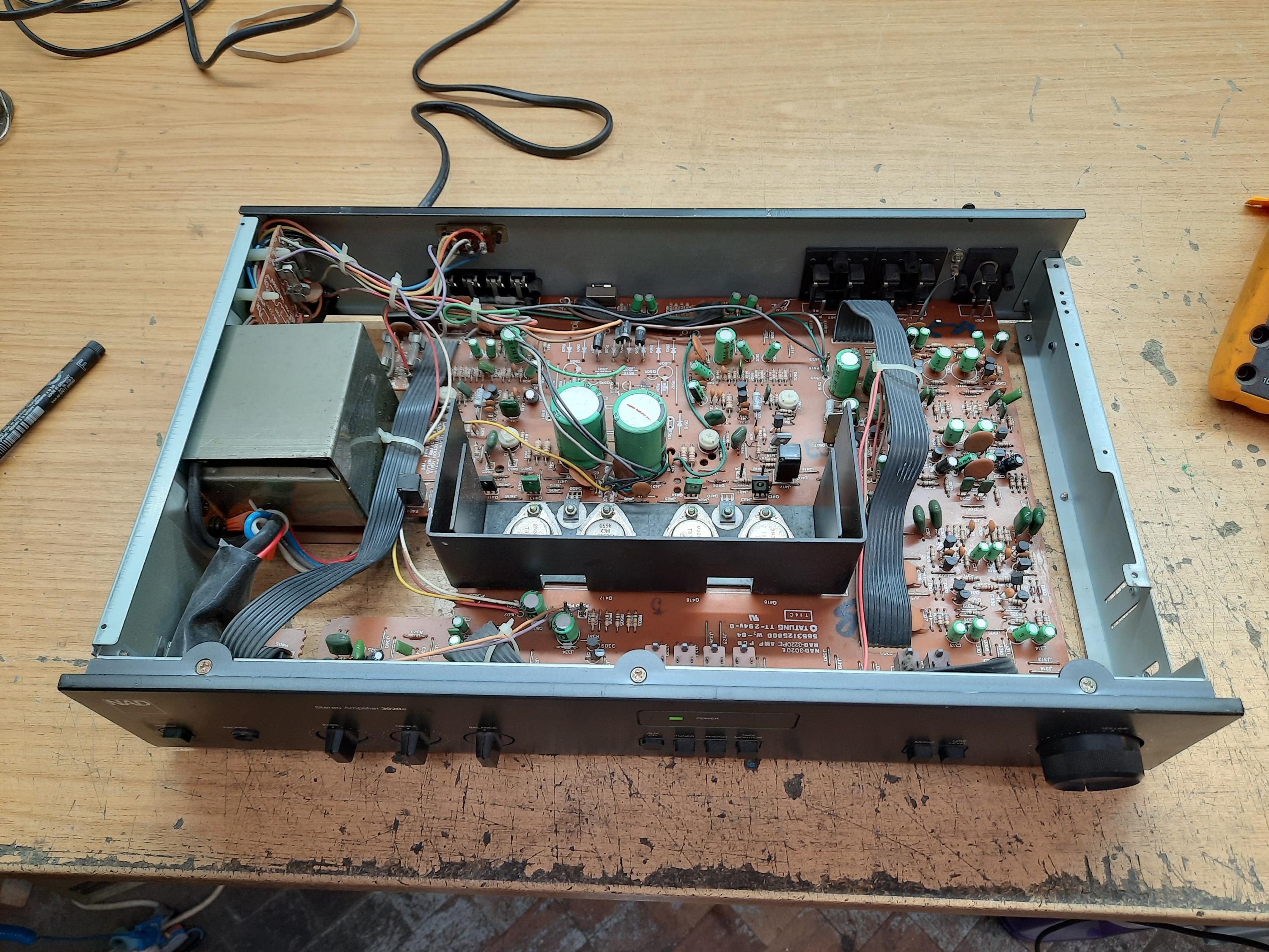

    Hi all This amp has distorted audio via RIGHT channel.
    Re: 3020e, NAD amp schematic/advice please
    I ran an input via CD/AUX plus Tuner, & then signal via tape out to another amp.
    Both channels crystal clear.
    Not sure what this proves, except possibly part of the pre-amp working.

      Very strange, after I tested again RIGHT channel fine.
      Took a chance & checked all the electrolytic caps, replacing a few mildly suspect ones, plus reflowing many solder joints on the main board.
      Also cleaned all switches & controls.
      Now working on test.
      Wish me luck
        Bad connections on the soldering pads are common to most Nad and Proton devices. A recap would be a good idea.
