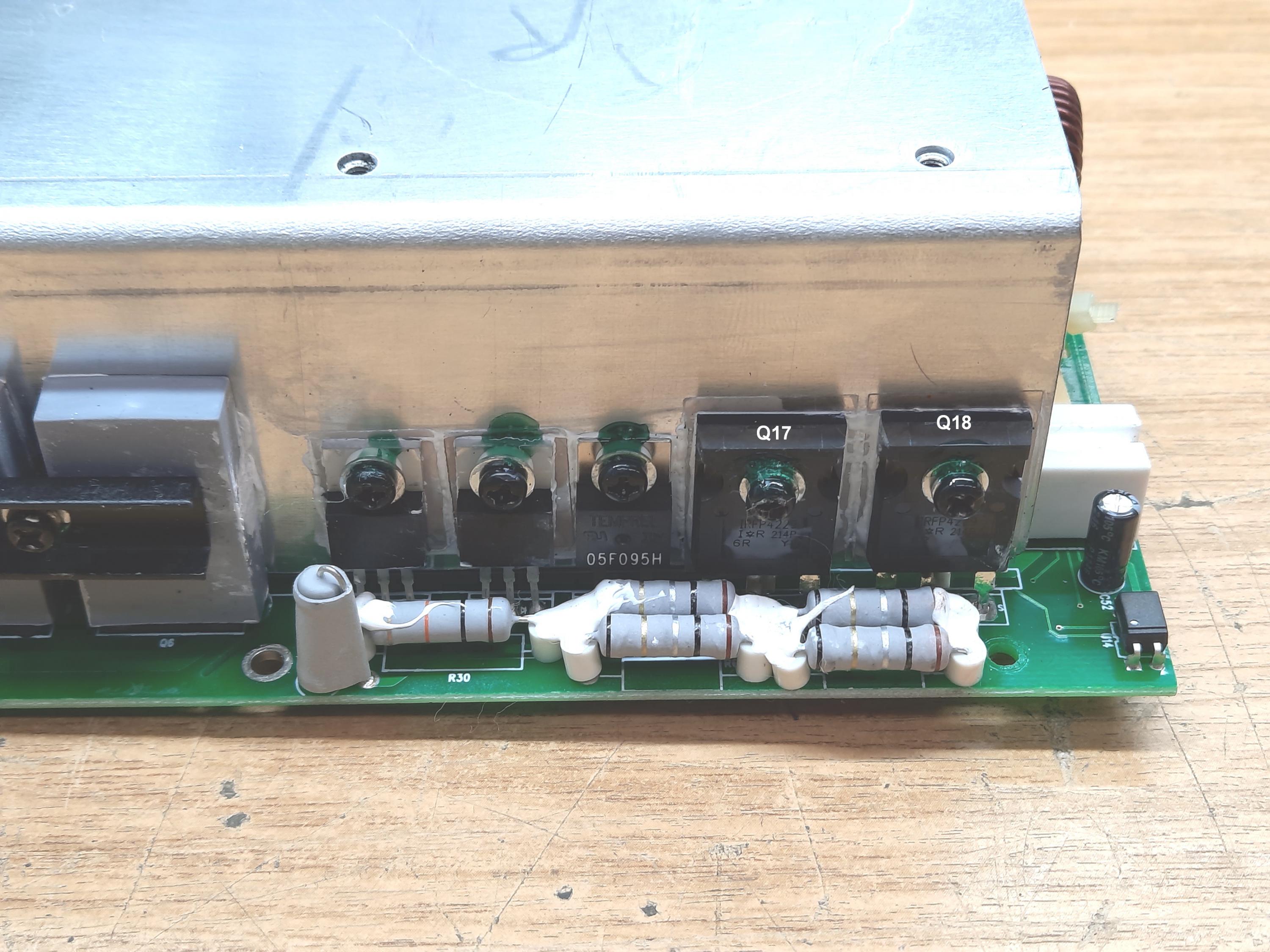

First casualties ..
Q17 & Q18 , both type IRFP4229
Q17 S/C , & will also replace Q18 as they seem to work together .
Now on order & will update thread once parts arrive .

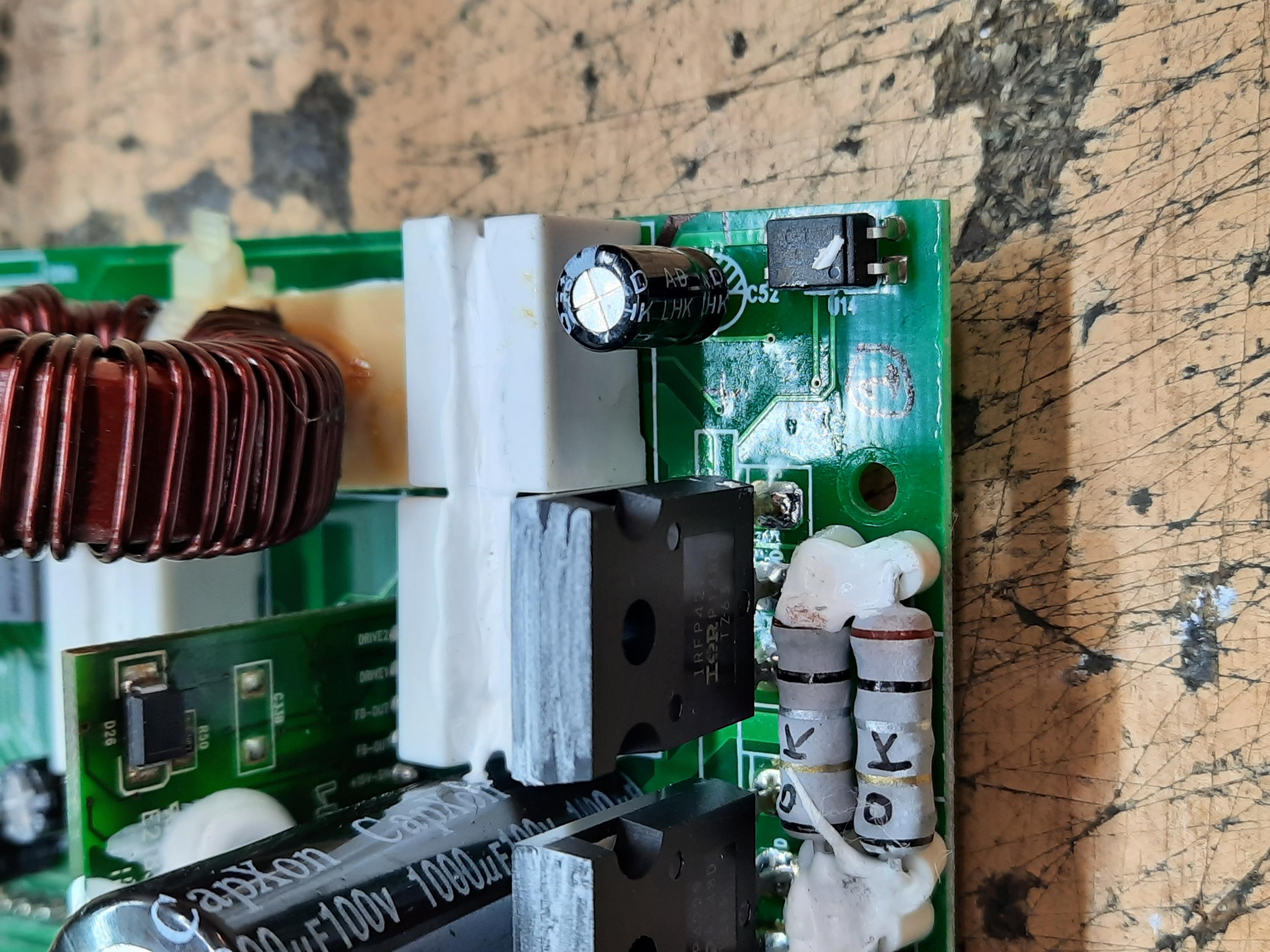

Back onto this repair .
C52 , 10MF , 25V , POOR ESR

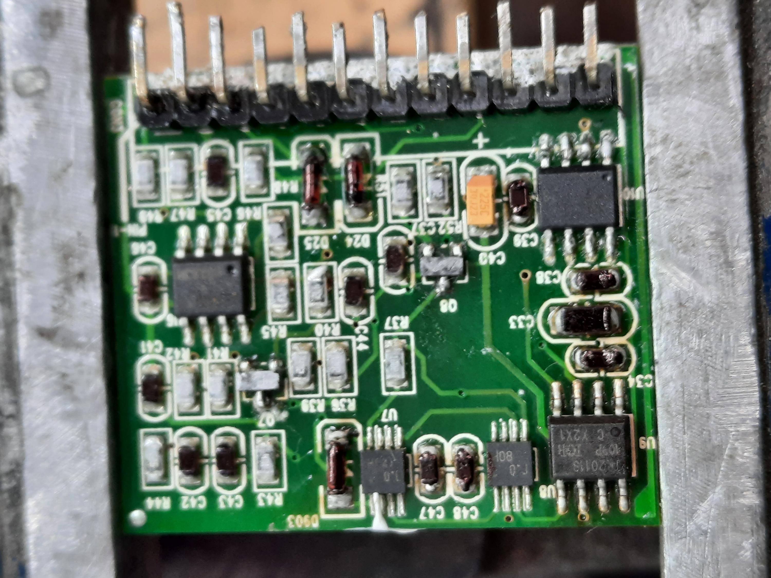

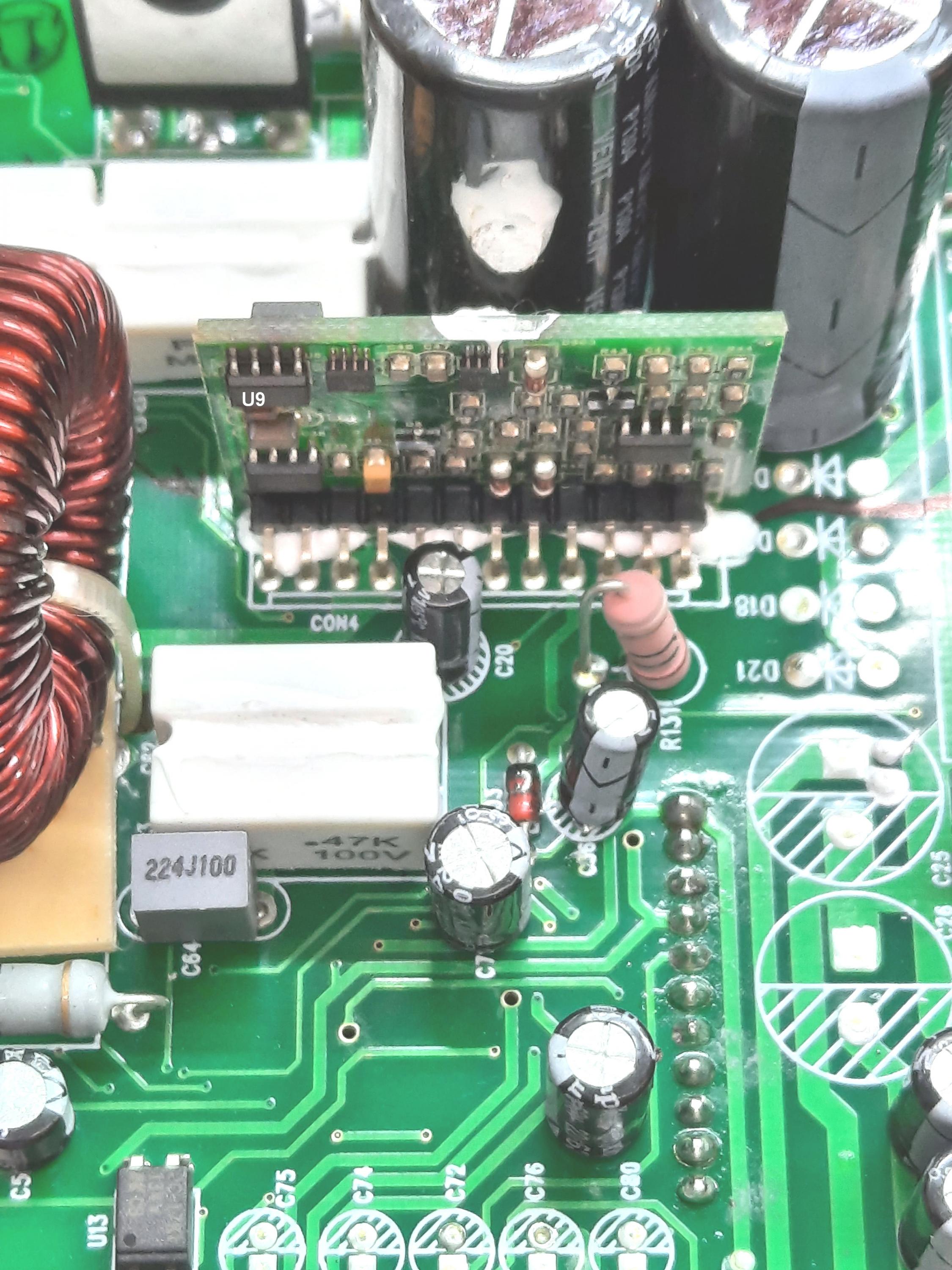

Also replacing drive chip for Q17 & Q18 . Looks a bit stressed & wouldn't want to take a chance .
It lives on a sub module , REF U9 , type Infineon IR2011S
Post
Cancel
zen
Join Date:
Apr 2011
Posts:
505
08-25-2022, 08:15 AM
Re: Wharfedale Titan Sub A12 , schematic/advice please
C40 , 2.2MF , yellow SMD cap faulty .
Lives on same sub module as drive chip .

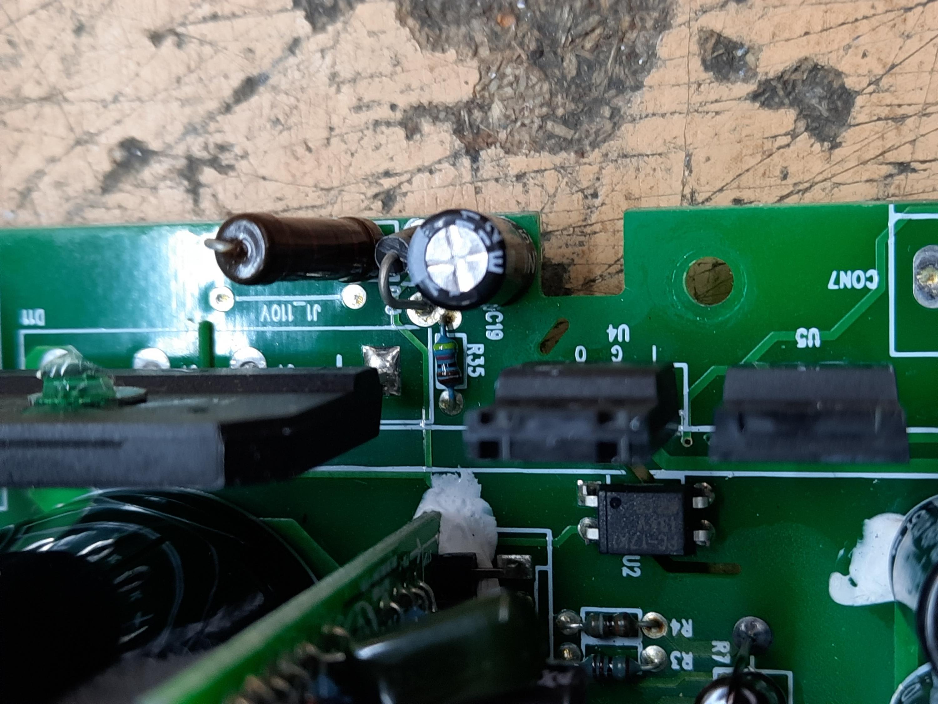

C19 ,10mf , 100v ,poor esr
