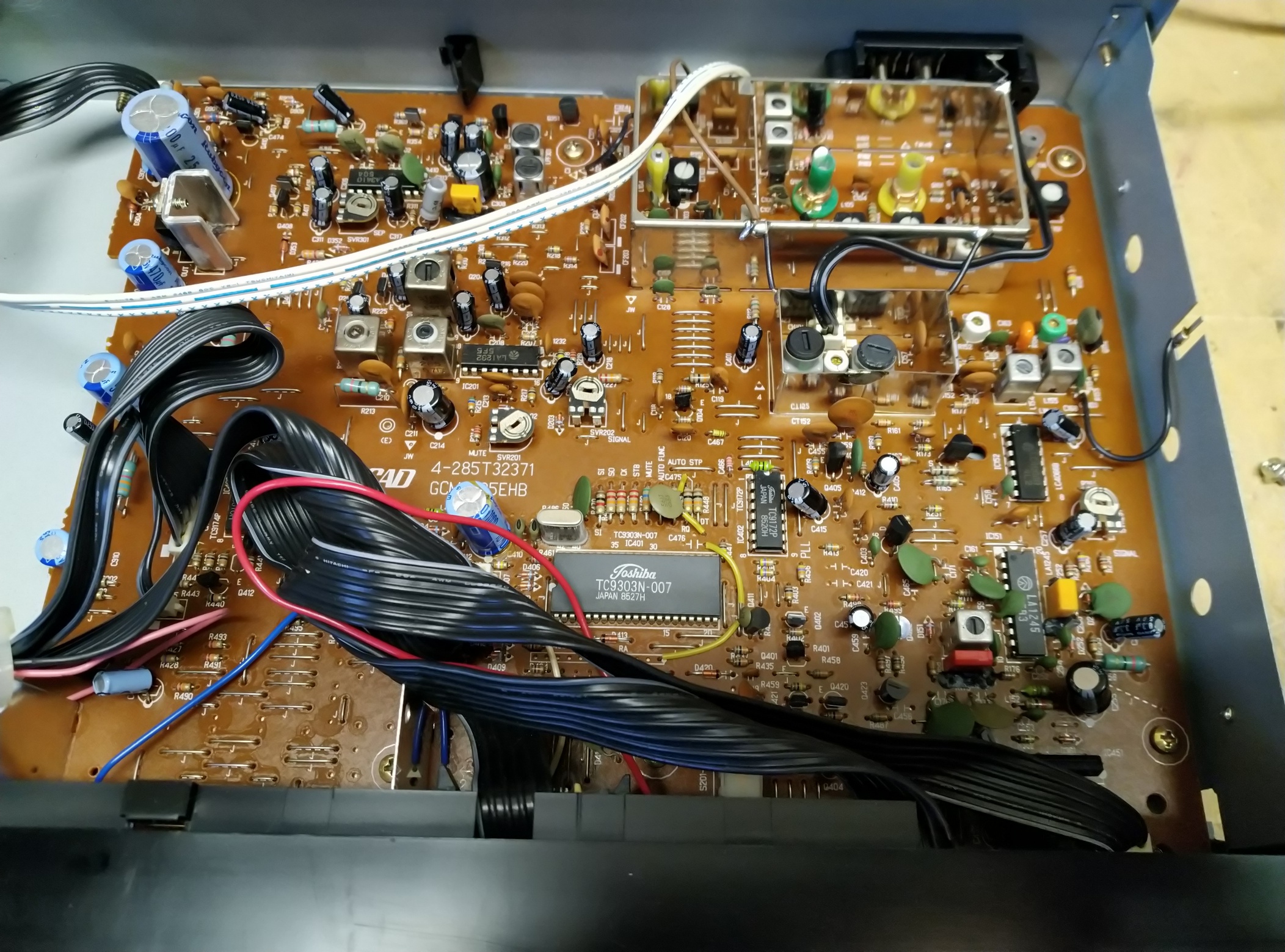

    Sanyo JT760L Tuner station memory
    What keeps the presets in the memory? There's no battery, but the memory lasts only 1-2 hours without power. Could it be that large capacitor?
    The thing is a Sanyo JT760L, it has its own power but the signal etc were via a ribbon cable. It now has a RCA-jack.
  • redwire
    • Dec 2010
    • 3912
    Re: Sanyo JT760L Tuner station memory
    I thought these have no preset backup. Mains power is always on, so they are like a clock that must be set with a power outage. The 1,000uF capacitor can keep data for a little while. I could not find the schematic, Sanyo JT-340L is the highest they go at hifi Engine
    https://www.hifiengine.com/manual_li.../jt-340l.shtml
    Toshiba tuner MCU TC9303N I could find no other data.
