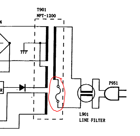

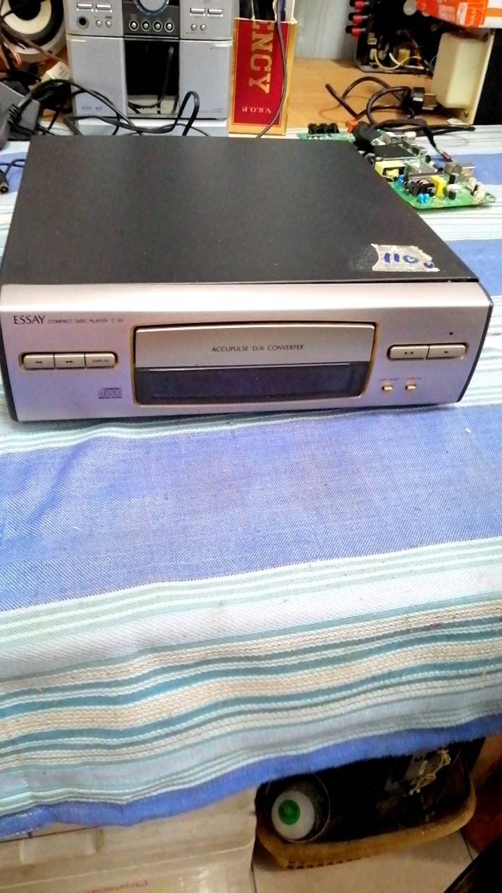

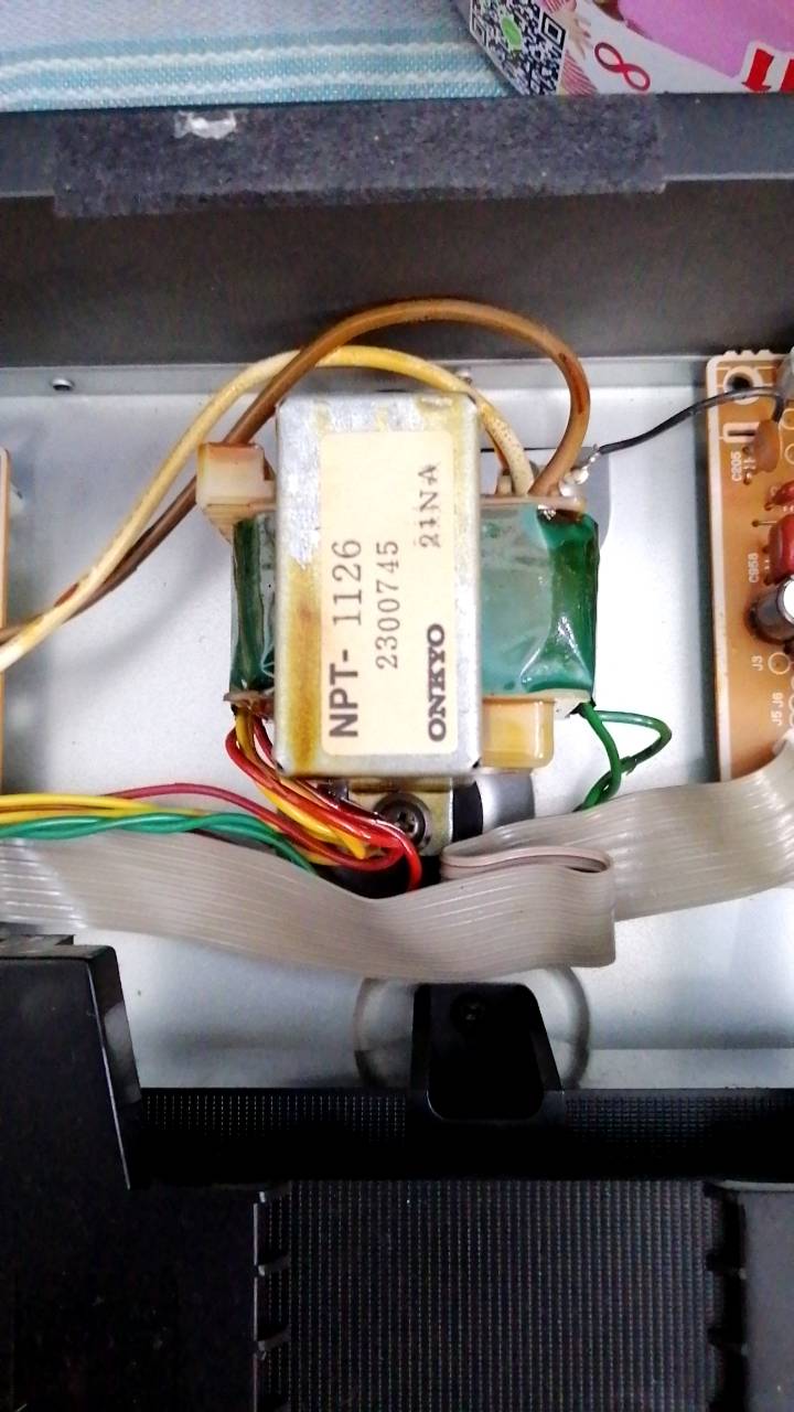

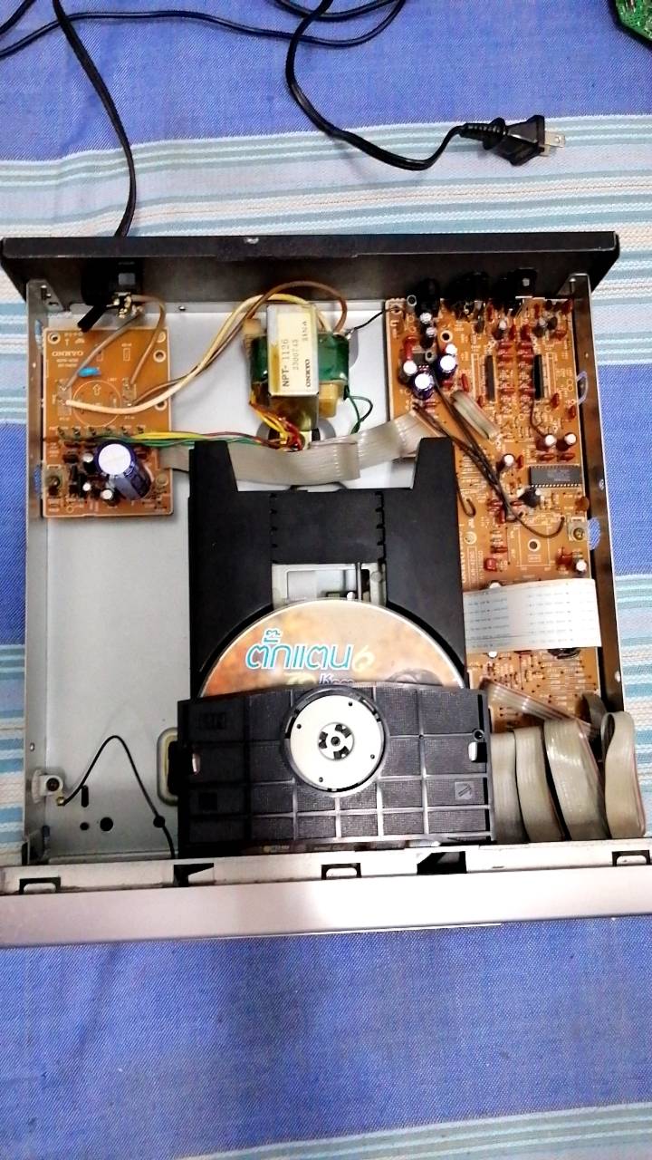

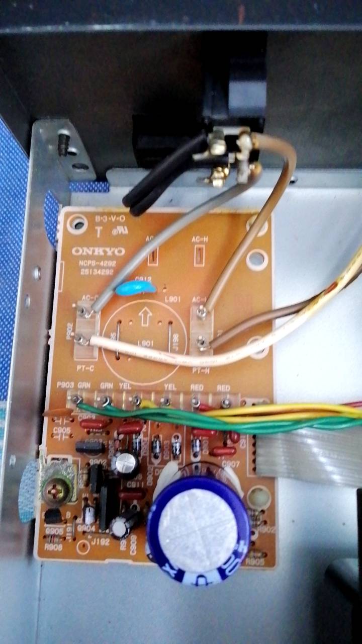

    Hi everyone
    this cd player use 110VAC with unaware thailand use 220VAC resalting primary transformer open circuit, now I want to know secondary of transformer how many volts out (3 secondary ) sorry my english
  • petehall347
    • Jan 2015
    • 4427
    • United Kingdom
    Re: onkyo essay c-55
    power it up with 110v and measure with your meter
    • lotas
      • Jan 2016
      • 4616
      • Russia
      Most likely, the fuse in the transformer itself has burned out, it must be restored, a jumper must be installed.
