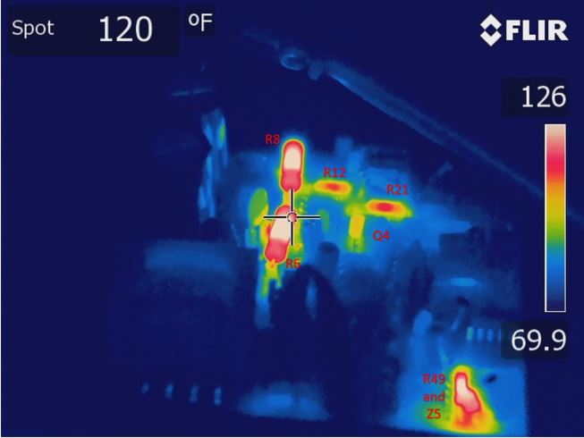

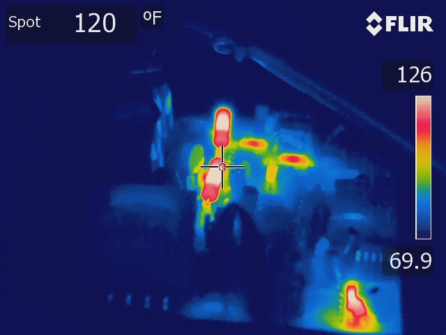

Attached is an thermal image without the mosfets installed. The second pic has the labels. Not sure if this tells us anything. Took the picture with the sub hooked up with the dimbulb test with a 100 watt bulb in it. The bulb dimly lights up for moment and turns off.
It's normal for the bulb to light up for a moment and then go out when plugging in a device with large input primary caps (i.e. the two 200V caps.) Basically, since the 200V caps are uncharged, they pull a substantial "surge" current as they become charged when the amplifier is plugged in, which is what makes the bulb glow. Once fully charged and at their normal voltage operation levels, the surge current stops and the bulb goes out.
As for the thermal images... looks like your hottest component are R8 and R6, which shouldn't be surprising at all. These are the resisitive droppers that provide P15V and N15V power supplies. And like I noted above, this is a very inefficient way to do that, so that explains why they are running hot.
That said, seems like they are running around ~130F (54C), which isn't really that hot. So everything looks OK there.
However, looks like Q4 is running hot, while Q2, Q3, and Q5 aren't (?)
In that case, I suggest you remove Q4 and test it out of circuit. Better yet, replace it if you have spares.
Also check the values of all resistors that connect to Q4. I don't believe Q4 should be running hot at all with the main transistors (Q1 and Q7) removed.
While at it, also check the voltages across C21 and C27, then report back what they are.
And if you can, check voltages across C5 and C6 as well (but be careful around these, since they are on the primary side.)
It only appears that Q4 is warm. I will test as I don't have any spares. I tested R12 and it was fine. I will have to figure out where R5 is. Most of the resistors are soldered right next to the board and I can read the screen printing underneath them but I can figure it out.
