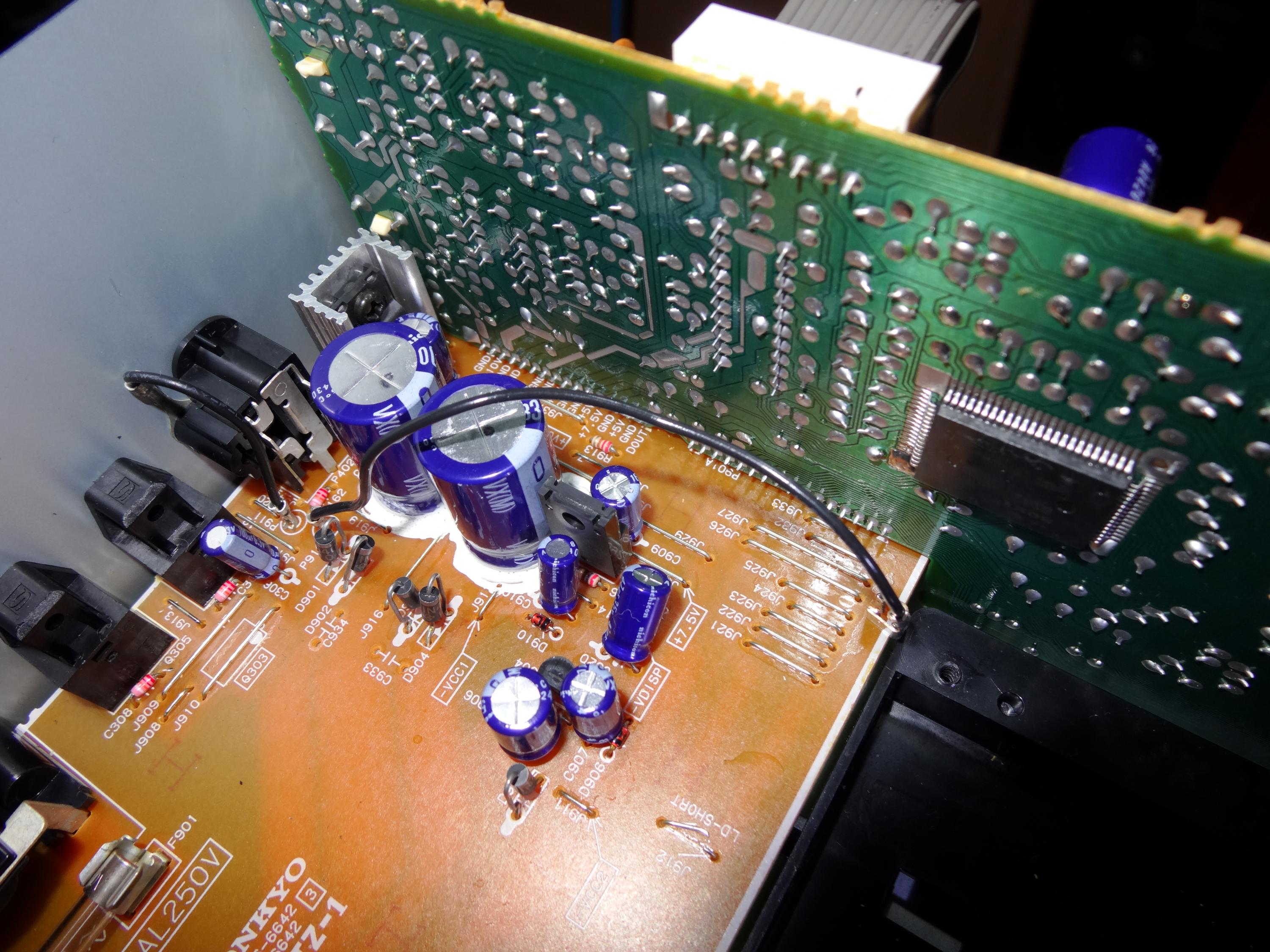

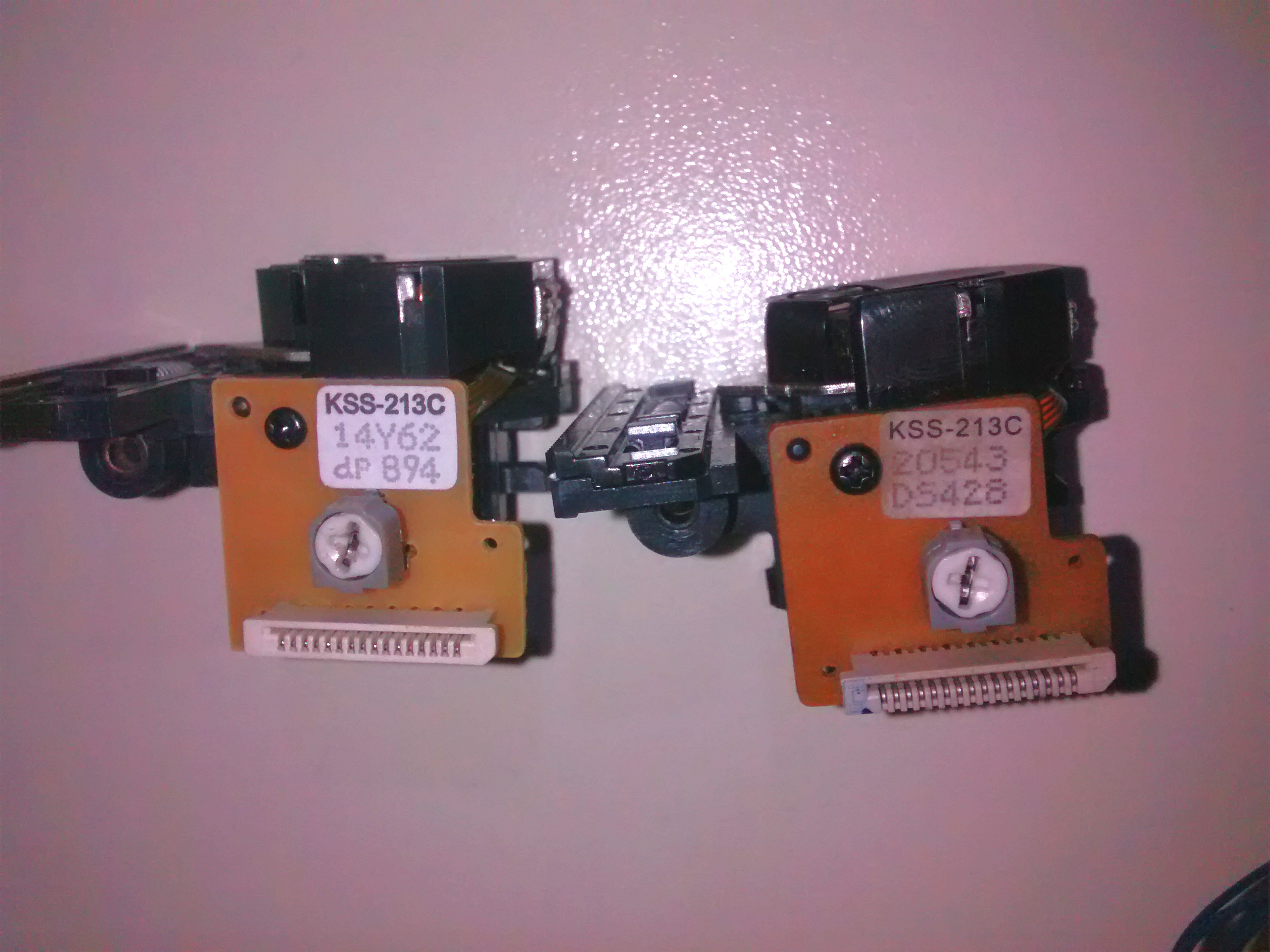

    Hi everyone. Just got my hands on an onkyo c-705tx.
    First does anyone has service manual for this?

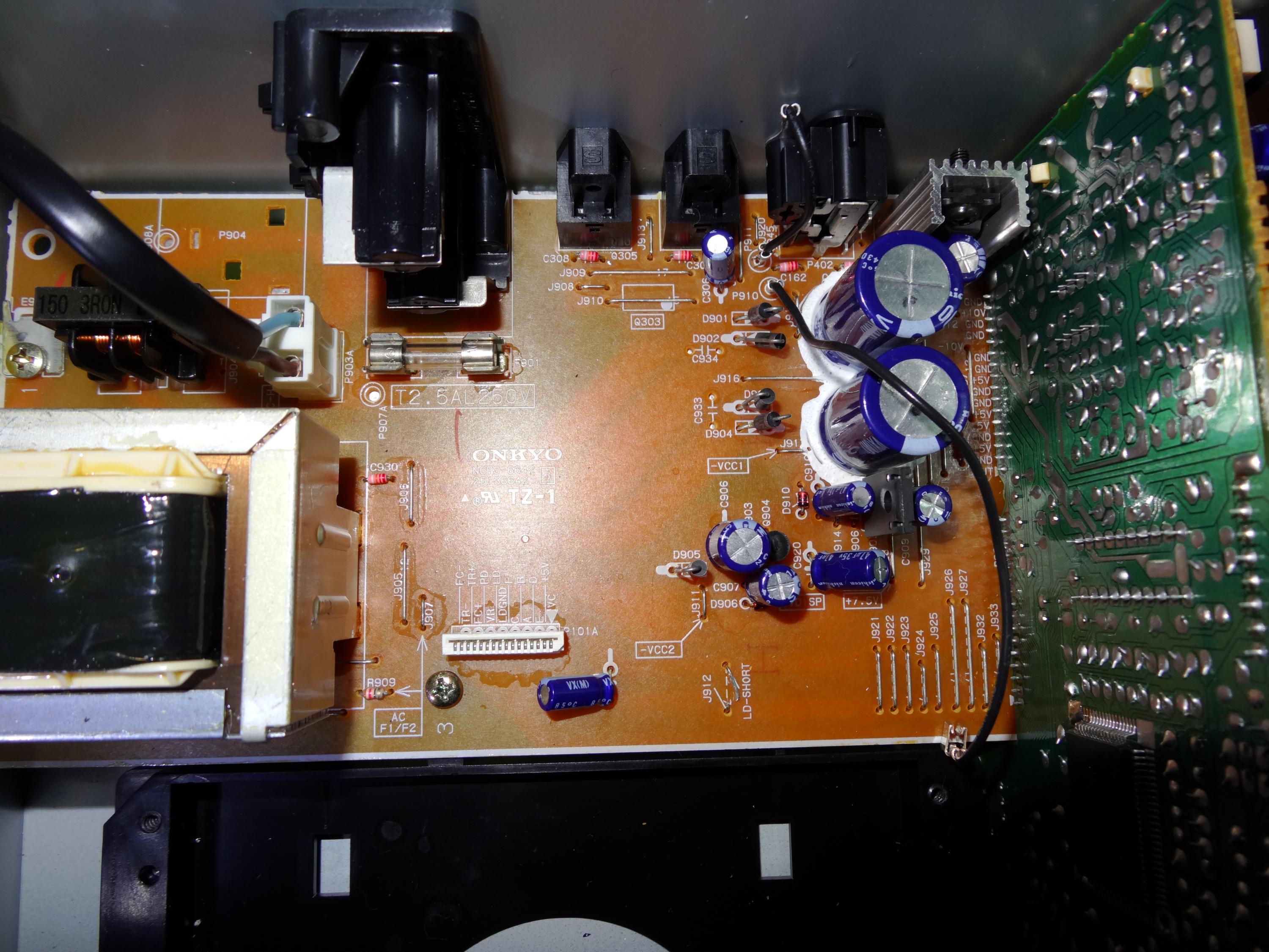

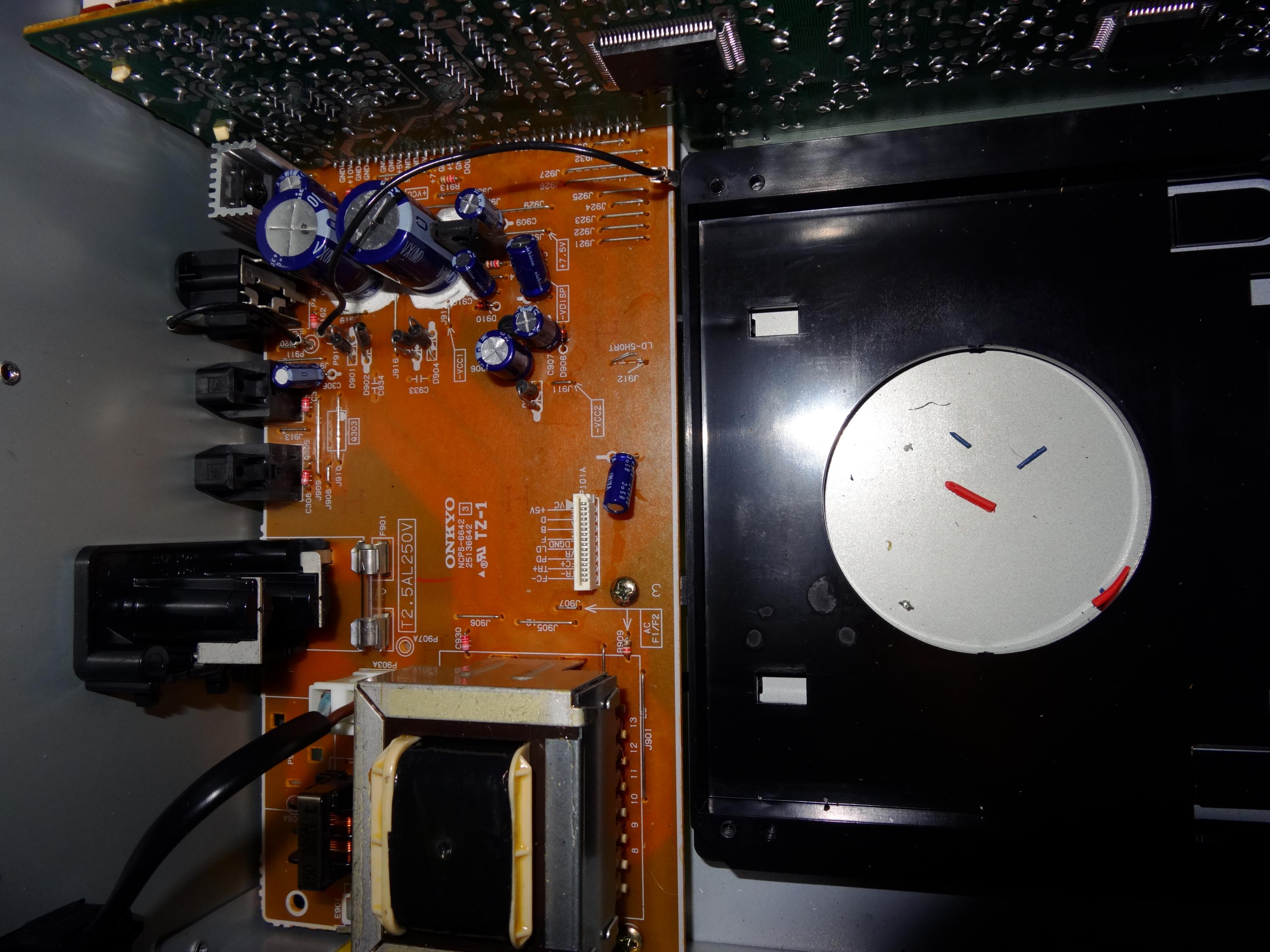

    So I checked the power lines and have few suspicious
    -10.8 ( should be -10 )
    +9.7 ( should be +10 )
    +5
    +7.05 ( should be 7.5 )
    The power caps visually are fine.

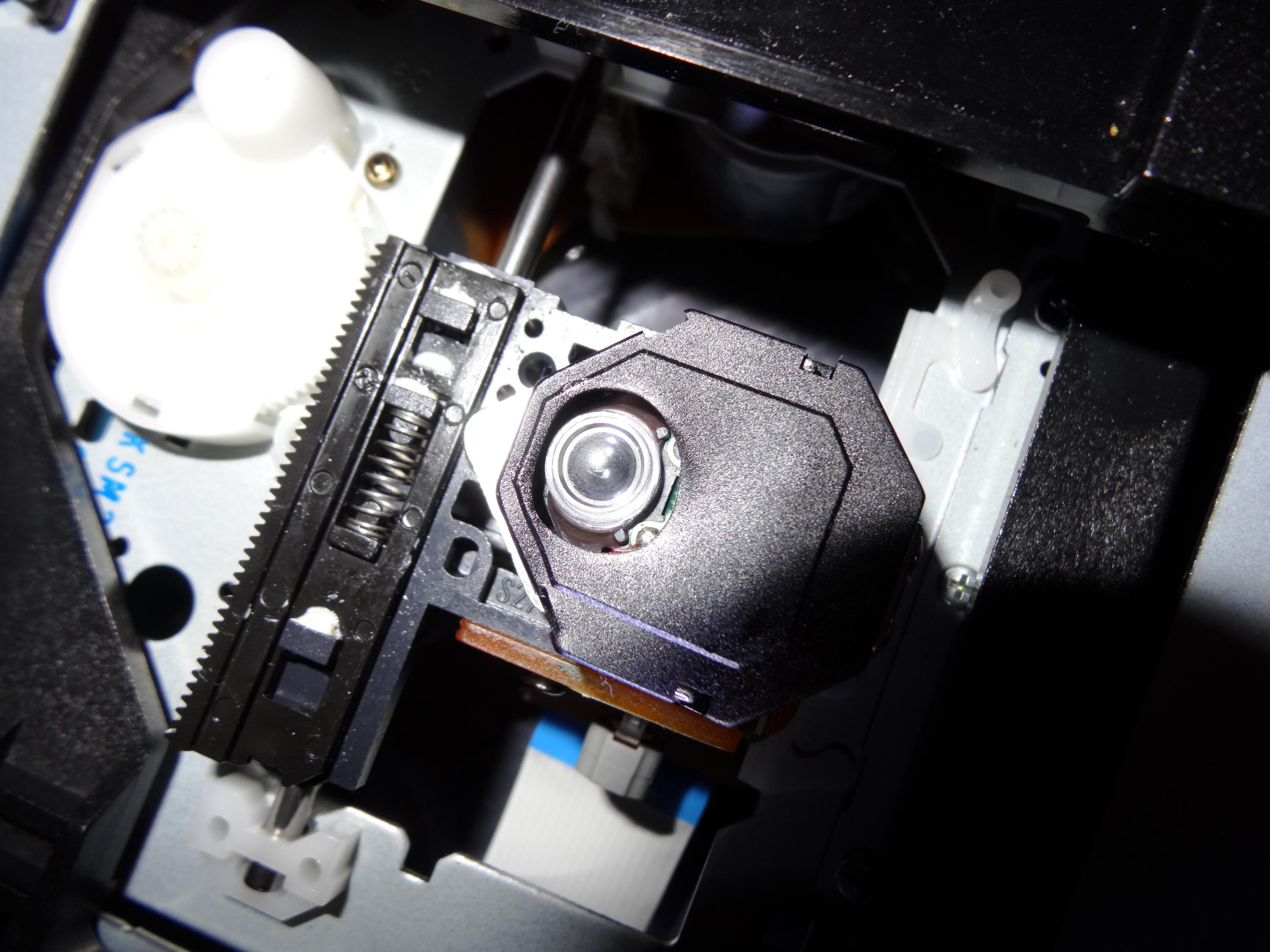

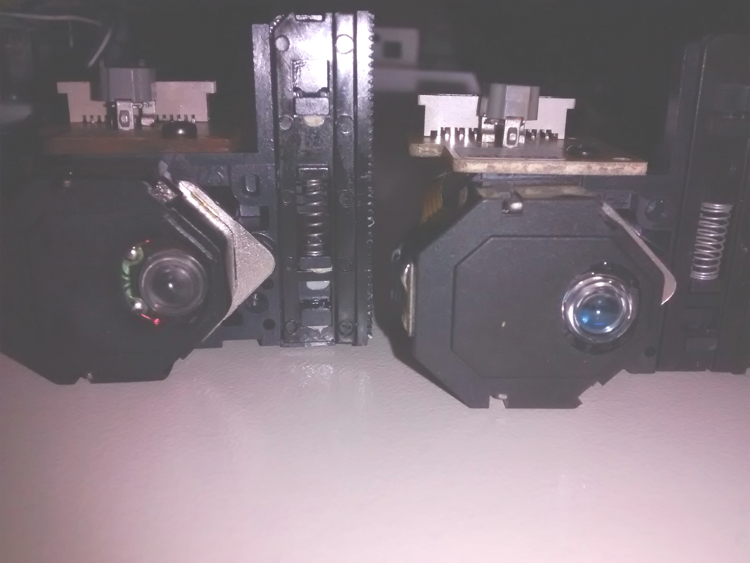

    The lens looks like a little bit blurish to me, but last time I used a cd player was long time ago, so I've forgotten what a good lens looks like ( see image ).
    When a cd is placed in the tray, it will not spin. On empty tray I can see that the laser is working ( on my phone camera, not looking straight at it ).
    The spindle and laser pickup motors both read 11.3 ohms and I can confirm that the laser pickup motor works fine.
    The laser pickup is kss213c. I turned the pot to boost the output, but still the cd does not spin.
    I do not see anything there to detect if there is a cd, so I guess it is the laser pickup job?
    What do you think.. is it only the laser pickup which has failed or there is something else?

            Re: CD player does not spin

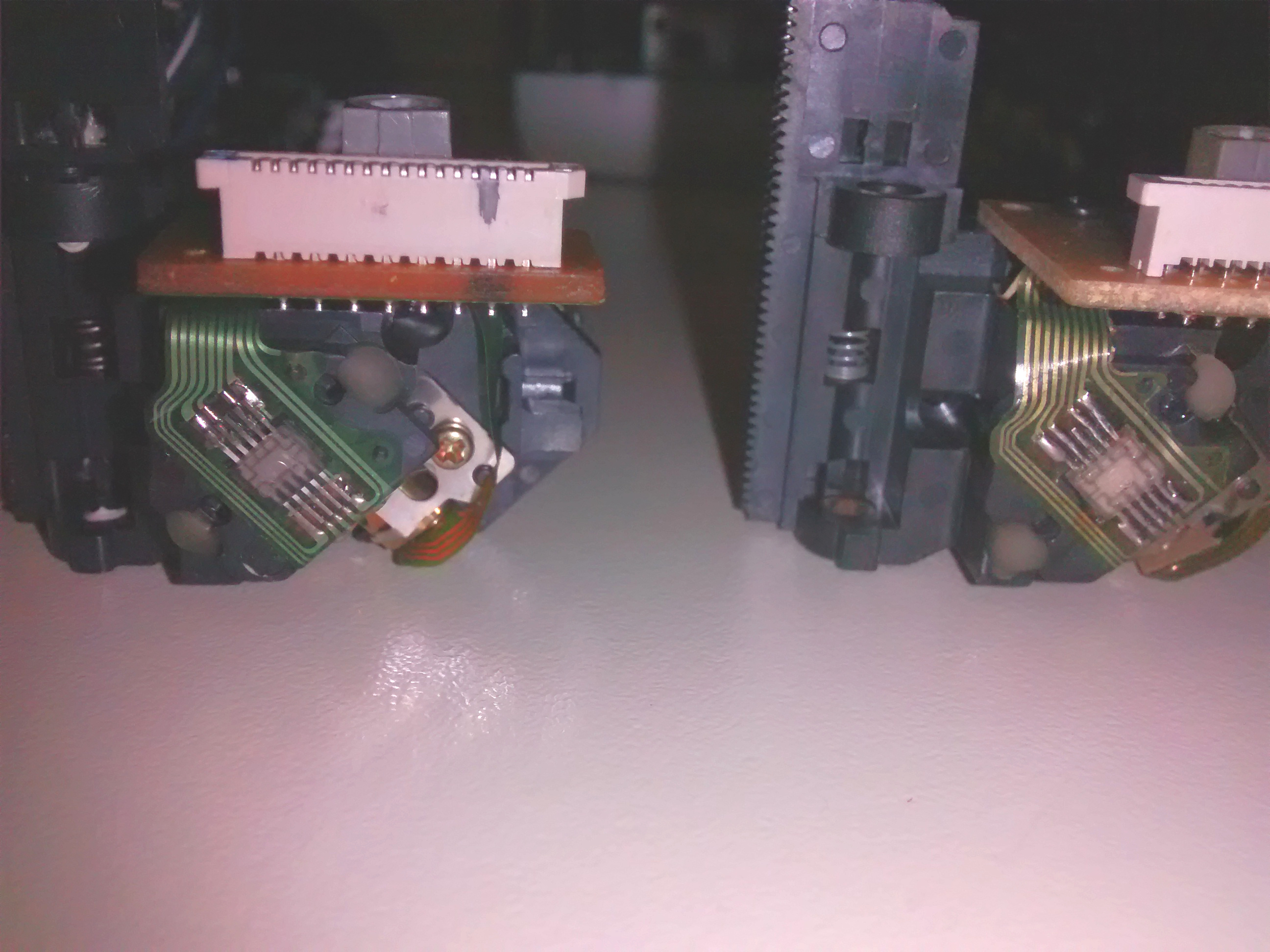

            I just changed the laser pickup with a new one with a nice transparent lens and.... nothing.
            The spindle motor works fine when powered with a single AAA battery, but there is no voltage coming from the main board when the tray is inserted.
            So here is the main question for now - when does the spindle motor start?
            A - when the tray is inserted and before the laser pickup reads the disc
            B - after the laser has recognized the disc
            ( or does the laser pickup need the disc to be spinned to recognize it )
            Basically I need a starting point for troubleshooting - the laser pickup part or the motor part.

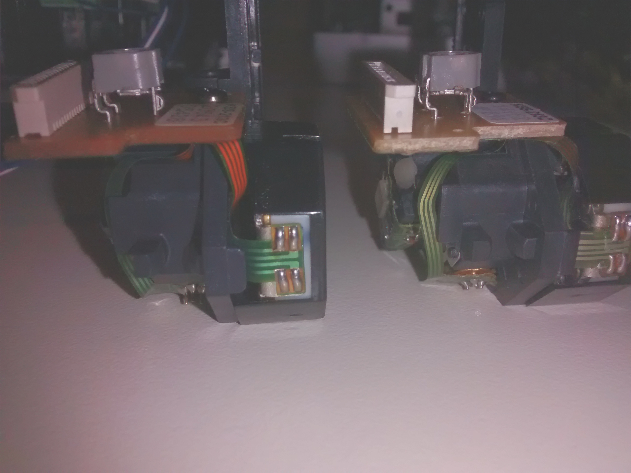

              did you remove solder blob from new laser unit ?
                hmmm no.. where is it?
                That's my first encounter with CD equipment and I'm pretty much blind here
                  new laser units more often than not have a solder blob to short it out for transportation .. look up the laser id number on the internet .
                    I think I found it.. at least there is a solder blob which shortens two of the pins on the new unit and is missing on the old one.
                    Well.. just turned on the solder iron, is I guess in 5 minutes I will have more information .
                    In the part shop I asked about plug-n-play laser pickup and they did not mention anything about that.
                    • madan1
                      • Nov 2016
                      • 682
                      • Bulgaria
                      Aaand there we go
                      I removed the blob and now it seems to be working ( I have not tested the sound output yet ).
                      petehall347 thanks for the tip
                      Indeed I got the unit without the box ( the only one left ) and I guess on the box were the instructions.
                      Thanks everyone!

                                No wonder it didn't go before, that original lens was ruined. I've seen worse, but that one was definitely bad.
                                https://www.repairfaq.org/sam/cdfaq.htm may help. Lots of info there on adjustment and getting the right laser setting.
                                That said, if it was brand new and of high quality (you didn't buy some cheap knockoff or second-hand one from Aliexpress, did you?) then maybe there is a fault in the drive circuitry or power supply instead.
                                  I guess there has been some kind of a chemical reaction which caused the lens to blur this way.. at least this is what I've seen to happen to plastics affected by certain alcohols.
