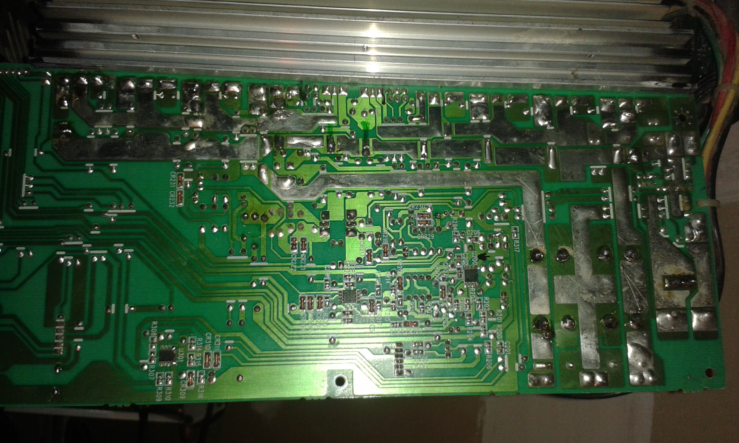

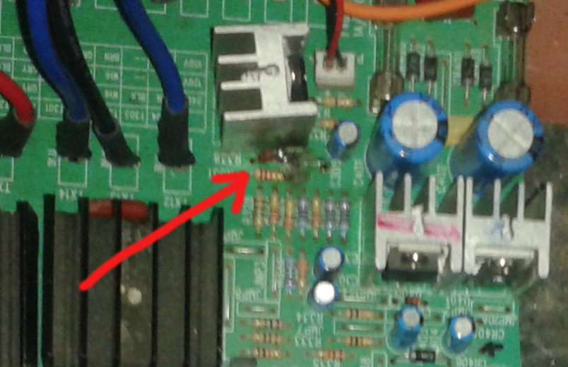

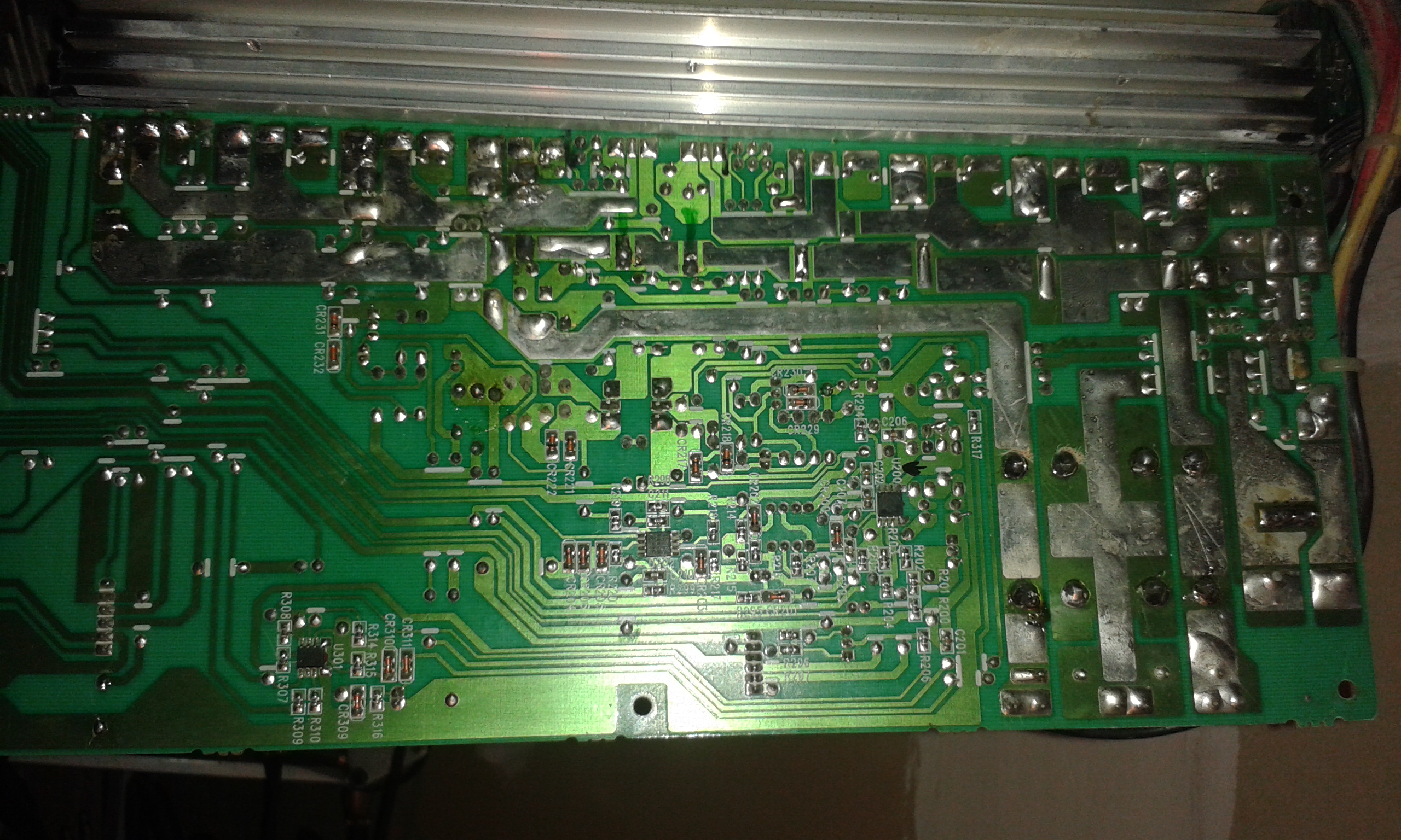

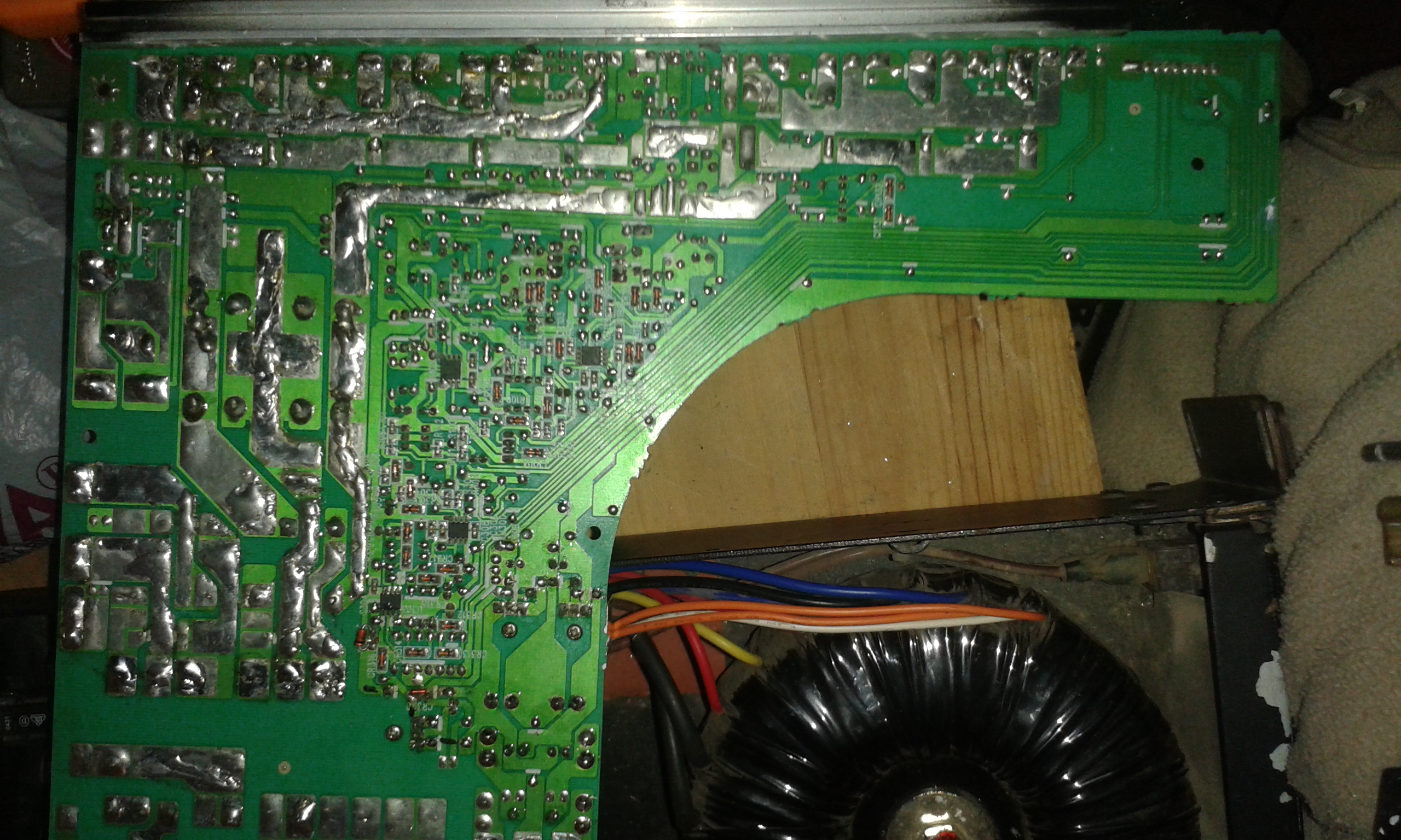

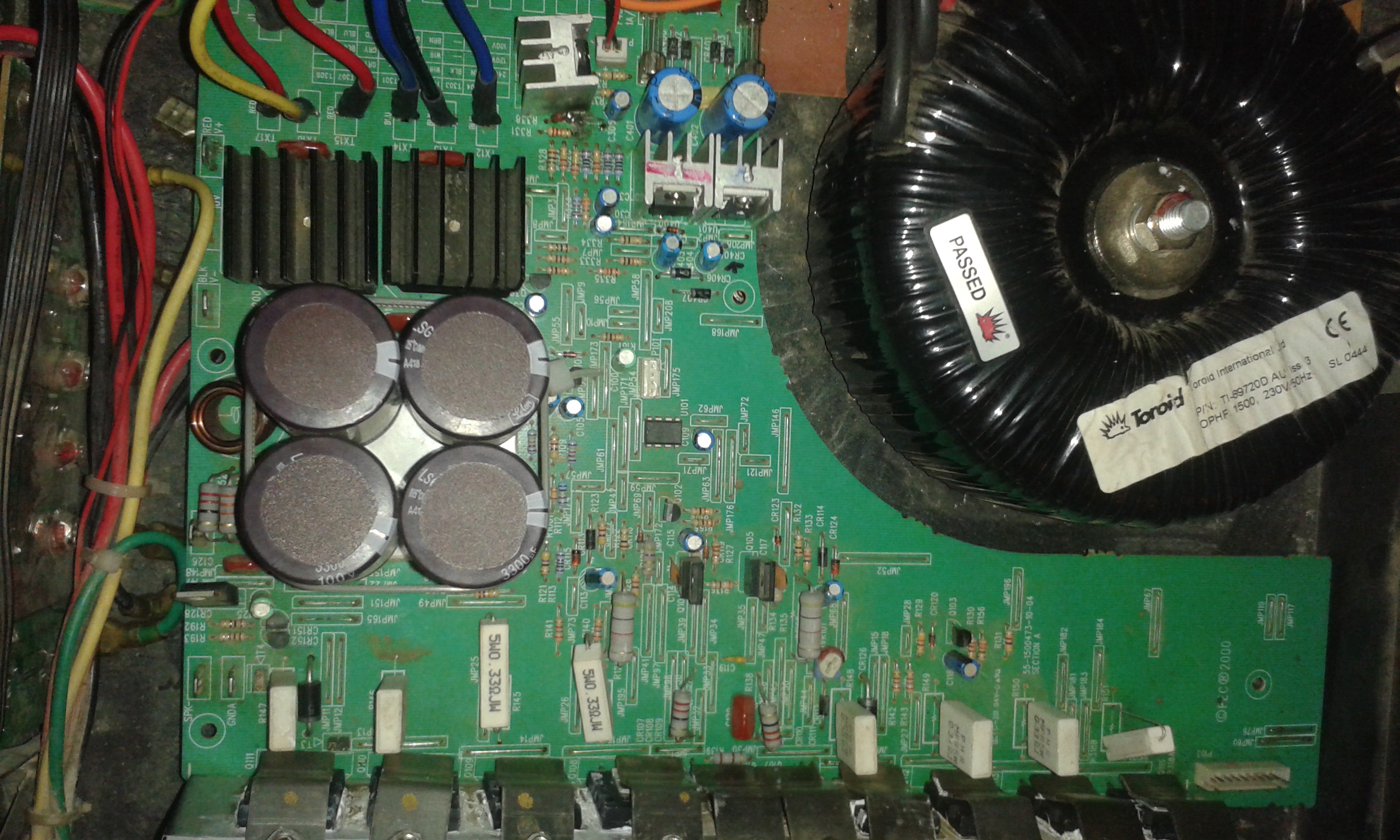

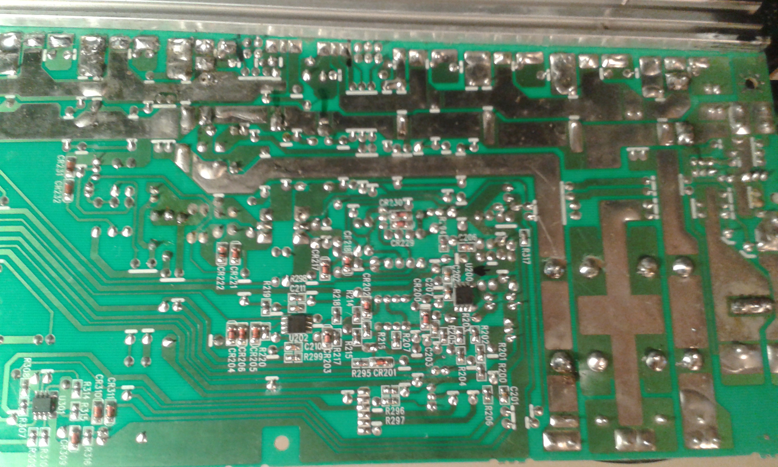

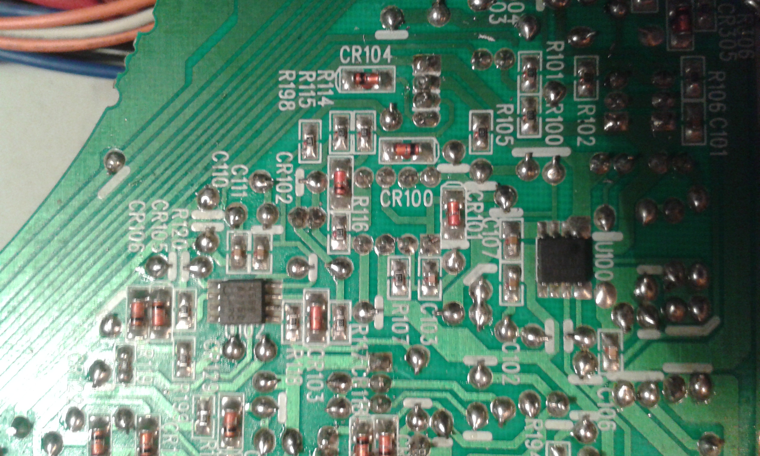

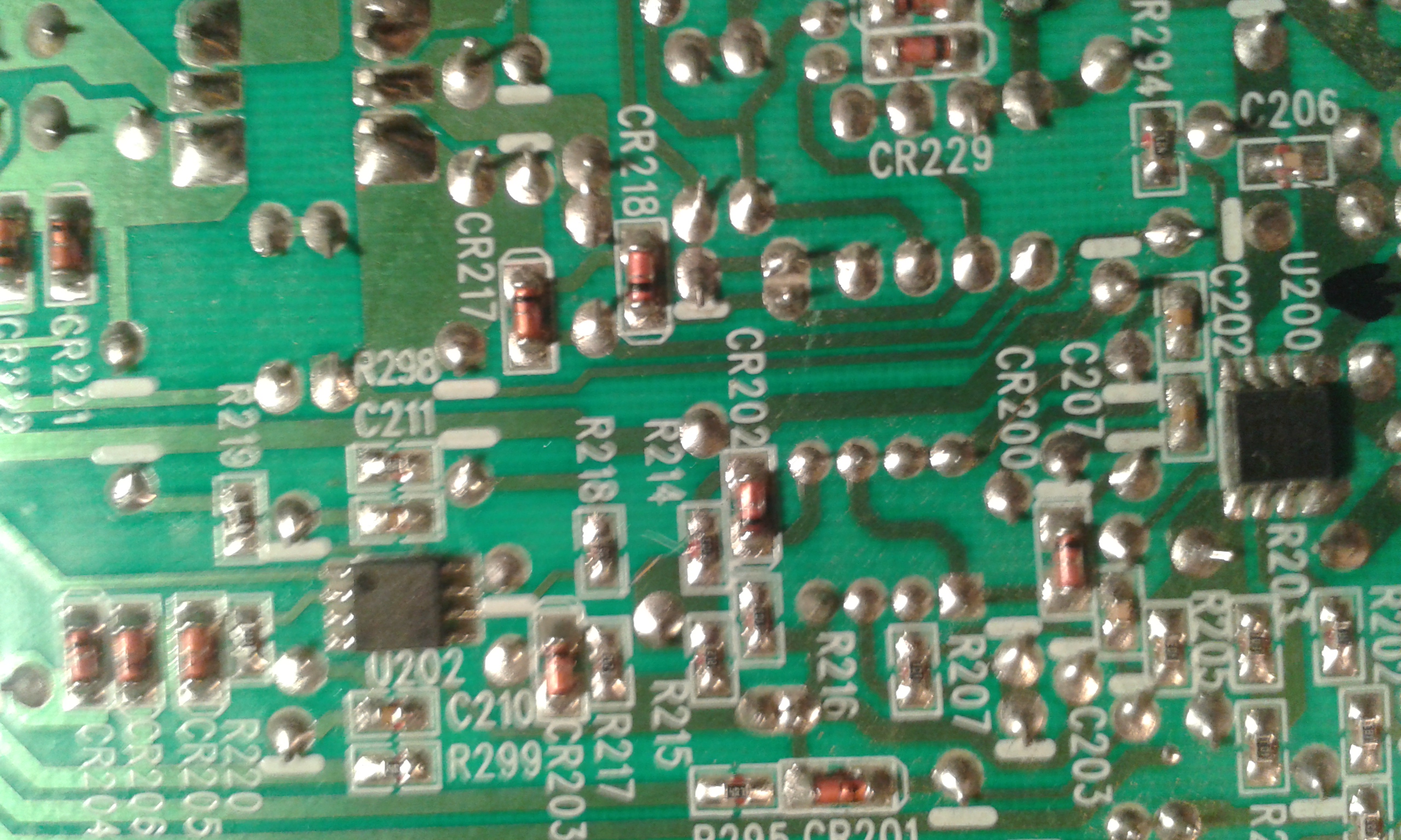

took the crowbars out, plugged in and I still have short :S gonna check all diodes I can take out of circuit because many are zeners and are smd mounted.
I did check a load of them but in circuit, and quite a few gave me readings backwards, but I didn't take much notice because it was in circuit, and none were shorted.
I also noticed that on u200 I have 31.4ohms between vcc pins both ways...
