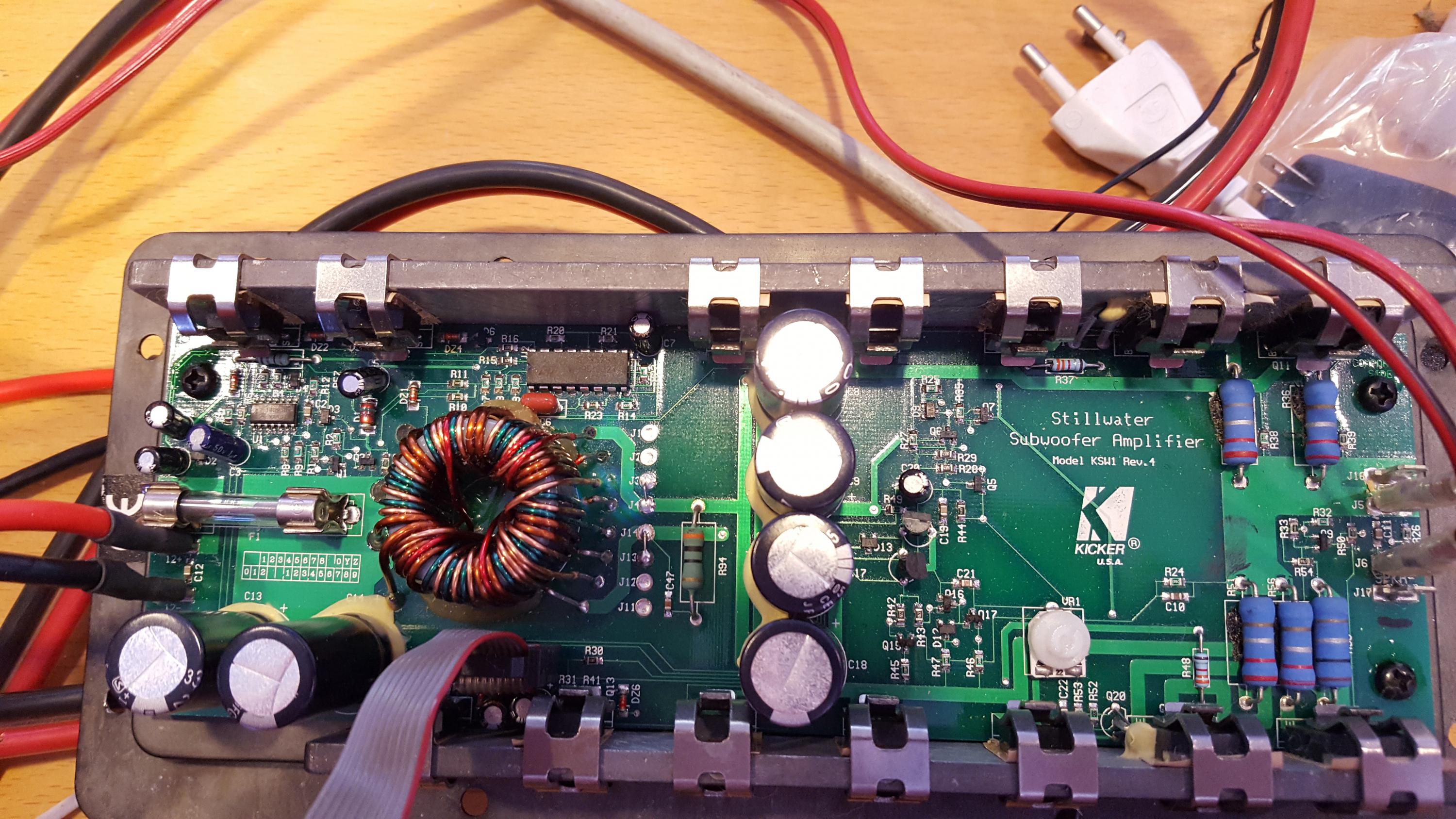

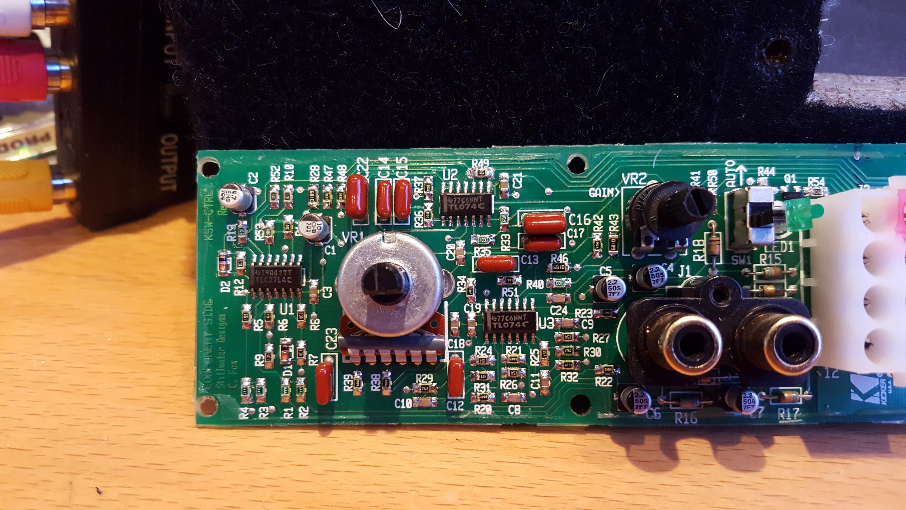

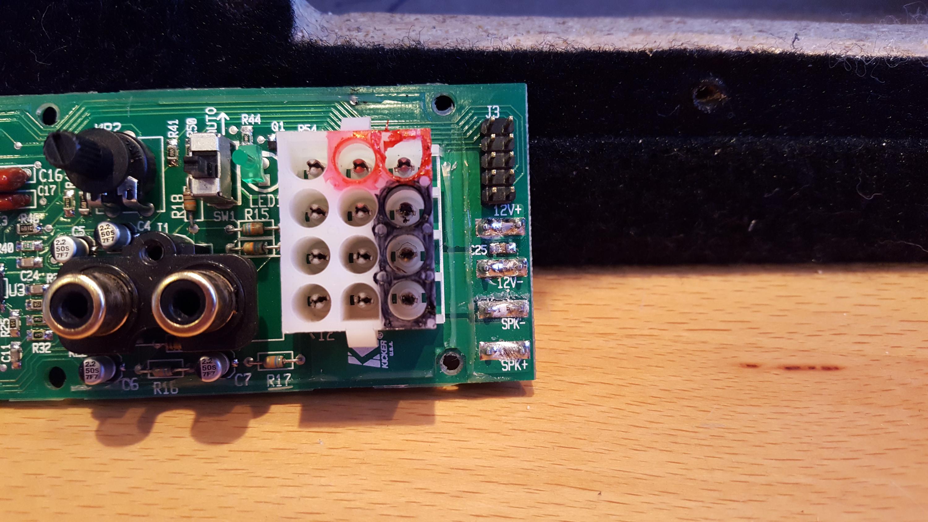

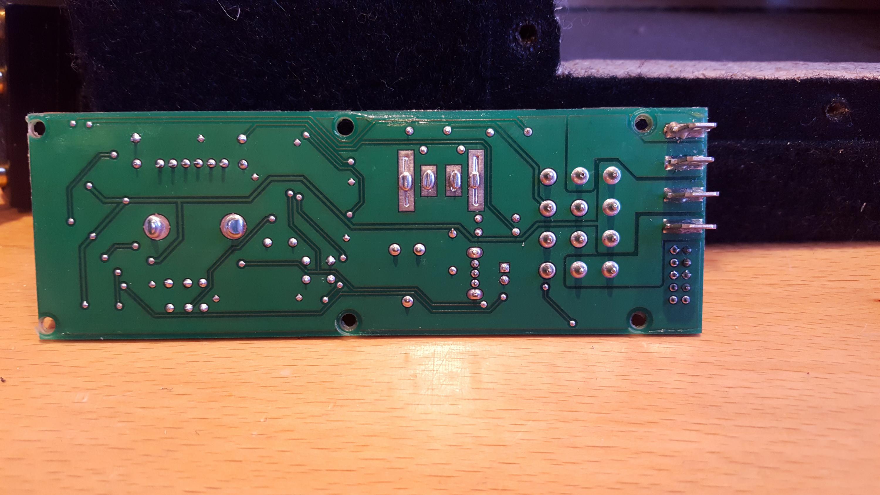

    Morning all.
    I have a Kicker PS80 subwoofer enclosure that does not turn on, the led
    does not turn on.
    I've tried googling the schematic/service manual but I have not found a single one.
    So I was wondering if any one here would be willing to identify the problem with me?
    I have some pictures of the PCB's, just hope they are good enough.

    Re: Kicker PS80 subwoofer enclosure
    Silly question perhaps, but is the fuse ok?
    Then, is the PWM chip (the SG3525?) properly powered?
    https://cdn.badcaps-static.com/pdfs/...c49d47f310.pdf (pin 15 is the supply pin, pin 12 is ground)
    Is any voltage present on the secondary? What about on the +/-12 terminals on the smaller board (obviously with the cables hooked up)?
      Yub the fuse was ok, I measured 0.90v on the SG3525A replaced it and now it works!
      Thank you very much for the help
