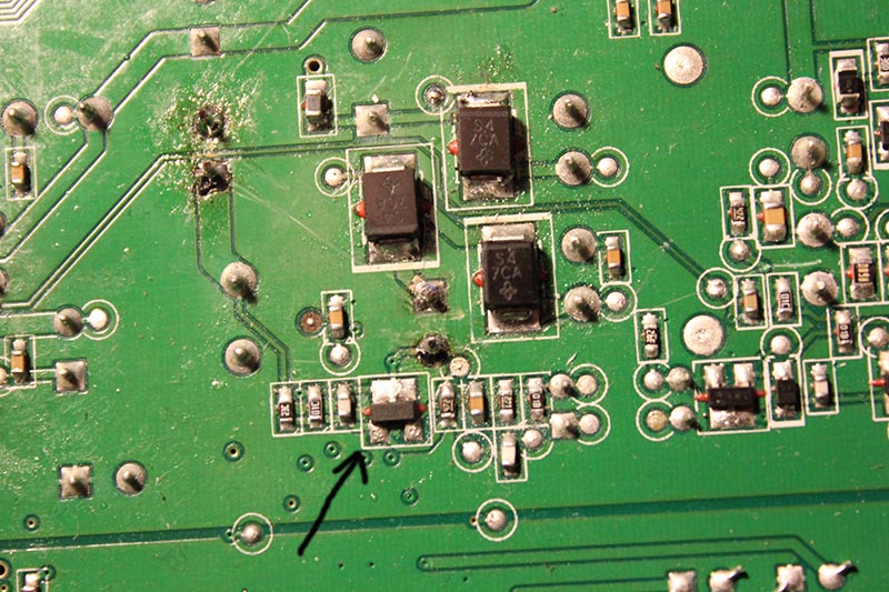

            Re: TC Electronic Studio Konnekt 48 revival
            I've removed and tested this smd element tagged in attach, which is directly connected to C489. It's marked with code RL A, but I didn't found anything abot it on google.. I suppose it's voltage regulator or something similar.
            Diode test; in one direction 0.64v and 0.61v, and in other OL and 0.8v, so that's not good... am I right?

              #66
              That's connected to the GROUND leg of C489 (since the + of the cap is definitely connected to the band-end of that rectifier diode ). And with all those resistors and caps next to it, it's a safe bet it's actually the TL431 (or variant) that's part of the feedback - D74 on the schematic.
