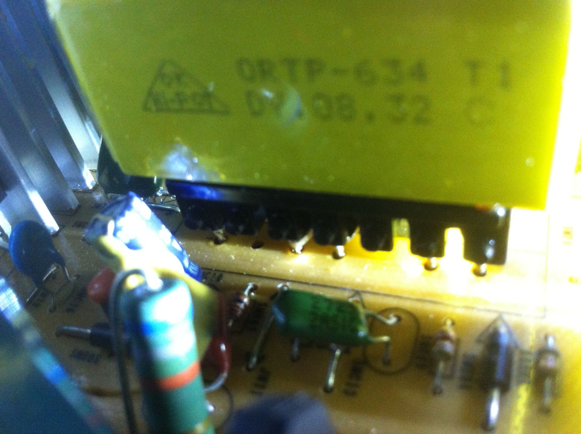

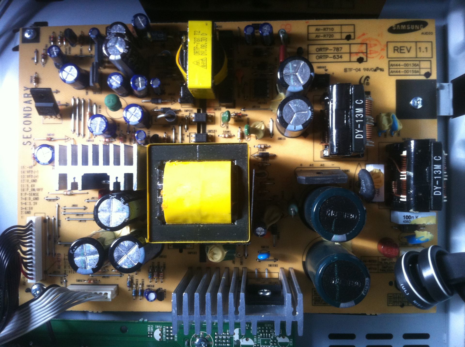

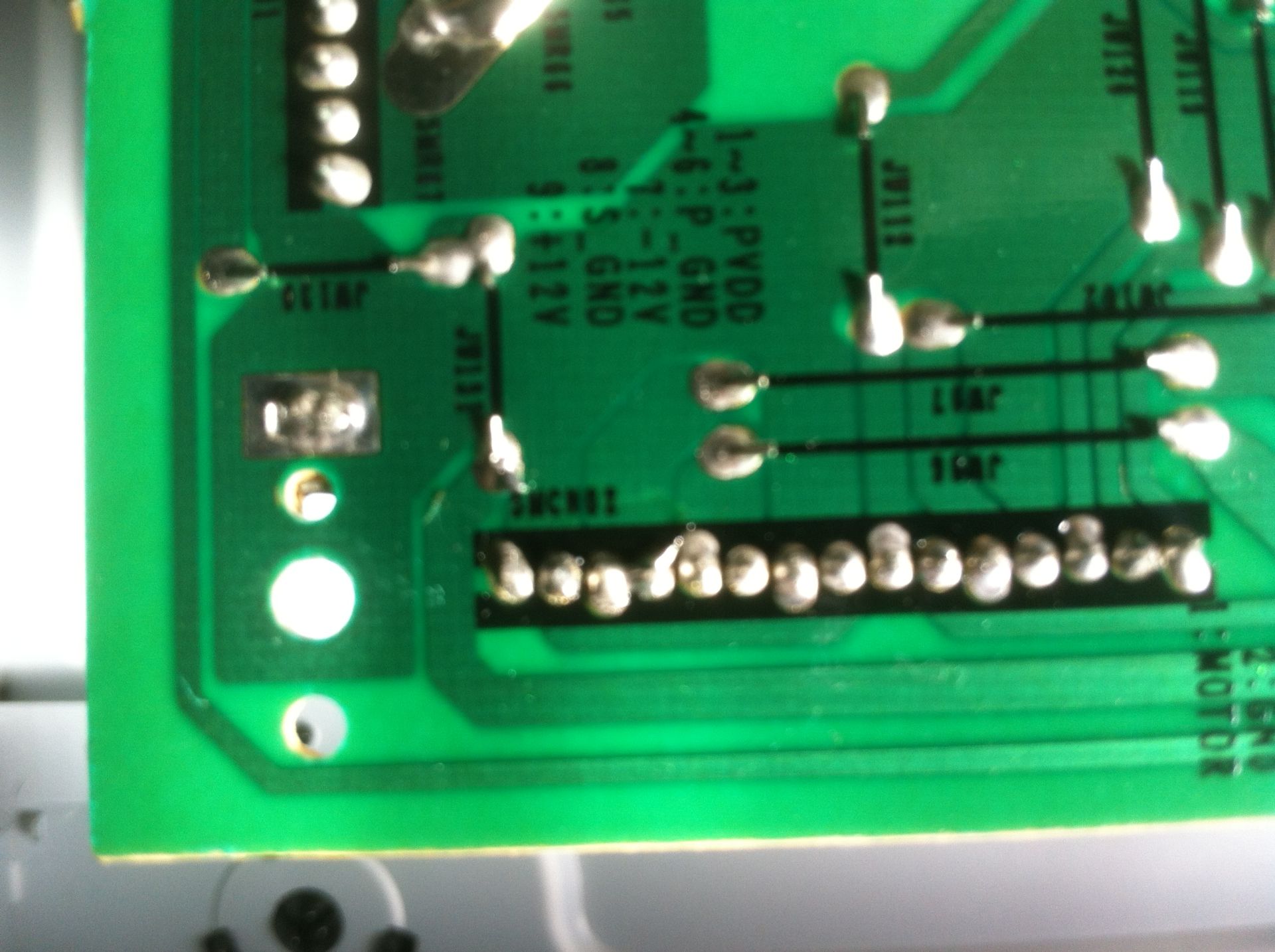

I have a Samsung av-r720 that will not turn on properly.
It has stand by power when connected to power, but when I push the power button, I hear a crackling/buzzing noise, or possibly a short in the high voltage transformer, the power light goes blue, but I have no display.
I think the big transformer in the middle of the first picture is the problem.
These are the voltages of the white plug on the left side, plugged in, in standby mode...

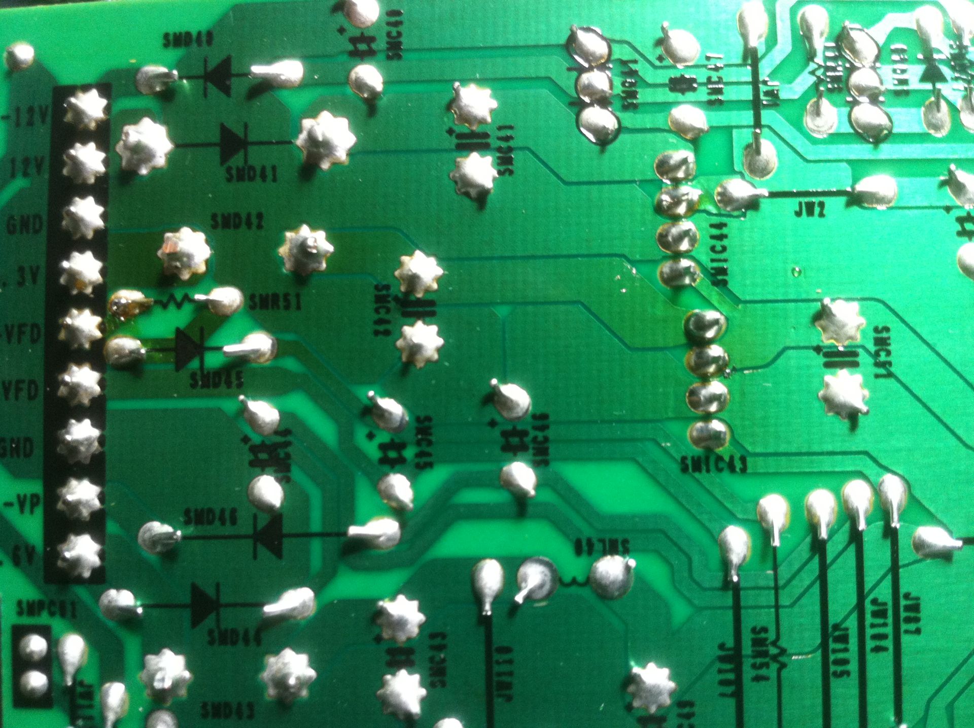

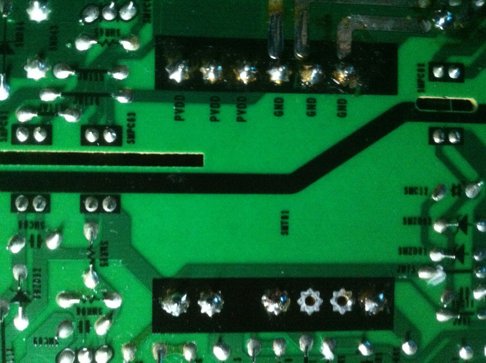

The third photo looks like some sort of discoloration on the board.
SMR51 looks like possibly a repair. The solder repair on the left side doesn't look right to me.

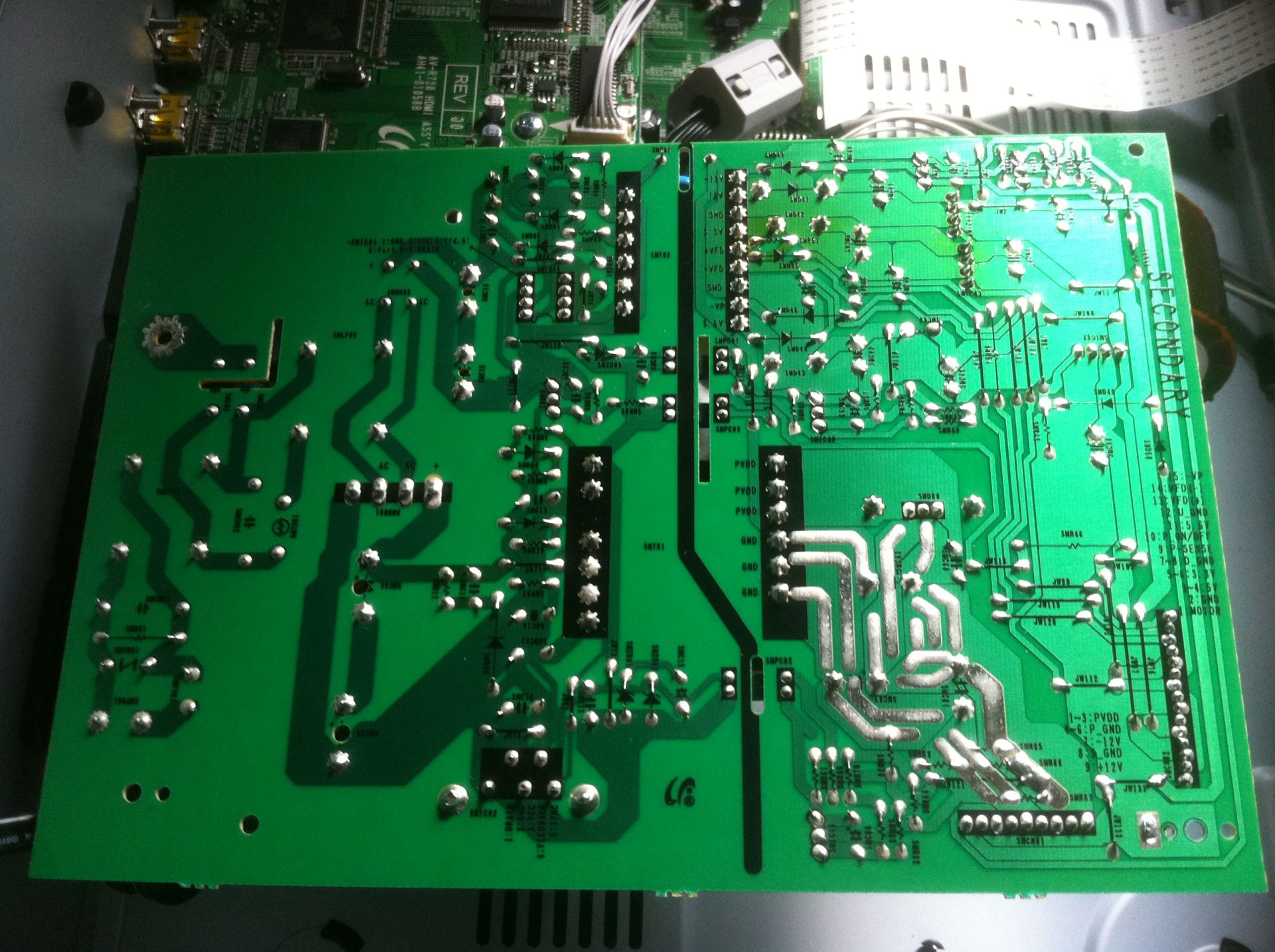

The last photo looks like another bad solder job on pins 4-5, going from left to right.
I know the voltages are not right but I'm not sure if it's the high voltage transformer.
Any help would be greatly appreciated.
Thanks.
