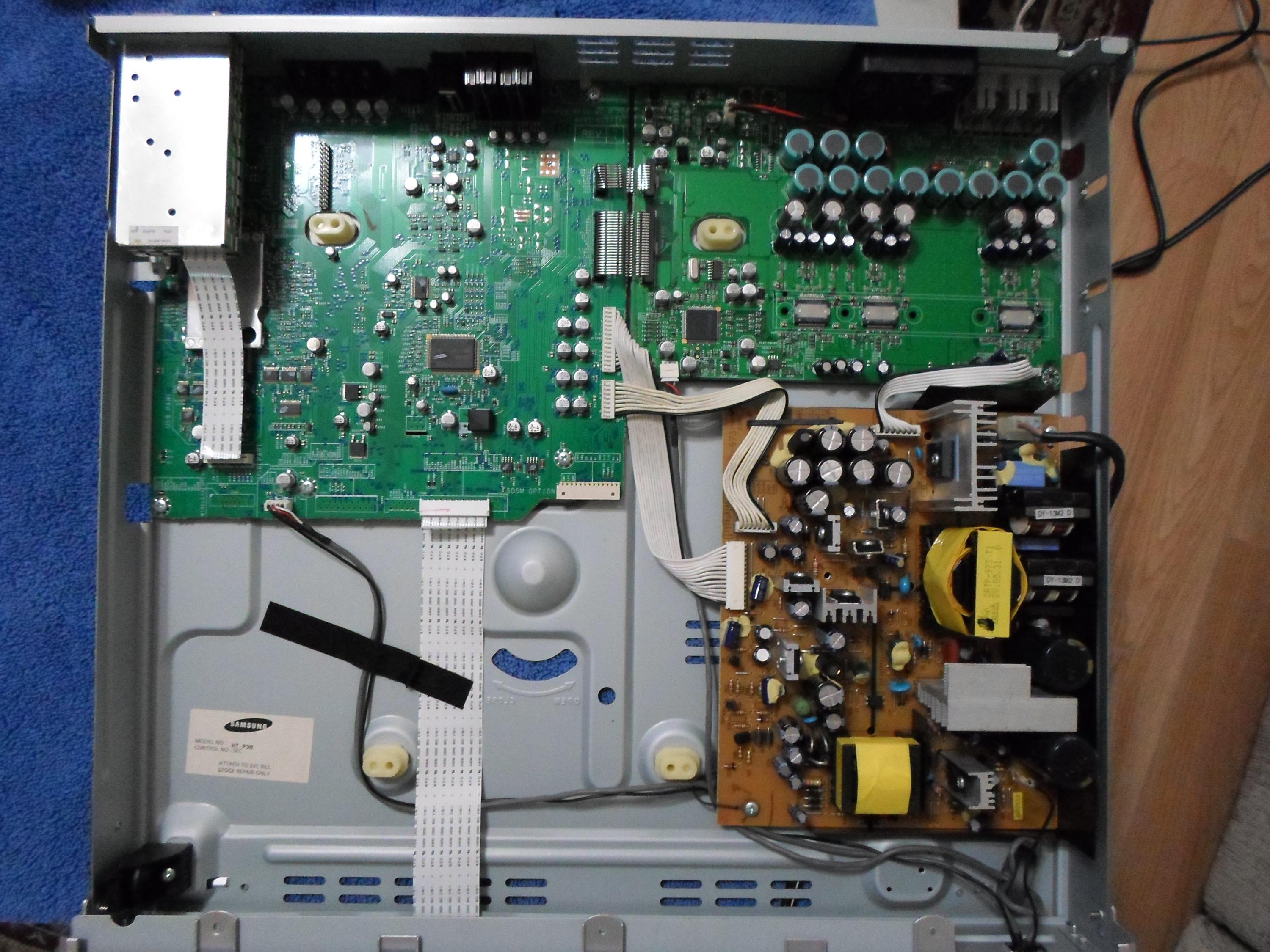

    Im trying to fix this for a friend. The unit powers on, and a few seconds later displays "Protection" and shuts down. All the caps on the PS look good. I focused some attention on the audio amp board. If I remove the large black connector on the left, the unit remains on.

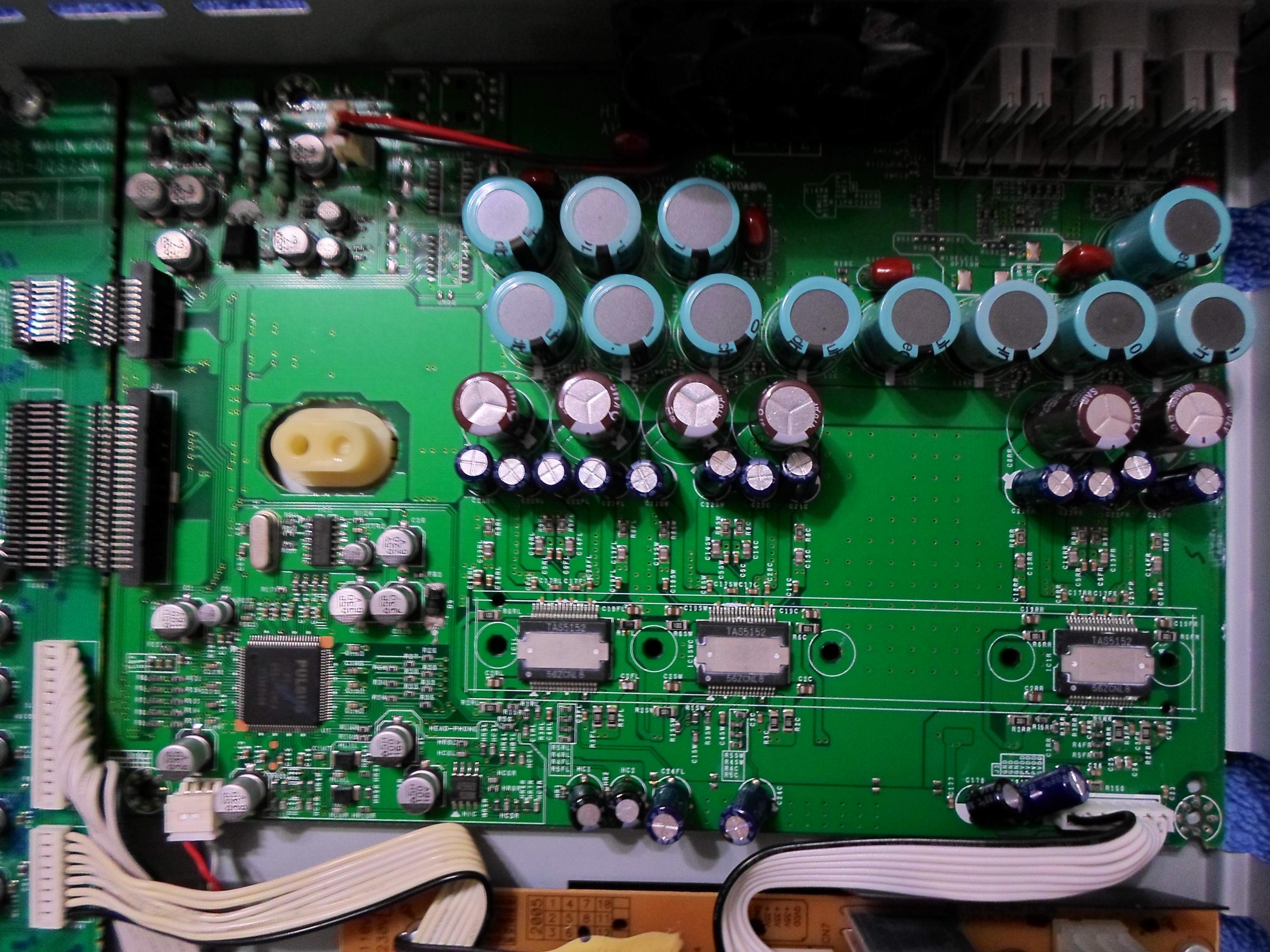

    The audio board has 3 TAS5152 amp IC's. Wondering if they are a common failure.
    Any help appreciated!

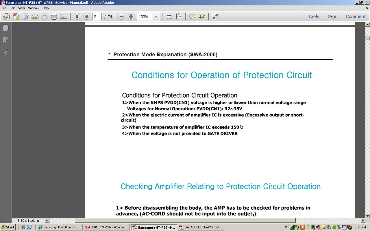

    For what it's worth, i've managed to find the service manual HERE.

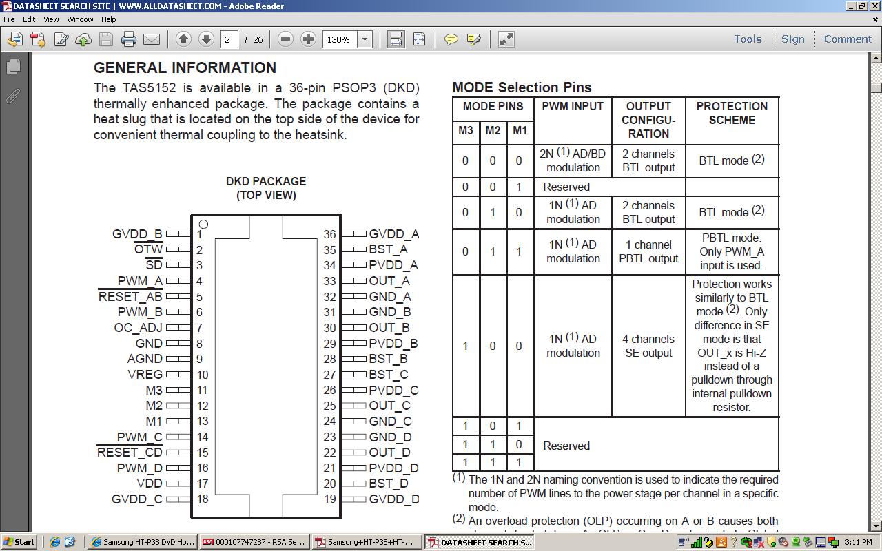

    The datasheet for that square chip (PWM modulator) is HERE. I notice it has an "Overload" input pin - might be worth probing that one, for starters, during power-up. Or actually, scratch that, it's not connected to anything on the board, it seems.
    On pages 4-5 in the service manual, there seems to be a list of issues that trigger the "Protect" mode - run through those and see if any / which one of those is the culprit

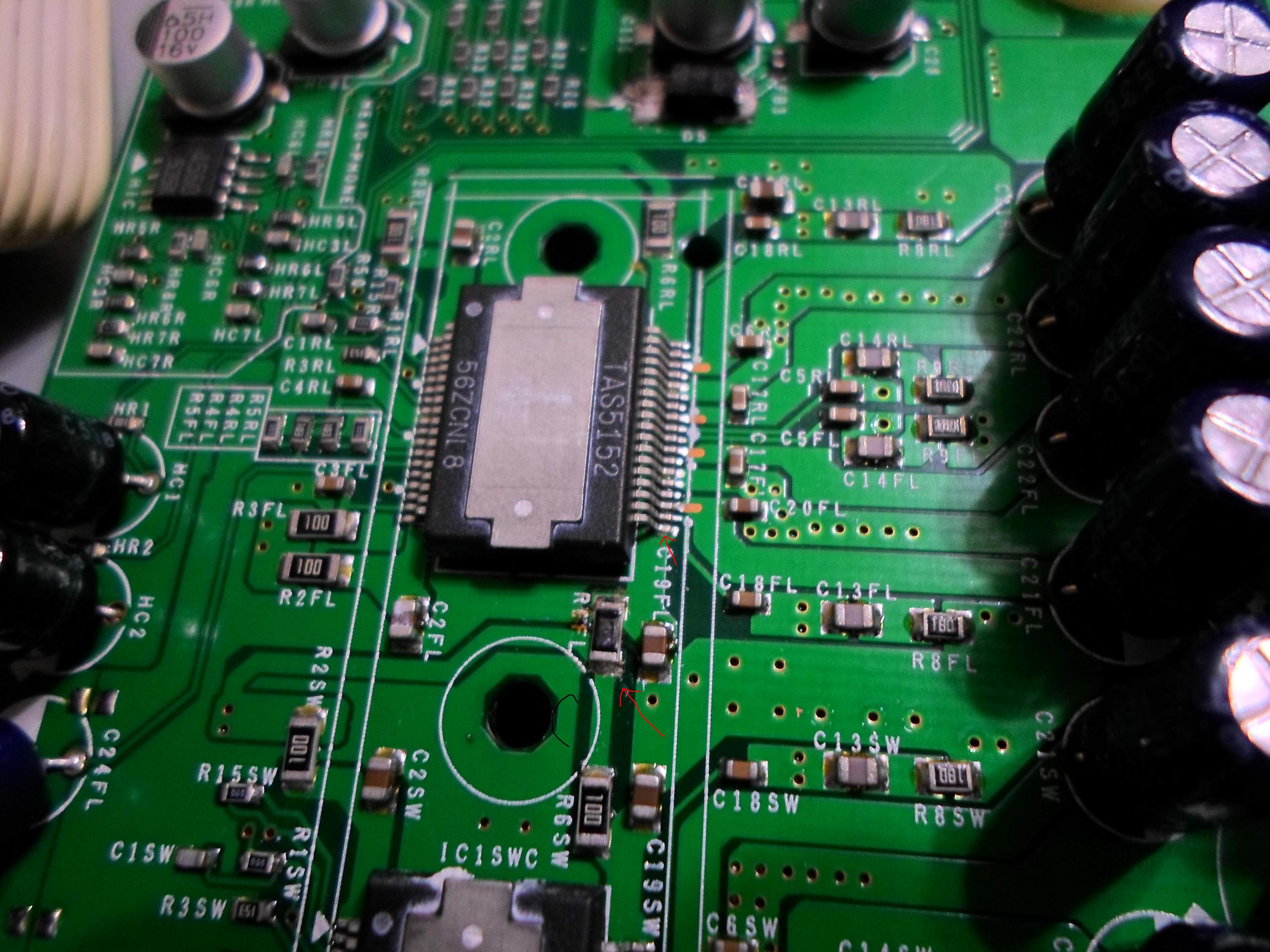

      Thanks for the S/M.. I think I found the problem. I was just about to order new AMP IC's but in the service manual, one of the reasons for going into protection is voltage not provided to gate driver.
      On each IC there are 4 and I noticed I was missing the 12v+ on Pin 19 of the left channel IC. Then I noticed the melted 10 ohm resistor right next to it.
      Hopefully it's just that and the IC's are good. Will let you know!

        At least according to the TAS5152 datasheet, the chips *should* be fine:
        Powering Up
        The TAS5152 does not require a power-up sequence. The
        outputs of the H−bridges remain in a high-impedance state
        until the gate-drive supply voltage (GVDD_X) and VDD
        voltage are above the undervoltage protection (UVP)
        voltage threshold (see the Electrical Characteristics
        section of this data sheet). Although not specifically
        required, it is recommended to hold RESET_AB and
        RESET_CD in a low state while powering up the device.
        This allows an internal circuit to charge the external
        bootstrap capacitors by enabling a weak pulldown of the
        half-bridge output.
        ... But then again, it would be interesting to know how and why that resistor melted...

          Well it looks like that IC next to resistor may be bad. When I replaced resistor the 12v was being loaded down to around 4v. Without that resistor in place the 12v is present on all other pins. Does that make sense?
          • kevinm34232
            • May 2012
            • 1884
            Re: Samsung HT-P38 DVD Home Theater System
            I removed that IC and still had same loading issue, so I removed that cap next to the bad resistor and I think it was broken. Then the voltages came back up without it in circuit. So I think I will end up replacing the IC, cap and resistor and see what happens.
            Does it make sense that cap would fail too with whatever happened?
