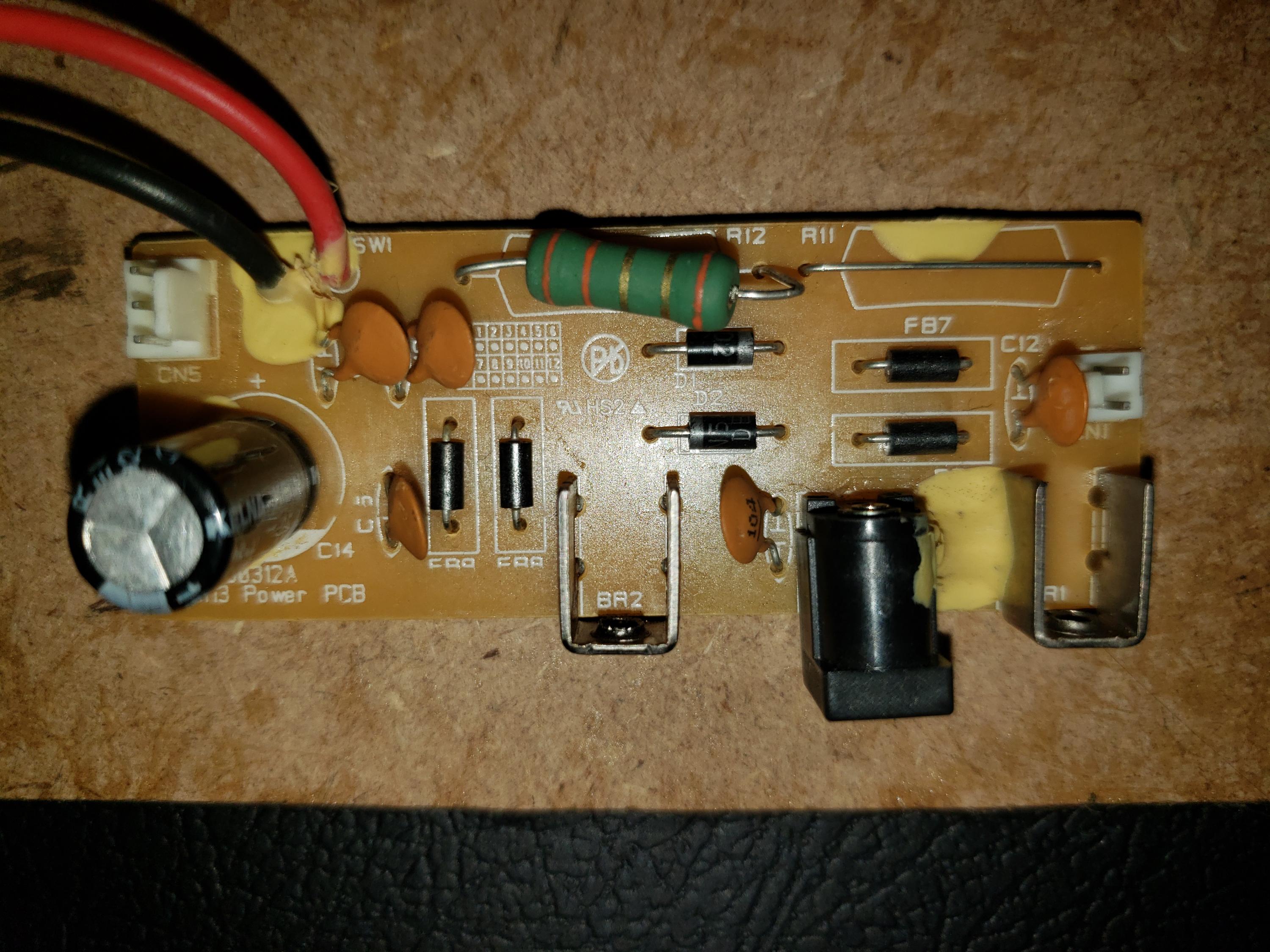

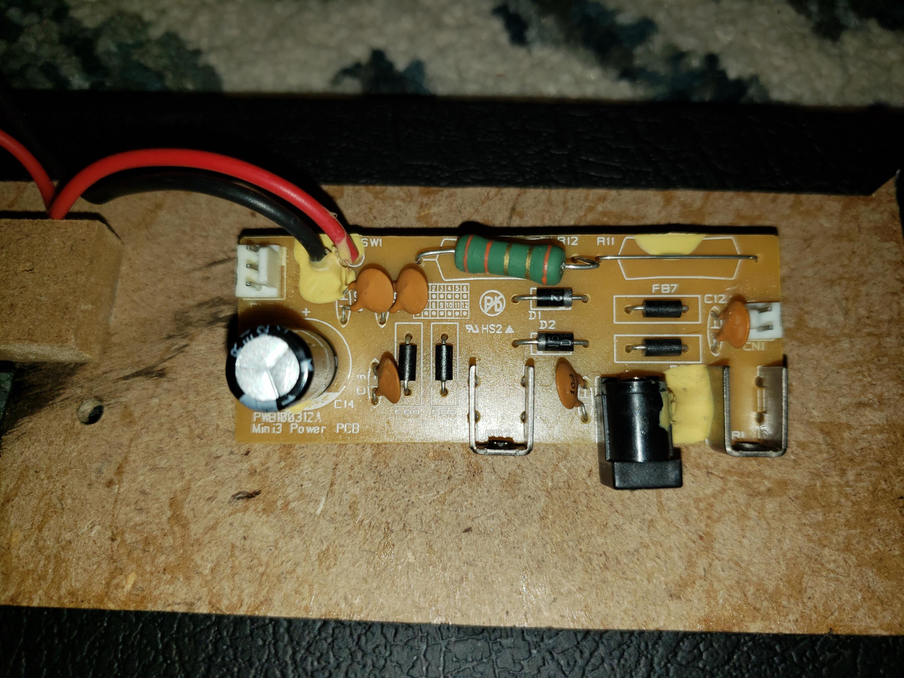

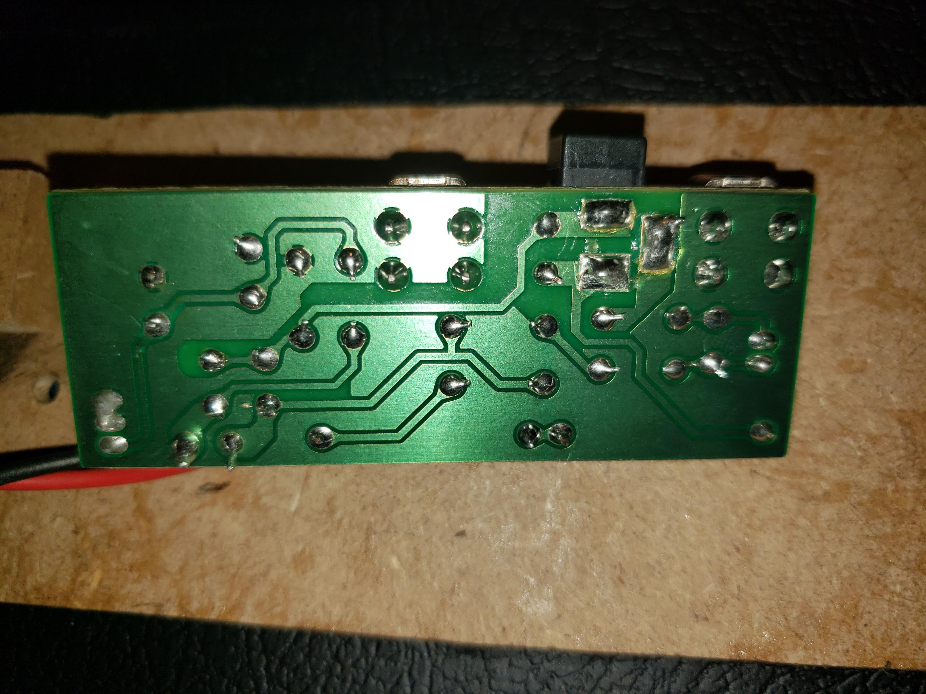

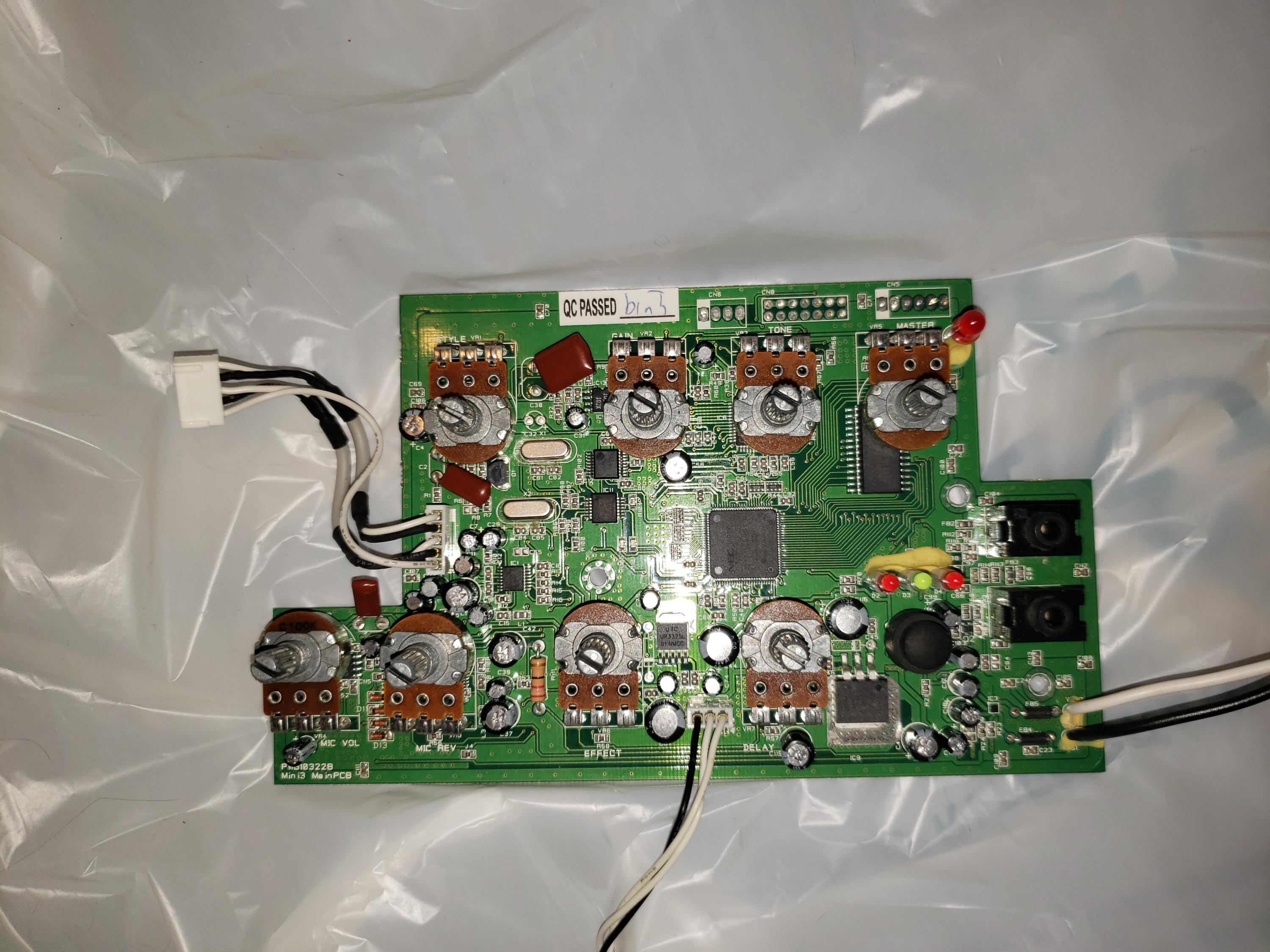

    Thank you for the reply.
    I have attached top and bottom pics of the small board. Also attached a pic of the main board as well.
    Thanks again

      Re: Vox mini 3 amp
      Have you checked the resistor is ok? The only other thing would be the diodes.
