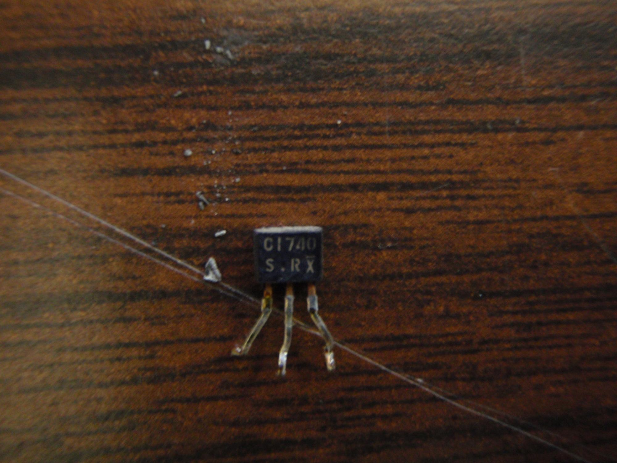

    Hi everybody, I have an Onkyo TX-SV535 Receiver with 2 blown output transistors - 1 Toshiba D2386 and 1 Toshiba B1557, which I can't seem to find. well i found the b1557 on ebay for $14 shipped which seems high.... Are there suitable replacements out there? Also one of these little guys in the picture was toasted, what is it? Thanks!!

    2SC1740 - GP (general purpose) transistor, NPN - http://www.suburban-electronics.com/...SC1740/2SC1740
    2SB1557 - http://www.suburban-electronics.com/...SB1557/2SB1557
    2SD2386 - http://www.suburban-electronics.com/...SD2386/2SD2386
    Toast
    ** Not an endorsement of this supplier. Just what Google popped up. Others exist.

      Dang thanks Toasty!! I guess I need not search for "Toshiba" eh.....
