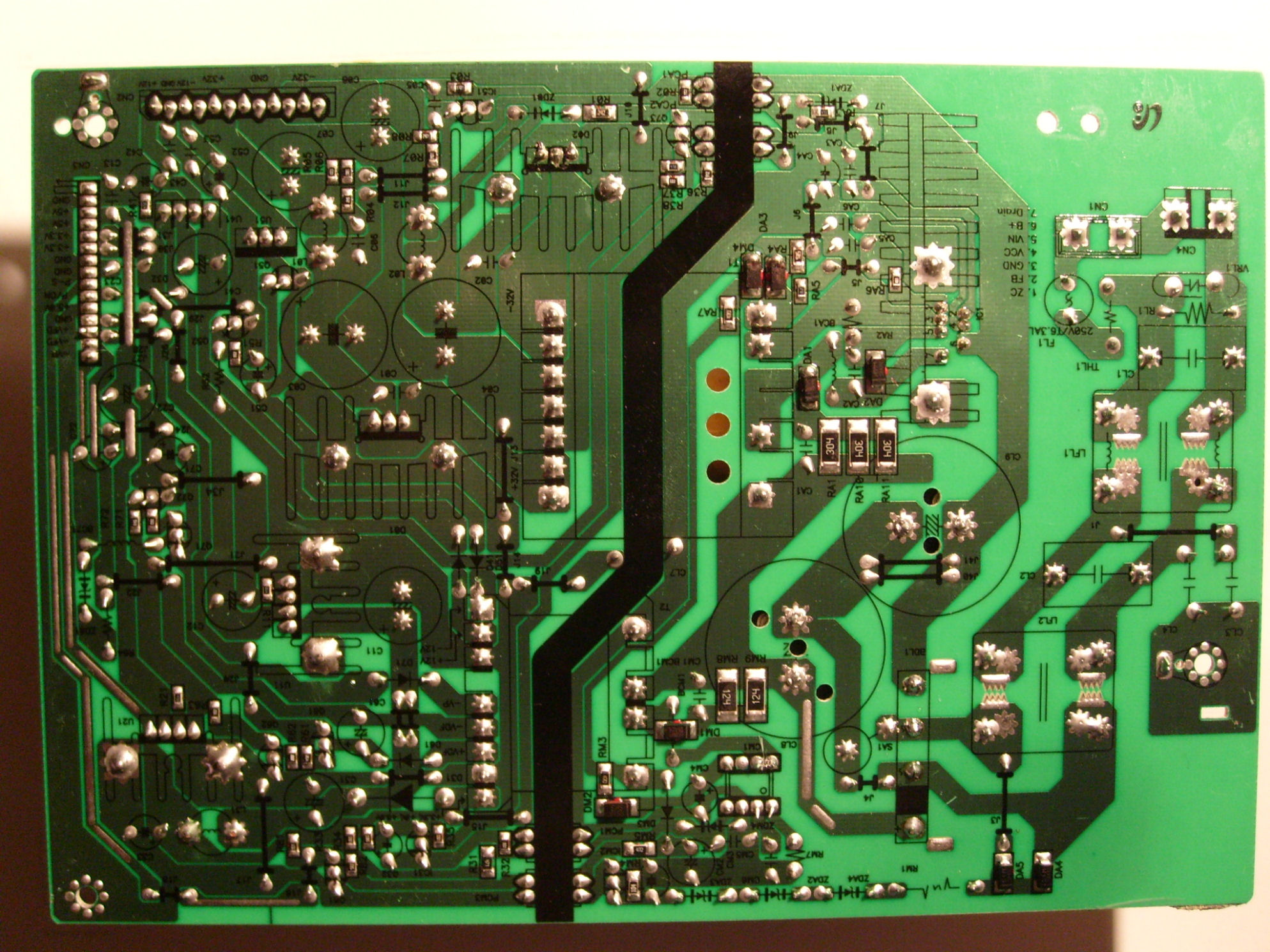

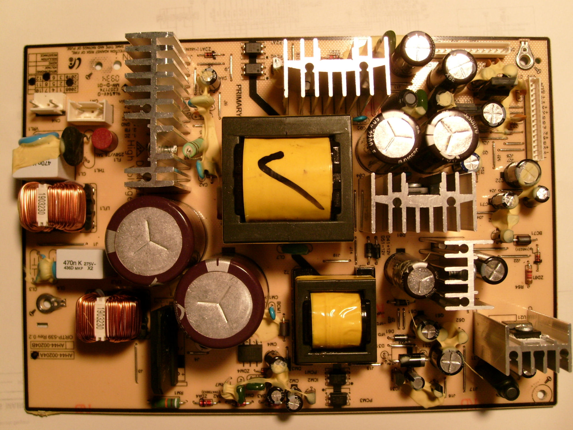

    I picked this unit up recently for practically free.
    Powered it up and all it does is light up the power standby.
    Checked the PS output voltages at the ribbon cables and the only voltage I'm reading is 5.6V @ Pin 11 of the CN3 connector.
    I then checked the fuse and the bridge input/outputs. This is where I am confused as the bridge reads 110V AC on one leg while the other AC leg reads 17V. The output legs are reading 14V DC. Pulled the bridge and it checks fine.

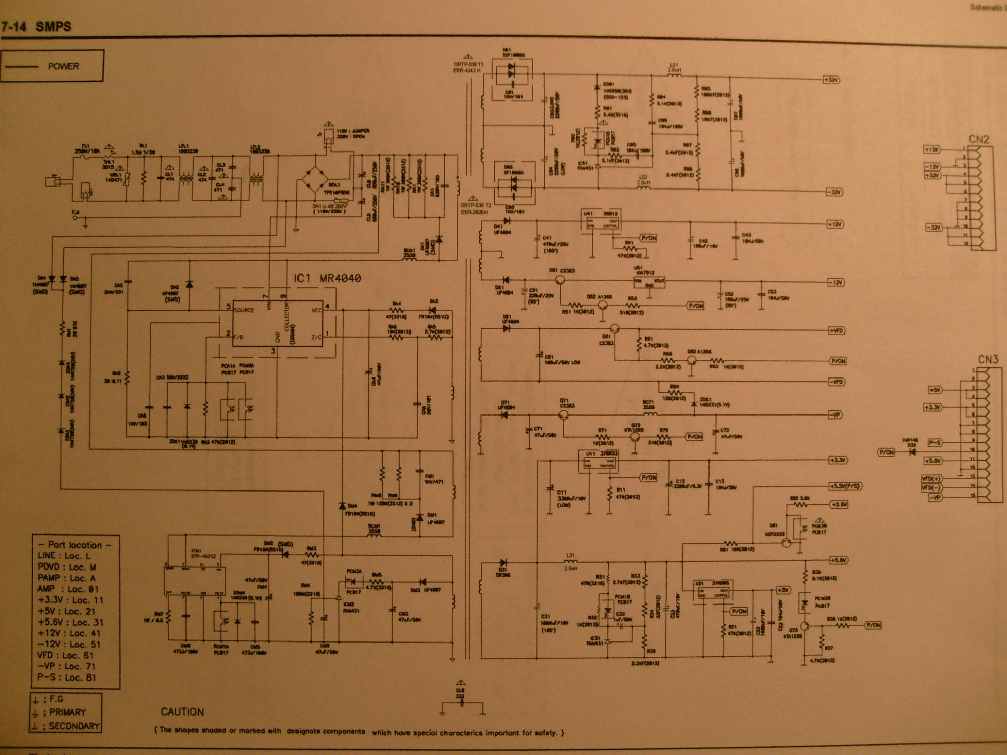

    I found the service manual for a nominal fee but I am totally stumped as to what is causing the bridge voltage readings to be what they are.
    Man..... I feel like a total as the answer is probably staring me in the face but I'm not seeing it.

    Re: Samsung HT-AS730ST
    Are you measuring these values with respect to ground/case? If so, this is why you may be getting odd voltages. When measuring DC voltage on the primary (high-voltage) side of the power supply, always measure with respect to the hot ground - i.e. the negative side of the bridge rectifier.
    Now, you say your PSU is outputting 5.6v for standby. This means the primary side is good, or at least the standby circuit is, so don't mess with it yet.
    Try measuring the voltages on CN2 and CN3 (with respect to ground/case) when you press the power button. Do any of them appear for a split second or pulse?

        So all pins on CN3 are reading 0v except for 5.6v? Even P/ON?
        First, check diode D32 (near CN3 connector). Is it good? If so measure voltage for P/ON both when power button is not pressed and when it is pressed and held down. Measure the voltage after it passes through D32 (i.e. on the cathode side of D32).
        Anything?
        P/ON is the high/low signal that triggers all the other voltage rails. The fact that 5.6v is present means P/ON should also go high (probably close to 5v) when the power button is pressed. So, either receiver's logic board is not working right and not sending the P/ON signal, or there's a fault in the PSU, pulling P/ON down and preventing the PSU from starting up.
        If you get no voltage for P/ON, can you post a picture of the receiver's logic board (particularly, the one that connects to CN3).
              I was cycling the power button to quickly as there is about a four second delay before any voltages start to register.
              Well, that's strange. How long did the voltages stay up before they dropped again? Does P/ON change at all when you press the power button? Also, do you get any voltage on the pin labeled P-S?
              So.... since P/ON is low, what would be the most likely cause of this?
              It might not be low. On some PSUs it's close to 5v, but I'm not sure if that's what it should be here or not.
              Also, P/ON is a return signal *usually* generated by the logic board of the device and not the PSU itself. If you look at the schematic, you will see that P/ON points inward, not out, indicating an input signal going to the PSU.
              Maybe post some pictures of the other boards as well. Perhaps someone else might be able to point out something I missed.
