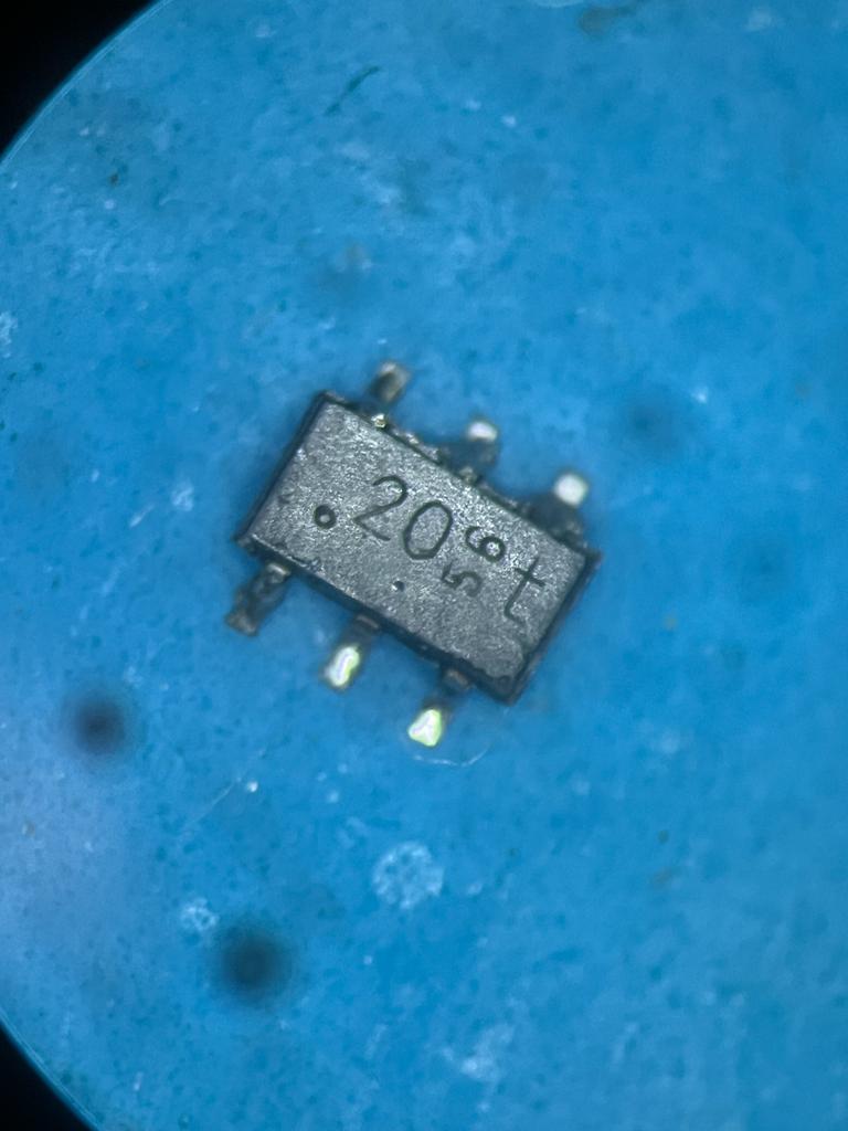

    Hi Guys, I'm repairing a DMX interface and I have this component shorted, can you help me find the code? I am attaching a photo, thank you very much

    Ip4220cz6 - Dual USB 2.0 integrated ESD protection

      thank you very much!!!!!! FANTASTIC
