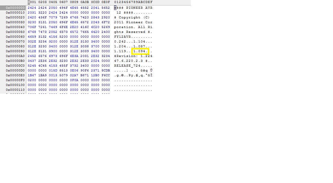

    Would highly appreciate it if anyone has the bin dump for this EEPROM on this specific model number.
    The circuit is Location: IC9004 and Make is: MX25L1606E.
    The IC is quite easy to get to as it is on the top side of the pcb, popping the cover off and it's there for the world to see.
    I flashed the IC with another Pioneer model and I got sound, only thing is that FM is now all out and funky. Basically tunes in to every single frequency and doesn't give sound. All other functions, CD, HDMI ARC, DVD, etc works. Just the FM is off.

    I have that file where I changed the version number, do you still want to try and see if it will update?

                Yes the file is for USB update, I bumped the update number up by one so it would not be the same as what was installed. If this method does work. I will leave the file up.

                  Well what do you know.. I used the USB method to update it and now it's at 50% and updating. I hope this works.
                  Also, I thought I was going to use a programmer for this? Just the USB update works? Kind of baffled. Anyway it's still updating will update if this fixes the FM issue.
