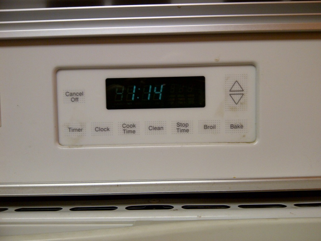

    We have a Jenn-Air W30100W wall unit oven. The display ( LEDs ??) characters flicker a little, and some of the characters are partly lit so that it is getting harder to read the display.
    A new display ( I believe it is called the Clock assembly) is hard to find and is about $200.
    Can I fix this myself ?
    Is this a case of bad caps ?
    I know how to solder caps.
    Thanks.

      Re: oven display flickers
      Thanks Jeta.
      I did see that post before I posted mine.
      My symptoms are different from his.

        It could be bad caps causing low supply voltage, or the VFD (vacuum fluorescent display) has slowly gassed out somewhat. It is also possible that the phosphor has wore off too.
