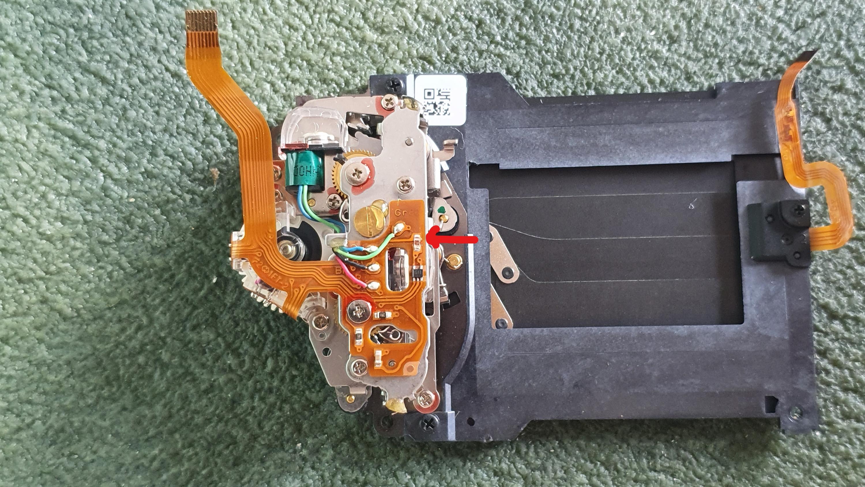

Hello, do you know what is this component pls of Nikon D800 camera shutter?
  • corrize
    • Apr 2021
    • 272
    • France

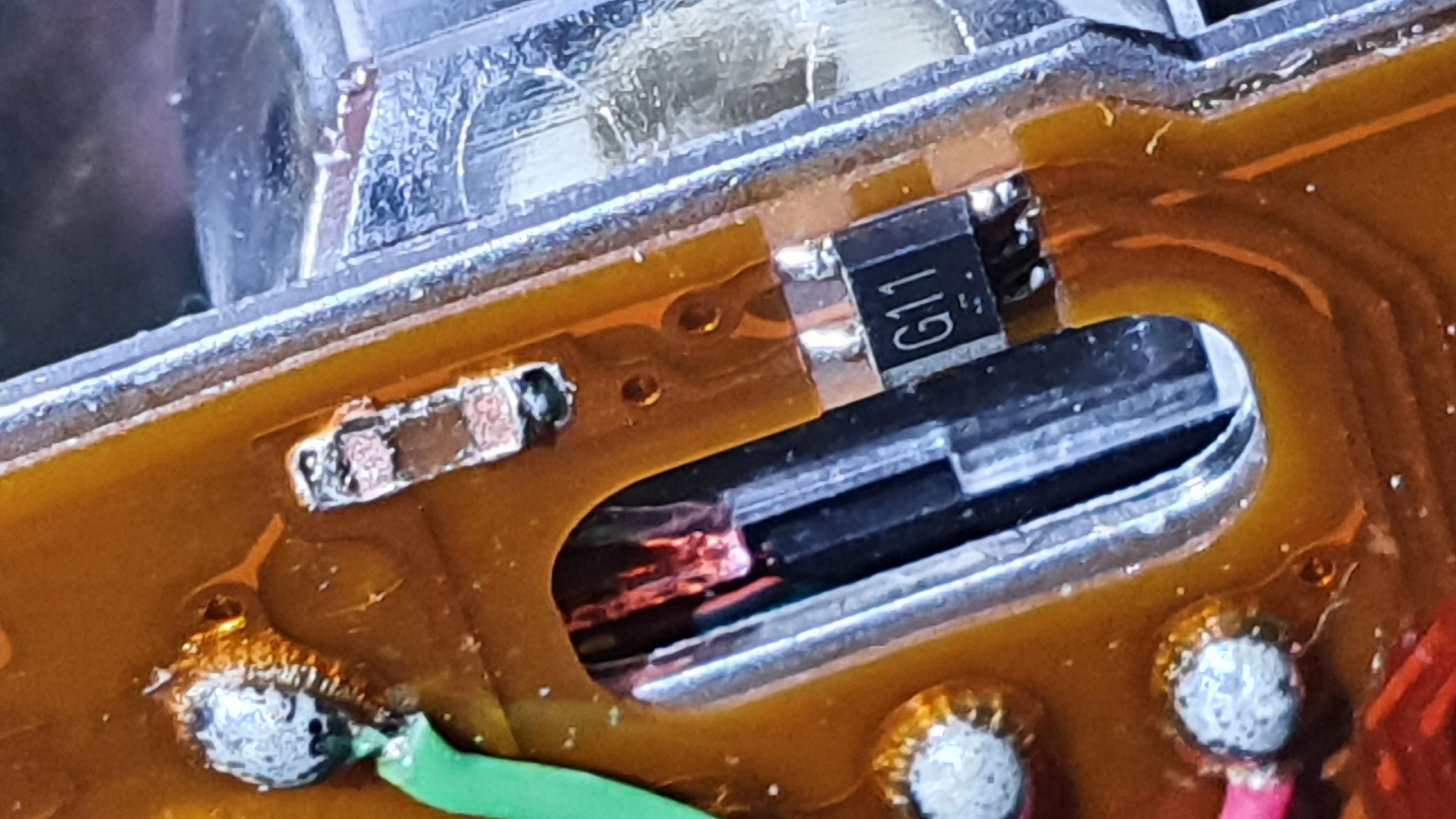

    It is on « board » of Nikon D800 camera shutter, probably for command electro magnet (the green stuff). The chip is marking G11 and have a polarity mark, so maybe dual diode ?
    The chip is good, the goal is I can deduce the value of the capacitor missing above.

    Re: Hello, do you know what is this component pls of Nikon D800 camera shutter?
    Chip can be FMG11A Dual N transistors
    if so, capacitor may be 0.1uf - 1uf
      Update : I tested with 10uF cap (not found closest value in my stock) and the shutter works. The first curtain moved (before nothing was appening).
      But the first curtain stayed stuck, so I was doubt on mechanical issue.
      I have another D800 with shutter working fine (but another issue), I disassembled and checked, and found a difference of behaviour. I found a little metal part with no spring reaction (on all curtain's positions) compared with the good shutter (it has permanent spring reaction). So shutter need to be replaced.
      I tryed to measure the capacitor onboard and found no value, probably out of range of my cheap meter.
      If the shutter hadn't had a mechanical problem, I would have replaced it with a 1uF capacitor.
      Thanks for help.
          I did it, But the motor is not on the shutter. It turn. The little electronic seems control two electro magnet (green stuff) for stopers.
          At the first test, I said ; "nothing happen" but in fact the motor turned but curtain did not move. It was stucked.
