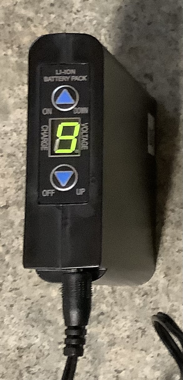

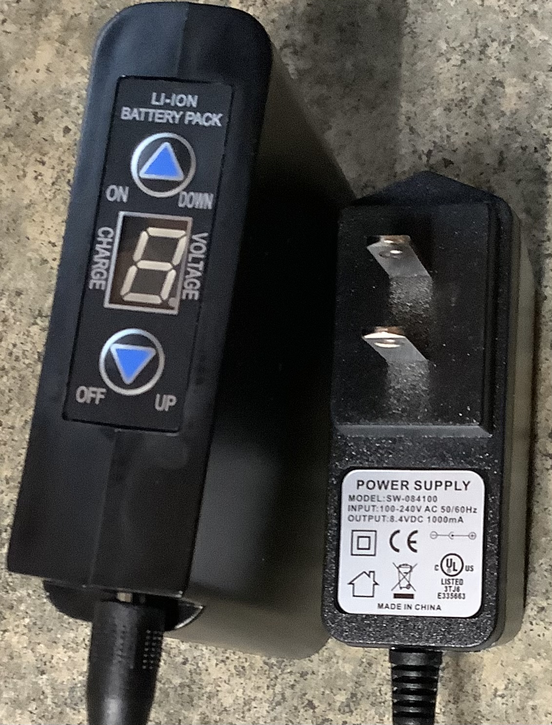

    Here is a project that I put together from a battery pack and switching power supply and belt pouch holder for the battery pack
    This battery pack was made for the helmet cooling fan or vest cooling
    This was an item that was available from them but it is already sold out
    But I have repurposed it to power a flashlight with 4 power levels the controller board is very interesting that it deliverers four power levels 3 , 5 , 6 , 7.2 volts
    It also lets you know how much charge is on your battery pack
    One note the battery power supply was set to number 4 which is the 3 volt output of the controller
    One other note it does not work correctly with LED light bulbs at all it blinks to much until you get to 6 volts it does not matter if you put a capacitor on the output it just slows down the flashing

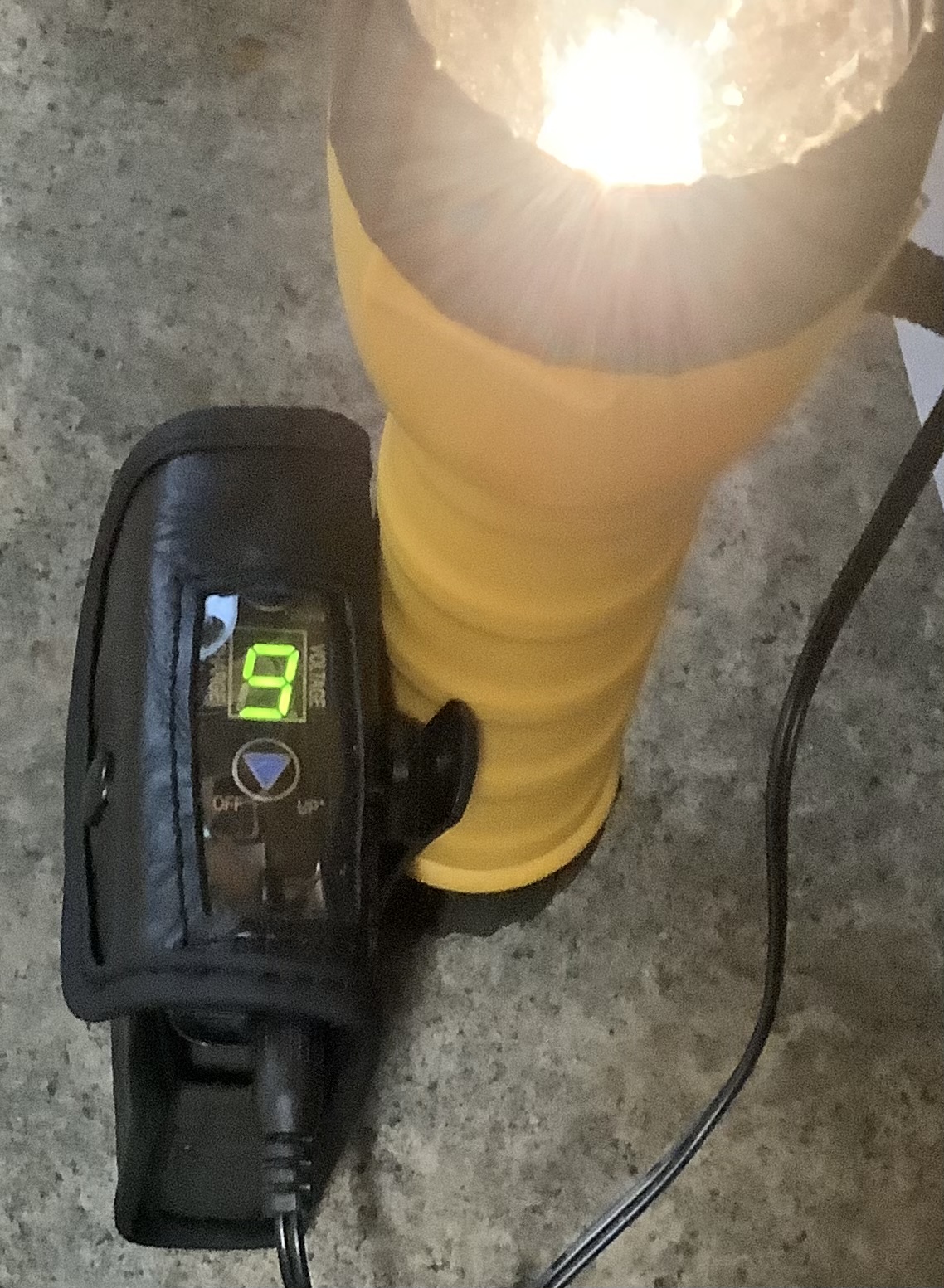

    One other note the light bulb is a PR13 ( 6 volt incandescent light bulb )
    Yes I know I can run it at 7.2 volts the light bulb is not going to last very long but if I more light for a short period of time I not going to worry about it if burns out I just going to buy a box of PR13 light bulbs they are not that expensive

      I did a running test for this battery pack it ran 10 hours on the 3 volt setting very pleased with the results

        I was able to find some 7.2 flashlight light bulbs that I bought a box of 10 because I going to make several of them
          • Jul 2011
          • 6024
          Re: New project idea from some batteries bought from Battery Hookup
          Well the light bulb came in today and I do not really see any difference in brightness of the light bulbs but there might be even though you might not see it
