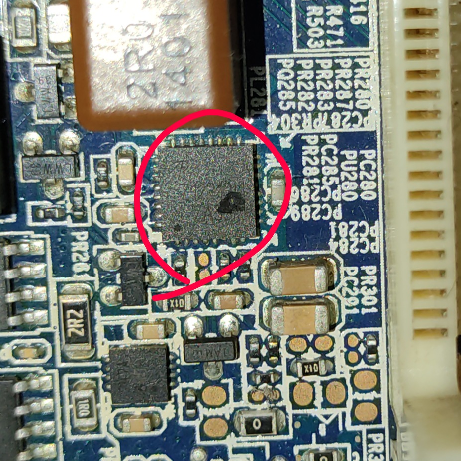

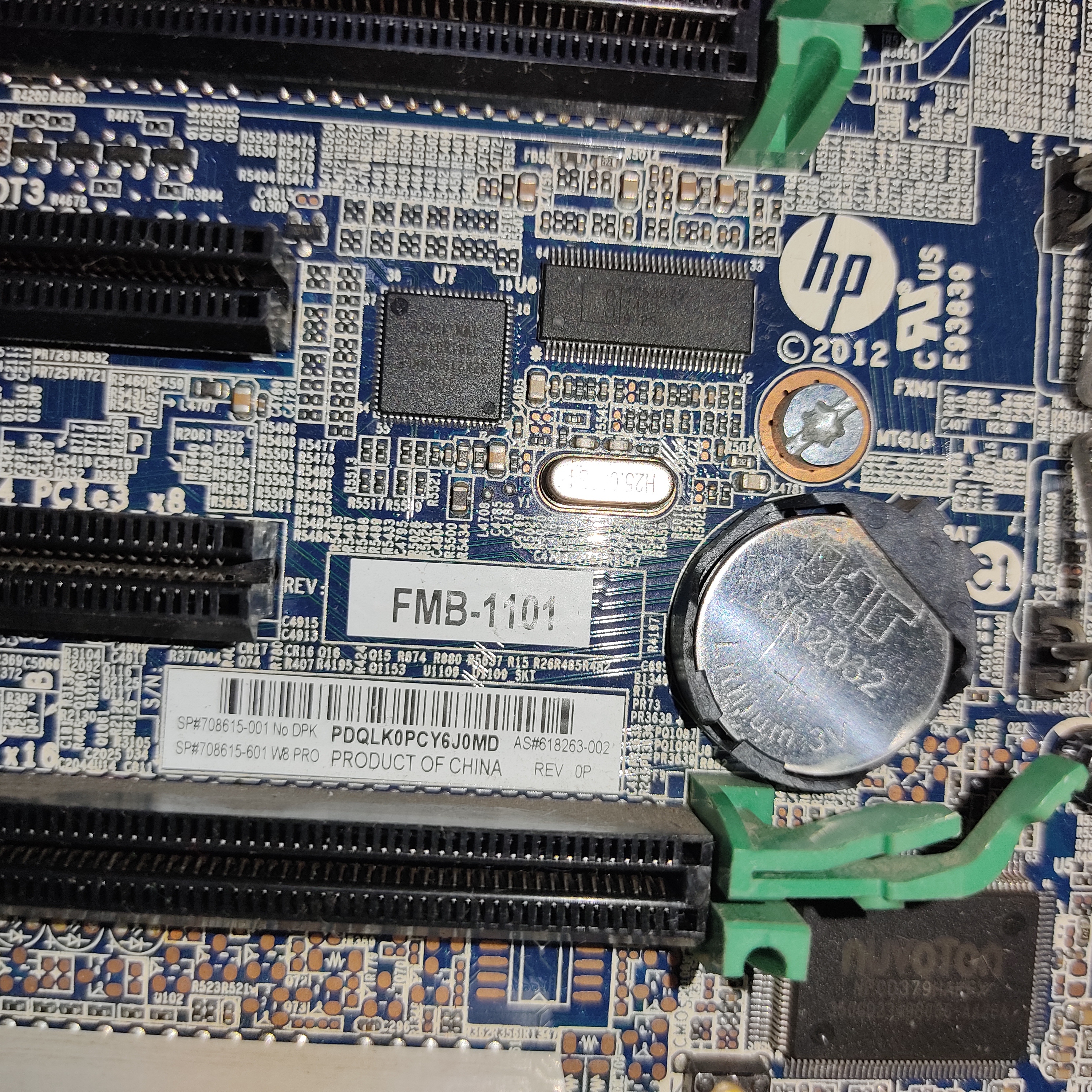

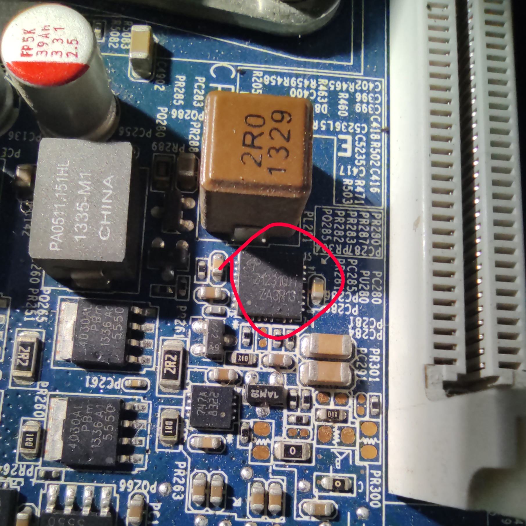

    I have a burnet IC (AOZ1231) that is responsible for providing power to the processor circuit. I didn't find it so far as well as the manufacturer stopped producing it anymore. But I found a possible alternative (AOZ1232). I want to know if I can replace it instead of the original. I will provide the datasheet for both ICs. I hope you help me decide or if you have another solution. Thanks in advance.

    - Motherboard info image: Motherboard Info.jpg
    - My burnt IC image: My burnet IC.jpg
    - A working device IC Image: Healthy IC.jpg

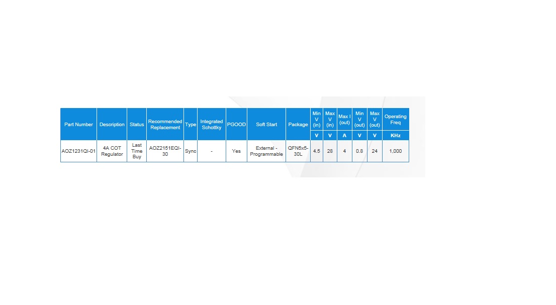

    Re: HP Z420 processor power IC burnet AOZ1231
    I did find this if it helps. I went to A&O site: http://www.aosmd.com/products/power-...s/AOZ1231QI-01
    Recommended Replacement is: AOZ2151EQI-30

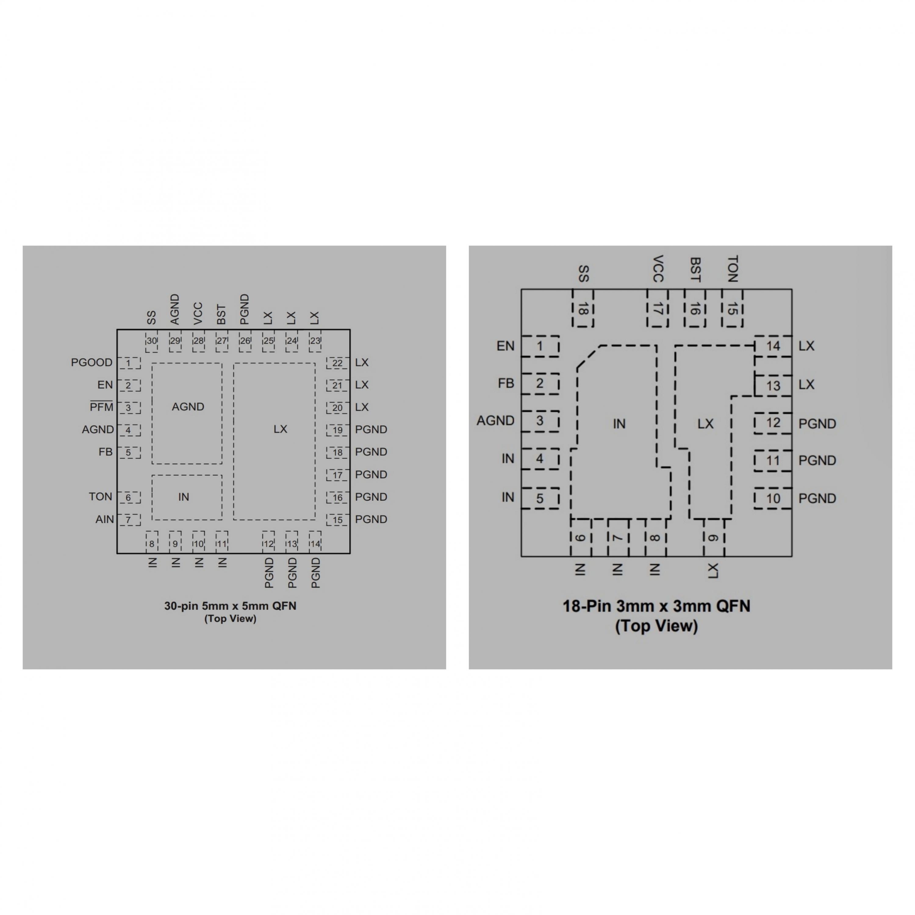

        Actually, I have compared it before but there is a difference in the pin numbers.
        Thanks for your response R_J.
            I see that, I guess it is not a pin for pin replacement
