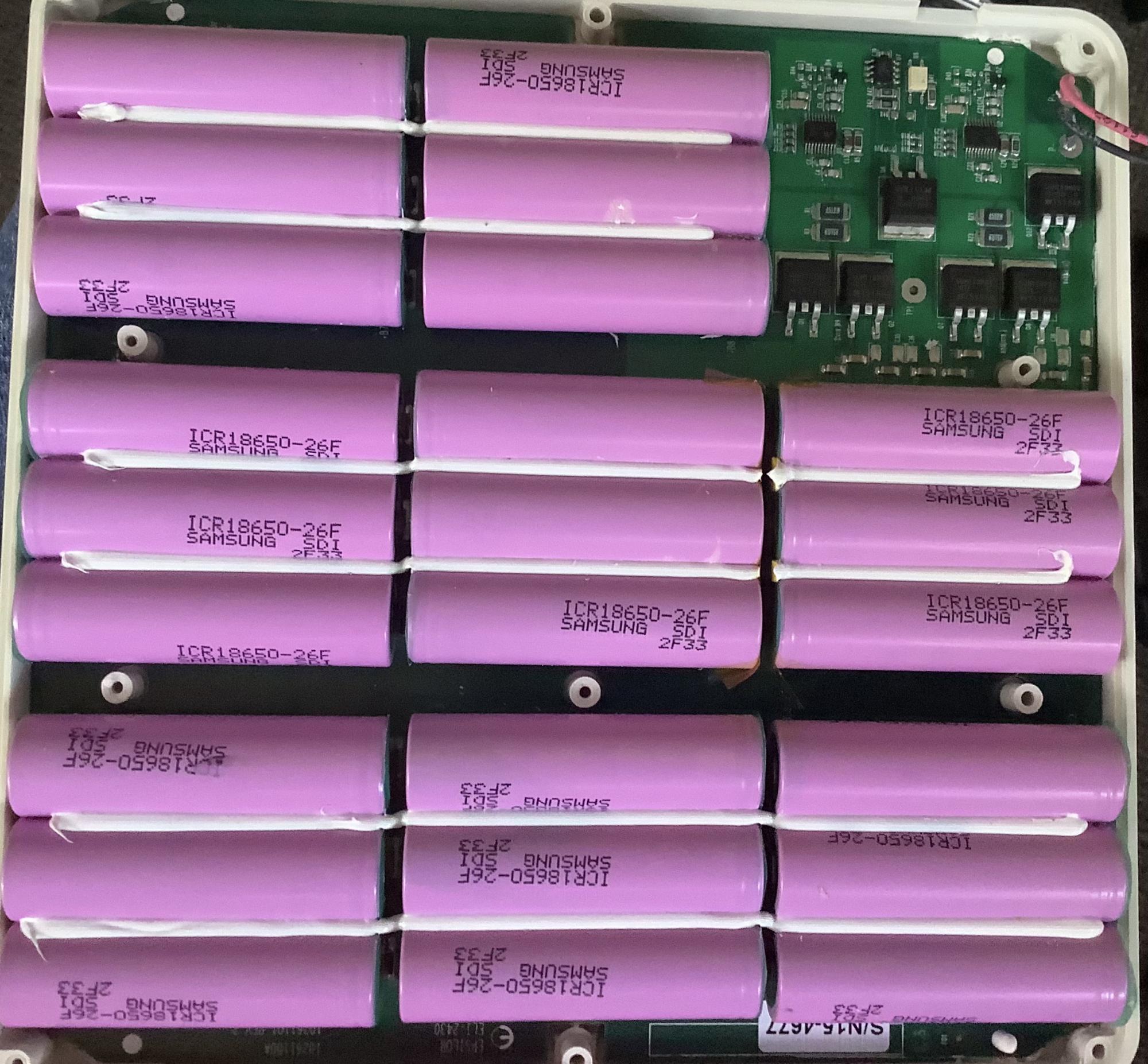

                        I bought a few of these battery packs and they are very interesting for $29.00 for 24 batteries and the BMS protection board which they claim that also works but I have not tested it yet but I will let you know if it works correctly or not
                        This was also bought from Battery Hookup but unfortunately they are out of stock already again for the second time since they started offering this item
                        I am going to use this for a LED yard light that the switching power supply took a shit and can not be repaired because it has leaking capacitors and it is incapsulated with black hard plastic I guess that what this stuff is
                        This operating voltage is 32 volts and this battery pack has this voltage as well I just have to find a weather tight enclosure that will fit this battery pack/BMS board commination I already have the solar panels that I bought a while back that was also surplus but at the time the project that I had in mind had technical issues that I could not overcome at the time so they have just been sitting here collecting dust until now that I have found a battery pack that will work the LED yard light that also has issues and just repurpose both items to be used in another way
                        I am going to be testing this battery pack in 12 volt sections and one 8.4 volt section just to be sure that the milliamperes hours rating that they claim to be
                        I have found that the medical grade battery packs are most of the time are good quality devices and are easily used for projects
                        I will post some pictures of this project when I have completed it so you can see what I came up with

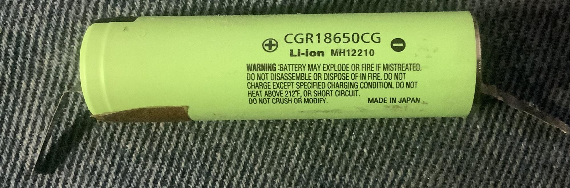

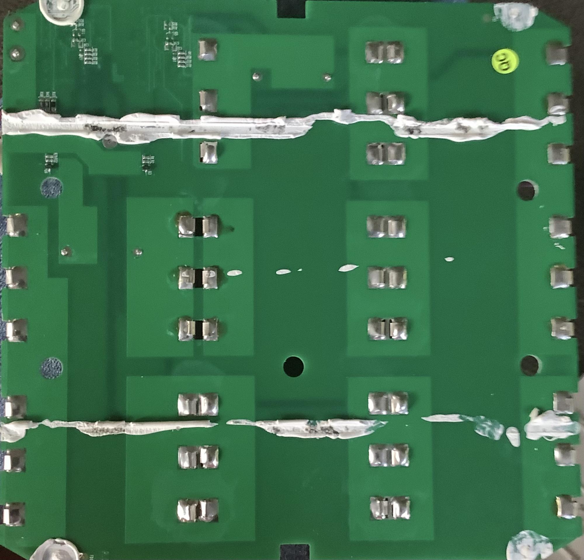

                          Here is another item from Battery Hookup that is also interesting item
                          https://batteryhookup.com/products/8...-cells-ibh9100
                          Now this one is hit and miss with weather or not you get good batteries or not I bought 6 battery packs and two had bad batteries in them but I can reuse the battery pack case for a project so I am not to worry about it not being good
                          But if you do get good ones they will be at or above 50% of charge on build in fuel gauge
                          One note you do have to use plastic pry tool to open the battery pack enclosure it does take some work to pry it apart but the enclosure can be reused for 8 (18650 battery cells )
                          One more note I am not sure that you can use the BMS protection board or not because I have not figure this out yet

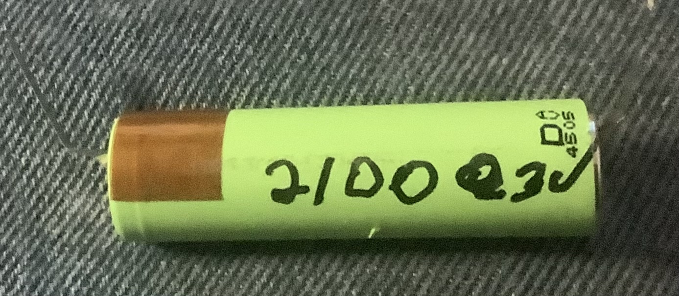

                            Here is an update on this battery pack
                            The individual battery cells so far are testing at around 2100 to 2200 milliamperes hours = 3.00 volts @ 500 milliamperes working dropout voltage and 2400 milliamperes hours when battery tester shut off and battery is rated at 2600 milliamperes hours
                            Which means that the useable battery life is 90% when battery voltage reaches 3 volts under load around 80% to 85% if you use 3 volts at 500 milliamperes maximum dropout current
                            The one thing that I noticed about these batteries is that charging curve voltage is not very impressive it is steeper than what I expected to see I prefer to see less steep climb in voltage until it reaches around 3.8 and then level off and slowly climb until it reaches 4.2 volts
                            Now the discharge curve is a little bit better but it is a little steeper drop when battery voltage is around 3.5 volts is when it becomes more steeper than what I expected it to be
                            I will use these batteries in another project because of the charging curve and discharge curve results

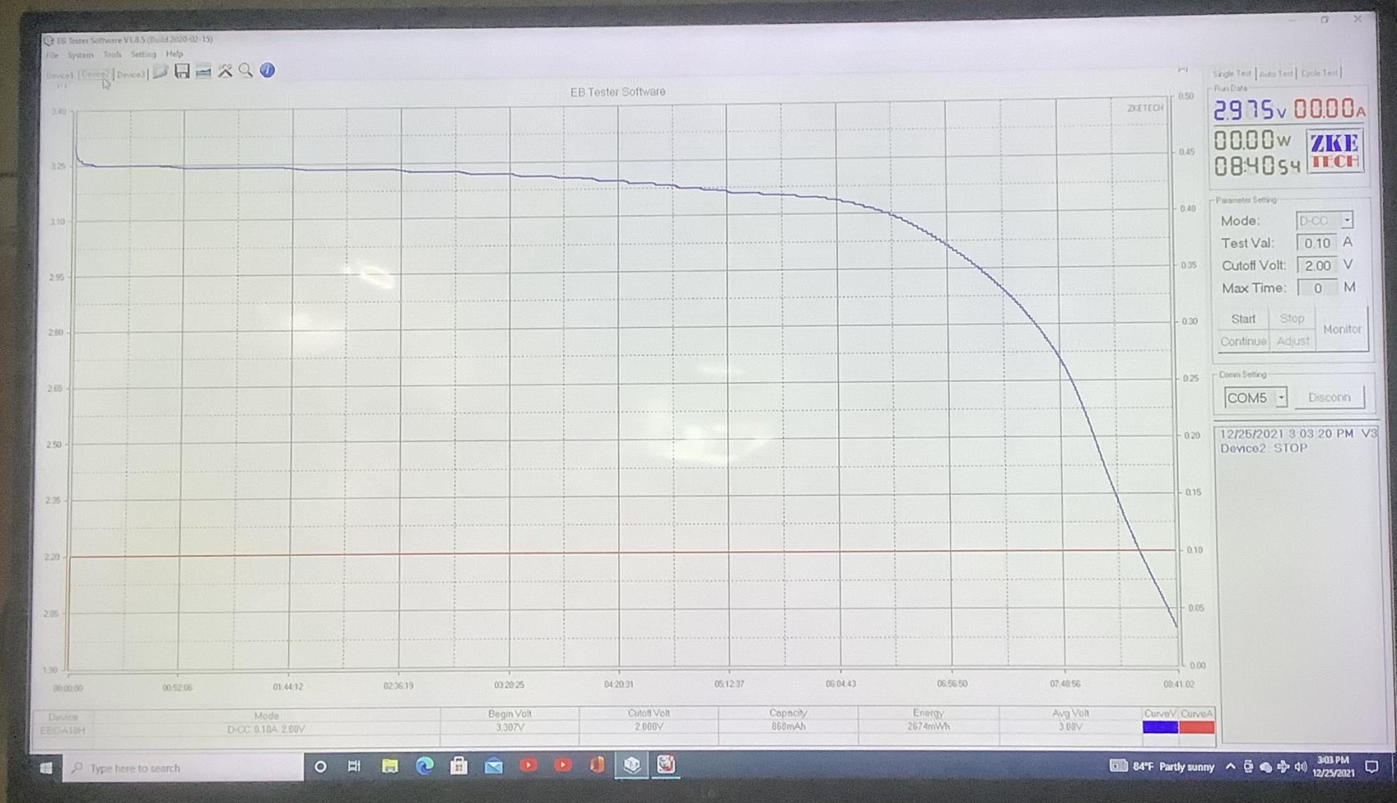

                                        Originally posted by sam_sam_sam
                                        Here is a very very good deal I have yet to see a battery below 2.50 volts and few I have tested I got at 2200 milliamperes hours
                                        I had ordered 30 of them
                                        https://batteryhookup.com/products/3...cells-with-pcb
                                        I just ordered 40 more
                                        Here is a picture of the battery in question I still have a lot of batteries to process I have only done about 30 of them and I still have over 100 more of to test but have not had time to do I have been testing other batteries but I might get back to them soon I hope
                                        Unfortunately they are out of stock on this item and I have not seen it return yet
                                        The results are looking at the graph and where the voltage is at 3 volts is where I getting this value from not the total amount of milliamperes hours that when it reaches 2.8 volts as the SkyRc IMAX b6 tester shuts off at which is when it is at 100 milliamperes

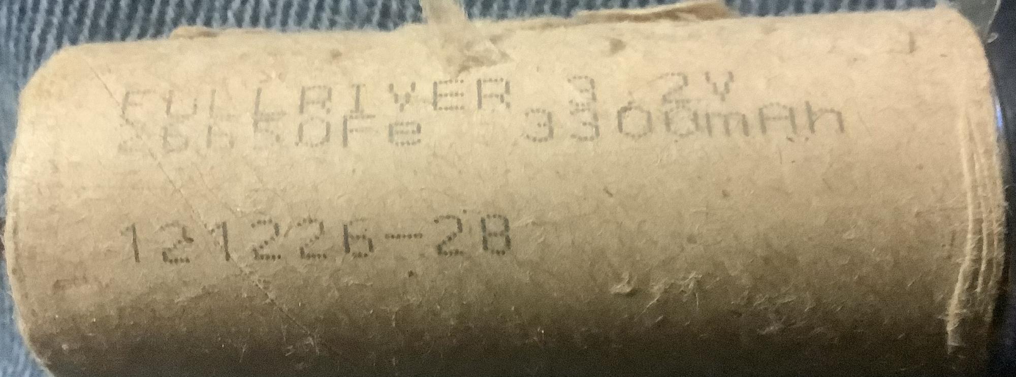

                                          Here is some batteries that I bought a couple of years ago and they were a disappointment because they are not 3.3 amp hours like it says on them but they do not heat up but when I first bought them they never had much higher amp hours rating that they do now
                                          I will give them to someone who is interested in them just pay for the shipping I think I have 3 or boxes of them but there is only 6 to a box if remember correctly
                                          Just PM if you are interested in them I do not want them to go to waste if someone else can use them the outside cover does not come with them however but they will be individual wrapped to not short out and I will test them to make sure that you do not get any that are DOA
