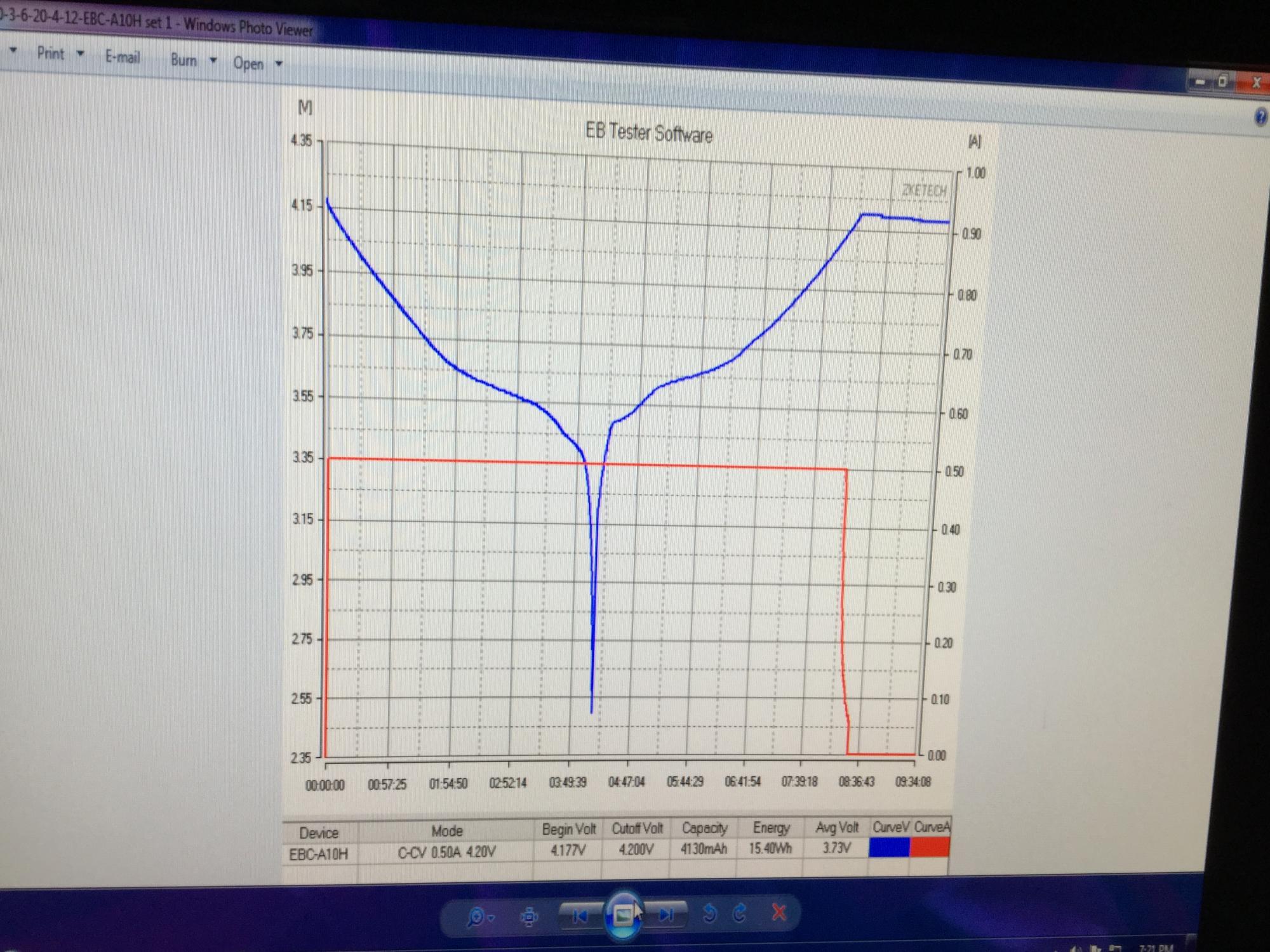

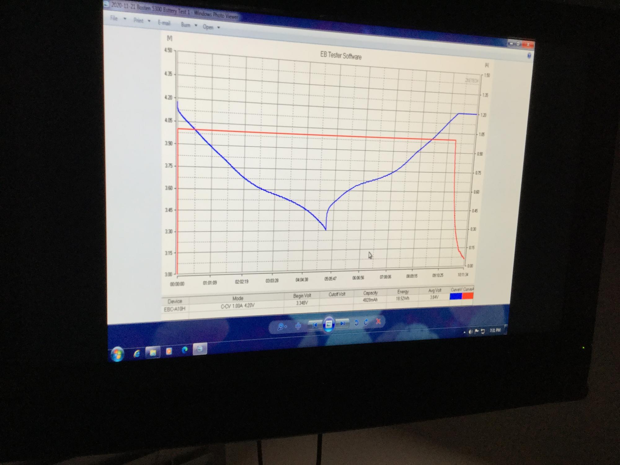

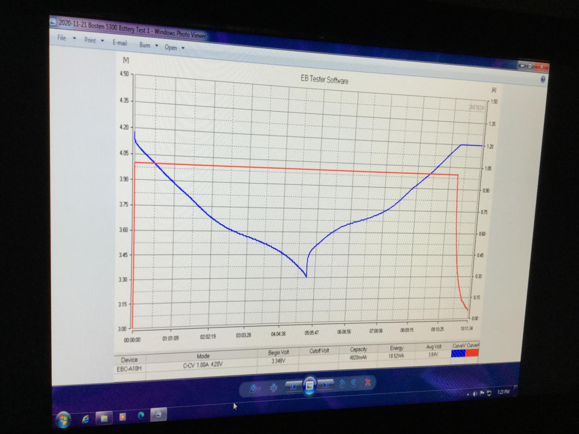

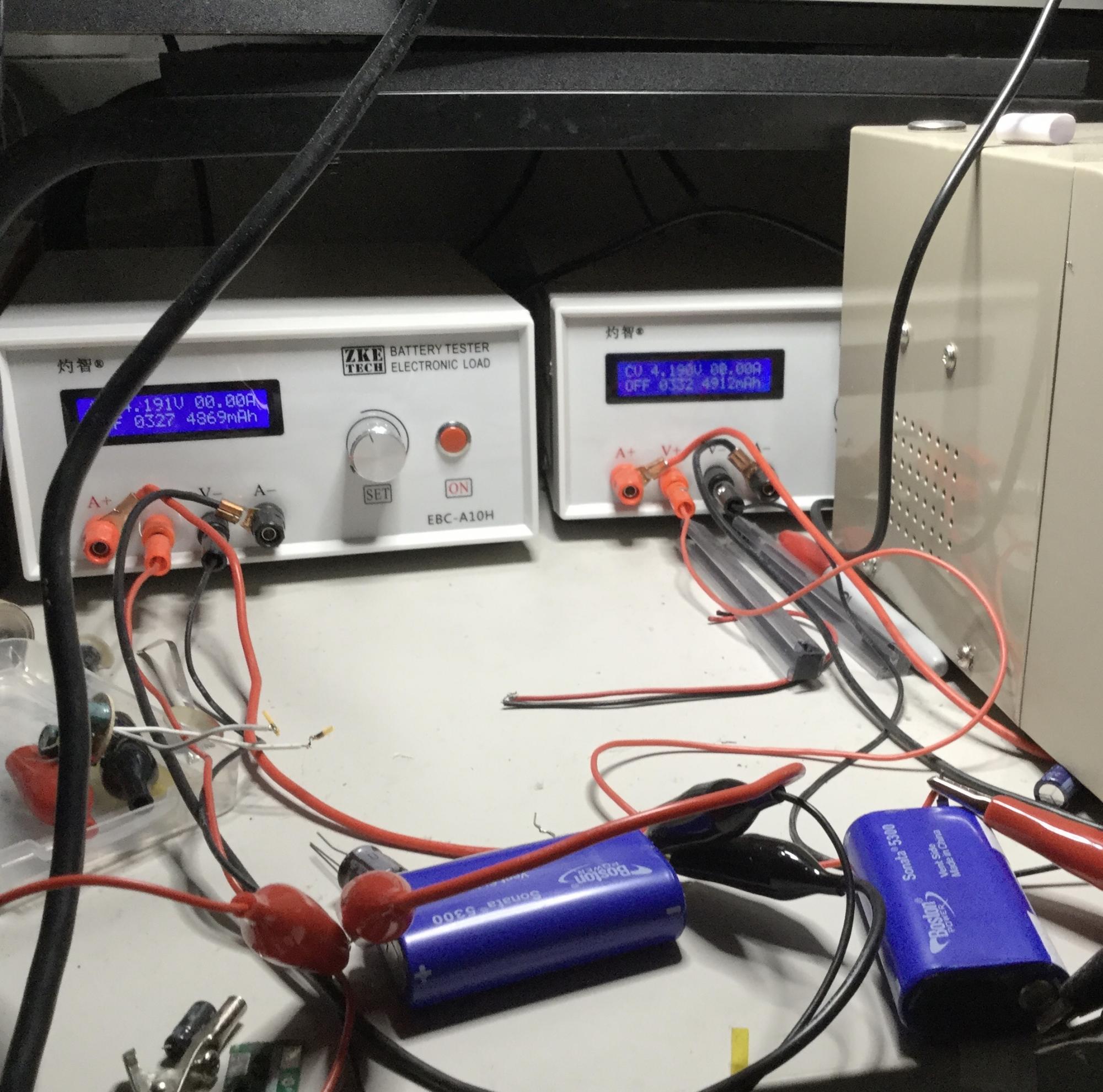

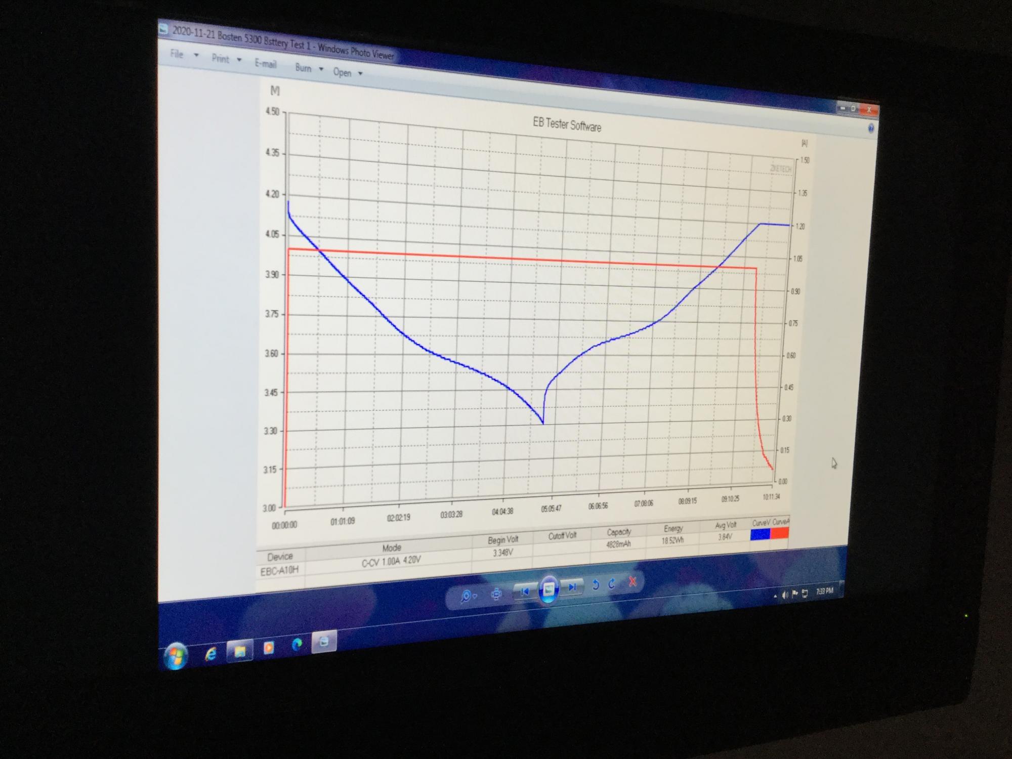

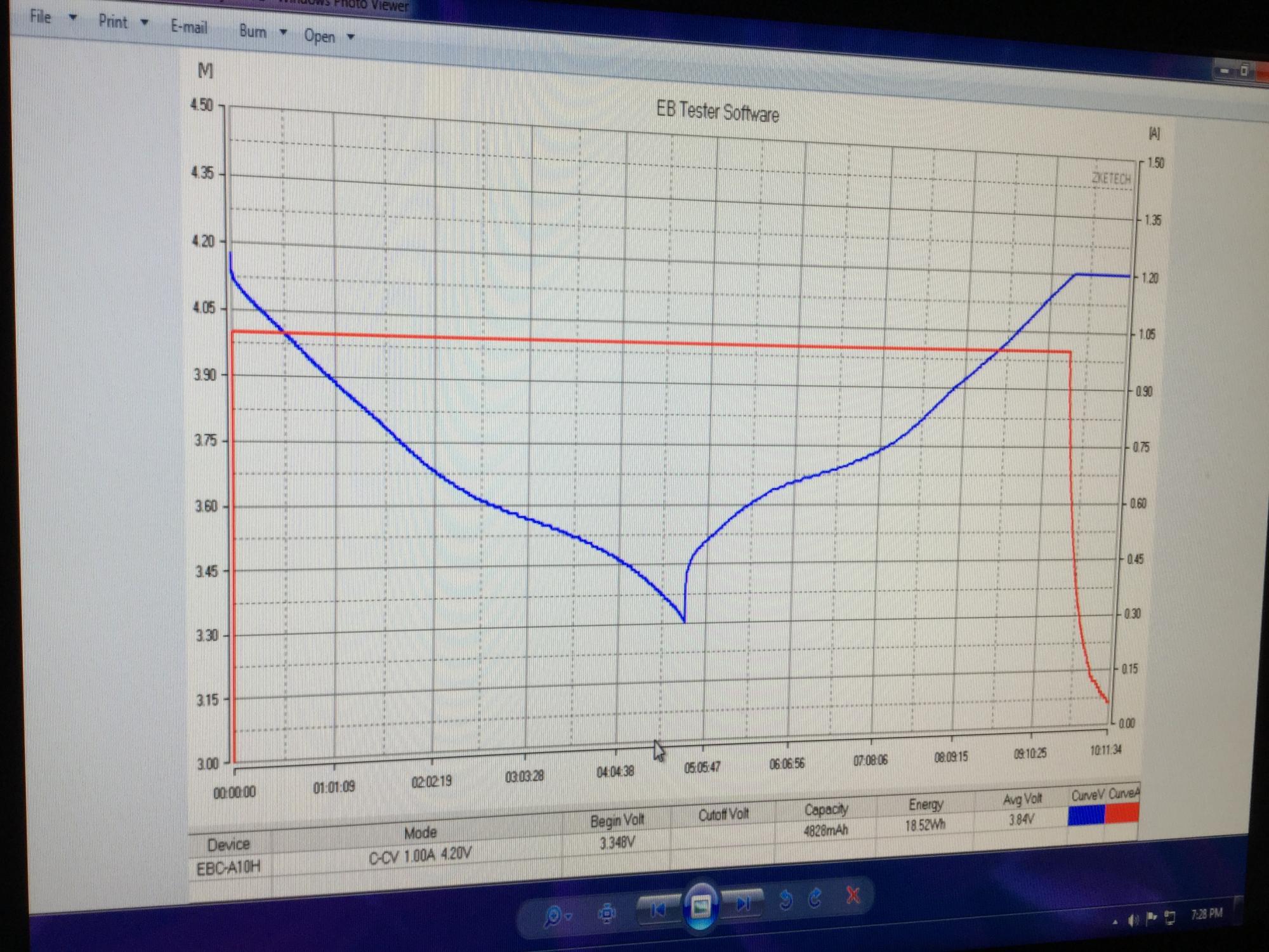

    Here are some battery test results
    The first battery the settings were not set right the fifth picture is the correct results
    I bought these batteries from a seller on EBay ( two sets of them ) this is only $2.80 each
    !!! Disclaimer Notice !!!
    I have the seller permission to post his listing for these batteries
    I am not promoting his web store
    Only these batteries to me they are a good buy for what the amp hours these batteries still have left in capacity ( “5300 mill amp hour capacity so there is still about 90 % still left over 4800 mill amp hour )
    !!! Disclosure Notice !!!

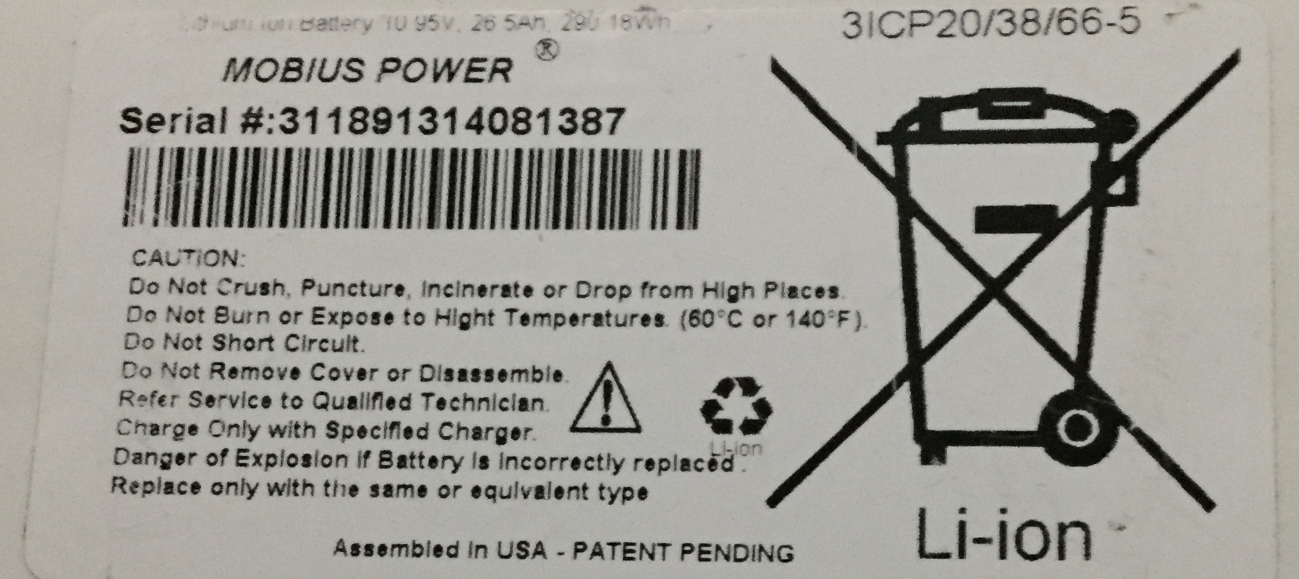

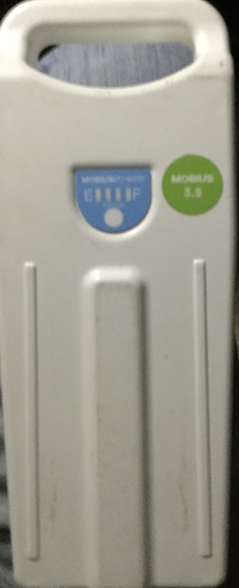

    The last picture is the type of batteries that I was testing
    Here is the listing for these batteries
    https://www.ebay.com/itm/Lot-of-10-U...53.m2749.l2649
    I going to build a cell phone / tablet battery pack for at lest 10 amp hour capacity or maybe a little bit bigger if the case can fit the batteries
    You might have noticed that the file names say the same exact thing but it is the way the program opens the picture files but trust me these are 4 different batteries I could not post the files are to big to post
