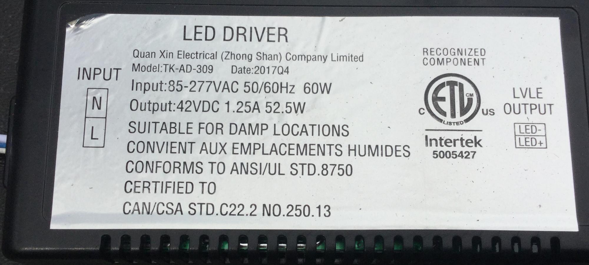

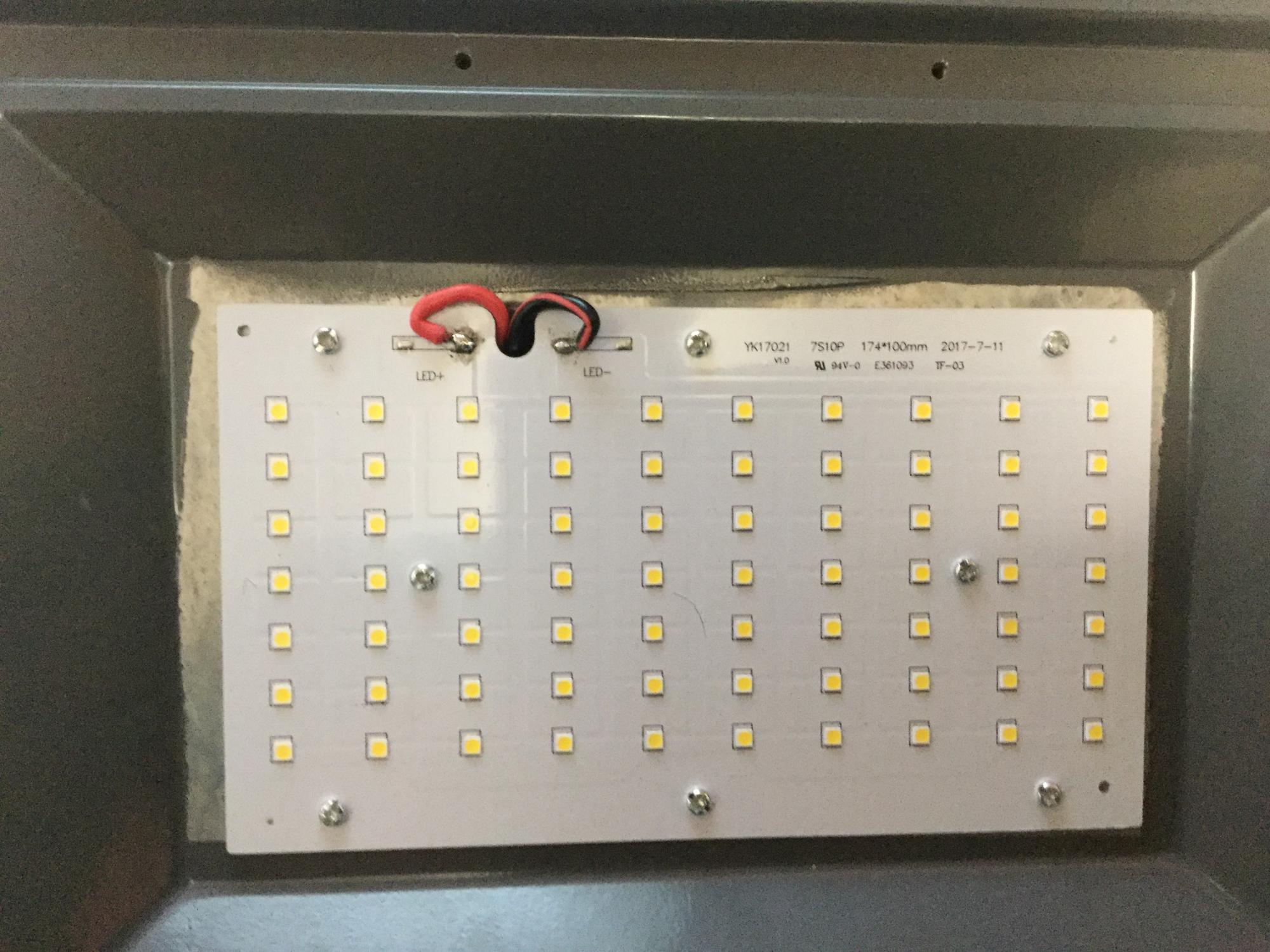

    I bought this 60 watt LED Yard Light about month ago
    I want it to run off batteries
    With the boost controller set at 39 volts @ 1.5 amps the LED Yard Light is not quite as bright as it would be with the power supply that came with it but this is alright if I were to set it for the same exact light output the amperage would be about 2.5 amps the batteries would not last very long on a charge or I would have a lot bigger battery pack
    I going to use some 5 amp hour batteries for this yard light that I had bought about year for this project li-ion batteries pouch type battery
    At 39 volts on my adjustable power supply it was about 730 milliamperes

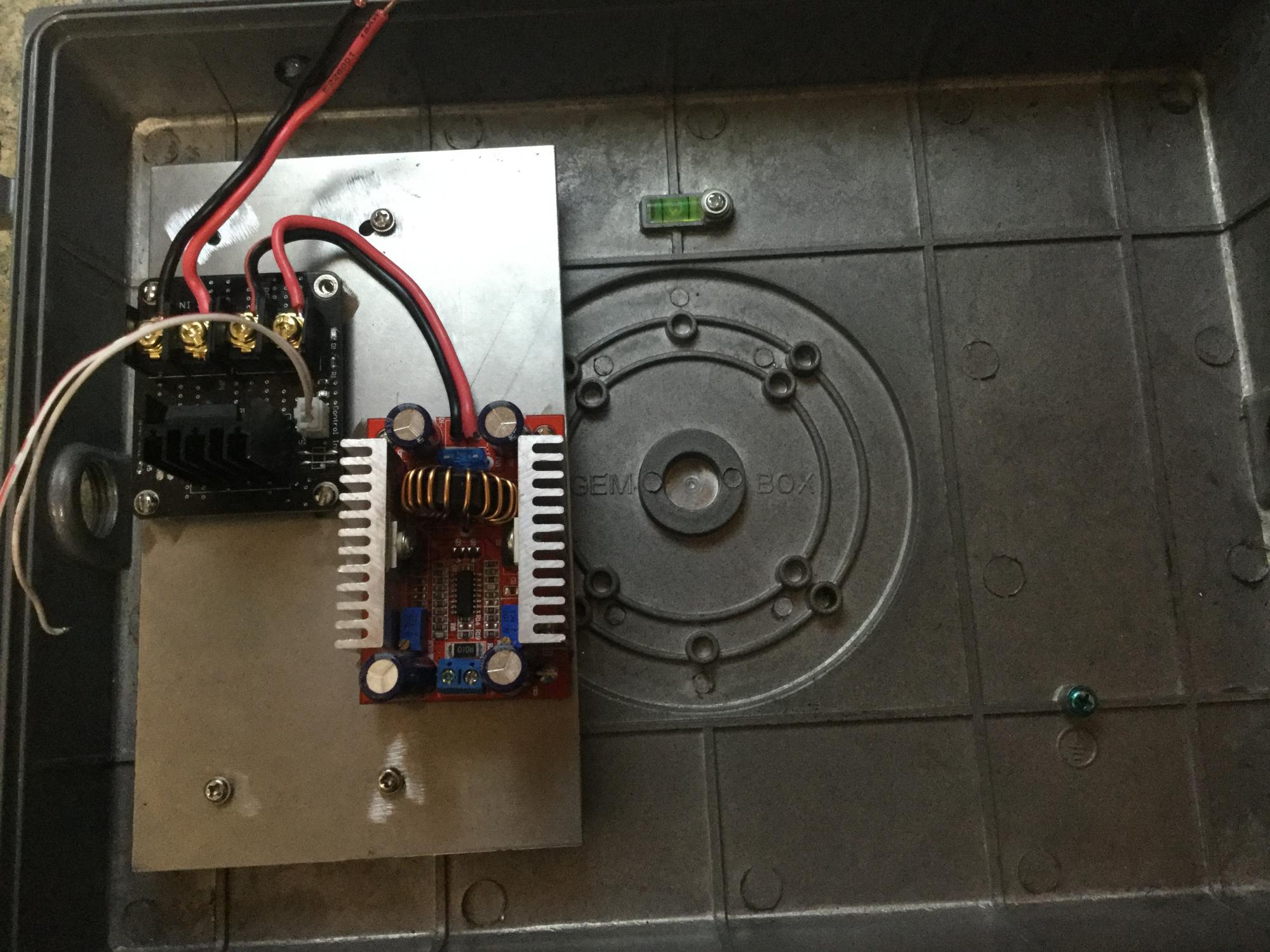

    I have tried this setup and it seems to work very good
    I have to make up the battery pack for this yard light
    I have a 42 watt yard light that I was going to do with but it did not have any room for the batteries or the night dark controller so it got put on hold
    What I am calling the night dark controller is a for a 3D hot bed heater controller module
    ( modified the input voltage from 6 to 12 volts down to 2.1 to 3 volts )
    Night controller $10.00
    Battery pack $55.00 for 5 batteries I will only use 3 or 6 batteries not sure yet
    Boost controller $15.00
    LED Yard Light $49.00 ( took out the switching power supply from it ) power supply are about $25.00 and up
    I still need a white LED solar powered garden light for night controller input voltage turn on
