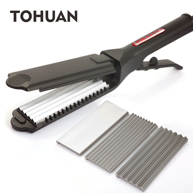

    my idea is use same theory like hair straightener to make a COF portable Bounding machine.
    COF Bounding needs temperature, pressure, and Precise alignment and the most important.....Anisotropic Conductive Film tape...ACF tape which price has been dropping become more affordable.
    i try to use two piece flat glasses (glass microscope slides. ) to hold COF TAB in between with spring give the pressure.......but i don't know how to heart up the glasses. i thought to put heating element inside the glasses but at same time they need to be transparent for COF position alignment.....any help would be appreciated

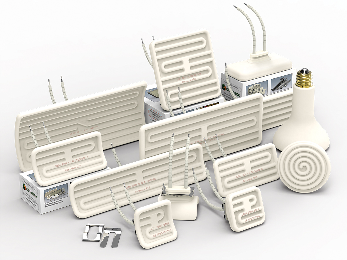

        Quartz Infrared heating element method:
        This maybe alternatively to solar if it is a cloudy day or rainy day.
        Ceramic Heating Element method:
        A lots of hair straighteners already use ceramic heating elements
        Is there anybody can think of another method?

            I tried to import one COF bonding machine to United States but I figure out all that weight are the grass and the metal frame, all machines are monopolized by China, and the technology of this machine has not been updated.
            The working principle of the whole machine is the same as the temperature-adjustable soldering iron or hair straightener and I don't believe we need a air compressor attach to the machine to do the job.
            For me this COF bonding machine should not bigger than a FoodSaver.
            Precise alignment, new ACF tape, temperature and pressure are the most important factors which are not too difficult to accomplished.
