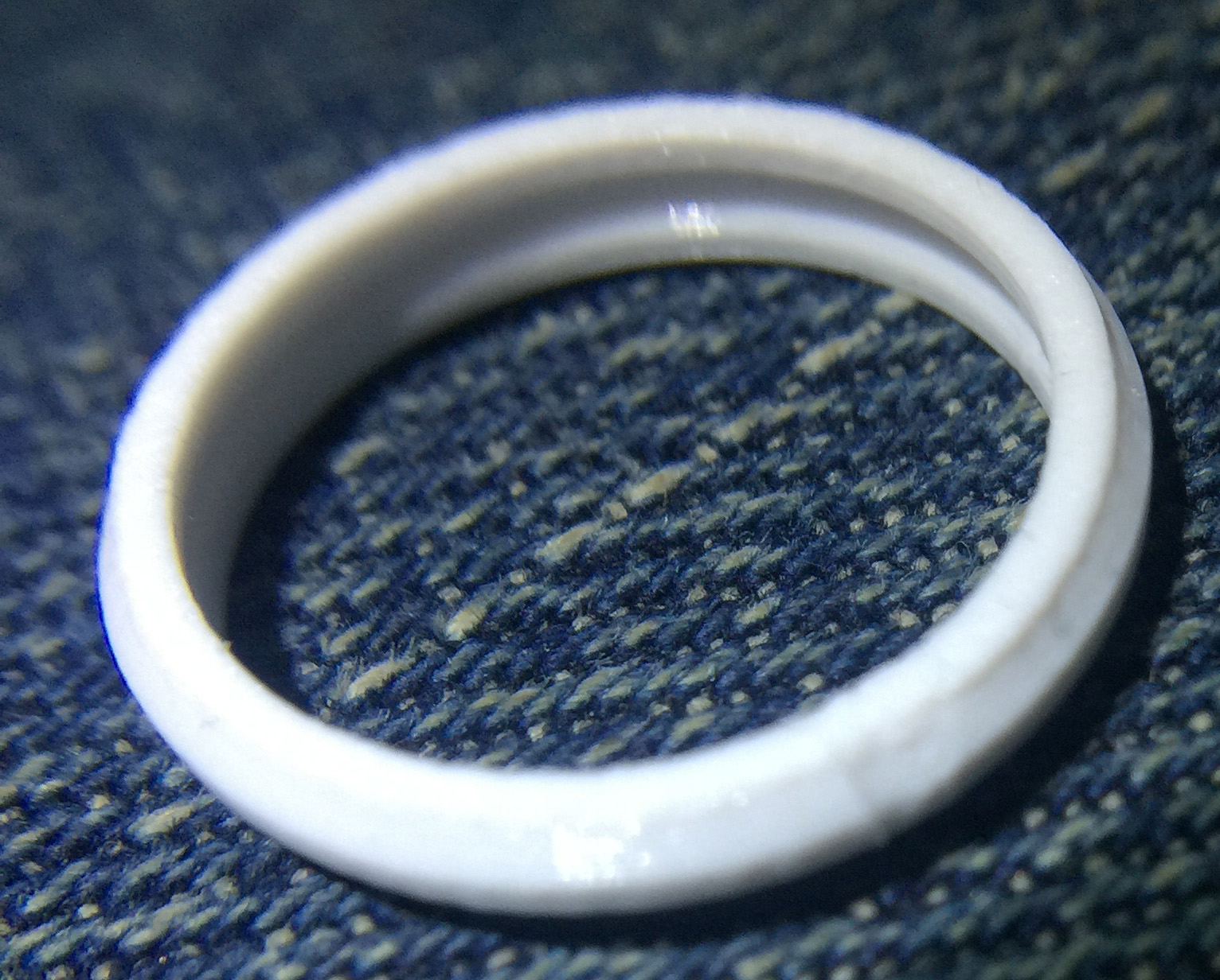

Unknown Surface Mount Component
    replied
    Re: Unknown Surface Mount Component
    if something goes awry you risk the 18650 turning the light into a pipebomb - no thanks.
    conductivity would need to be pretty miraculous too - your pushing 1-3A through it and dont want any volt-drop.
    Leave a comment:
  • EasyGoing1
    replied
    Re: Unknown Surface Mount Component
    Originally posted by stj
    still probably not strong enough to have an 18650 rammed into it for years.
    And the beauty of 3D printing is you can just print another one if something goes awry ... or print 10 and throw em in a drawer...
    I'm not sure how strong the conductive PLA is, since it is doped with metallic particles, I would assume it's stronger than standard PLA ... ABS is stronger yet, but I don't print with ABS cause its a pain in the ass. :-)
    Leave a comment:
    replied
    Re: Unknown Surface Mount Component
    still probably not strong enough to have an 18650 rammed into it for years.
    i think the simple answer is to strip all the parts off the 20mm board and fit the 17mm one against it.
    i'll try it when i get a couple.
    Leave a comment:
  • EasyGoing1
    replied
    Re: Unknown Surface Mount Component
    Originally posted by stj
    wont work, it has to be electrically conductive to carry the negative rail.
    it also has to support the spring pressure against the battery.
    i also doubt it's a good idea to use anything that softens if it gets hot!!
    a machined aluminium ring may work, i was just going to mount the 17mm board against the 20mm one.
    They make conductive PLA, and it only softens around 190C
    Leave a comment:
    replied
    Re: Unknown Surface Mount Component
    wont work, it has to be electrically conductive to carry the negative rail.
    it also has to support the spring pressure against the battery.
    i also doubt it's a good idea to use anything that softens if it gets hot!!
    a machined aluminium ring may work, i was just going to mount the 17mm board against the 20mm one.
    Last edited by stj; 11-10-2018, 07:09 AM.
    Leave a comment:
  • EasyGoing1
    replied
    Re: Unknown Surface Mount Component
    Originally posted by stj
    what pisses me off is all the cheap lights use 20mm boards, but all the interesting drivers are 17mm.
    I just whipped this up on the 3D printer in about 10 minutes ... should work as an adapter ... if you want, show m the particular 17mm board you're interested in, I'll order it and I'll make an adapter that works and if you have access to a 3D printer, ill send you the file, if not, I'll print up a bunch of them and mail them to you.
    Leave a comment:
    replied
    Re: Unknown Surface Mount Component
    Originally posted by sam_sam_sam
    Please post your solution when you find one for this problem because I have the same problem
    that's easy,
    the higher end drivers have programable modes.
    options for current <<< select the right board!
    https://www.banggood.com/Convoy-Flas...p-1088825.html
    Last edited by stj; 11-09-2018, 06:57 AM.
    Leave a comment:
    replied
    Re: Unknown Surface Mount Component
    Originally posted by stj
    there are times when too much brightness is a problem.
    that's why i'm looking at the newer drivers that can do 5%, 30%, 50%, 100% or other combinations.
    Please post your solution when you find one for this problem because I have the same problem
    Leave a comment:
  • EasyGoing1
    replied
    Re: Unknown Surface Mount Component
    Originally posted by stj
    exacty, however - there are times when too much brightness is a problem.
    that's why i'm looking at the newer drivers that can do 5%, 30%, 50%, 100% or other combinations.
    the "epilepsy"strobe & SOS modes dont interest me.
    what pisses me off is all the cheap lights use 20mm boards, but all the interesting drivers are 17mm.
    I had not noticed that ... sounds like a job for a 3D printer ;-)
    By the way ... my order was a whopping $3.60 ... I ordered some more LEDs too ... I have no idea how they turn a profit... and strobe modes on a flashlight .... they've had them on flashlights since before I was born and in all my 48 years I have never once heard anyone say "Boy that ended up being a handy feature..." I wonder how many unnecessary clicks that feature has forced on innocent push buttons since the beginning and I wonder how that would equate to MTBF wear and tear to the point of failure ... in other words ... I wonder just how many meaningless pushbutton deaths we can attribute to that worthless annoying feature.
    Last edited by EasyGoing1; 11-08-2018, 12:21 PM. Reason: By the way...
    Leave a comment:
    replied
    Re: Unknown Surface Mount Component
    exacty, however - there are times when too much brightness is a problem.
    that's why i'm looking at the newer drivers that can do 5%, 30%, 50%, 100% or other combinations.
    the "epilepsy"strobe & SOS modes dont interest me.
    what pisses me off is all the cheap lights use 20mm boards, but all the interesting drivers are 17mm.
    Last edited by stj; 11-08-2018, 11:21 AM.
    Leave a comment:
  • EasyGoing1
    replied
    Re: Unknown Surface Mount Component
    Originally posted by stj
    btw, i like cheap lights - gotta keep those 18650's in something!
    Ive never had a light that used 18650's ... I vape with my batteries but I always have a bunch laying around doin nothin ... and you can never have a flashlight that is TOO bright and always has juice!
    Leave a comment:
  • EasyGoing1
    replied
    Re: Unknown Surface Mount Component
    Originally posted by stj
    why 100 of them???
    also, i was trying to keep cost to the minimum so as not to have it reach the cost of a new light!!
    thats a good point ... ill stick with the 10
    Leave a comment:
    replied
    Re: Unknown Surface Mount Component
    btw, i like cheap lights - gotta keep those 18650's in something!
    Leave a comment:
    replied
    Re: Unknown Surface Mount Component
    btw,
    i have these in my collection.
    https://www.banggood.com/Wholesale-C...0-p-48482.html
    [gonna convert this to green]
    https://www.banggood.com/XANES-WT518...p-1194174.html
    https://www.banggood.com/XANES-1302-...p-1202115.html
    https://www.banggood.com/XANES-3506-...p-1194175.html
    [lol - gonna fit a 2800ma driver in it!!]
    and i'm waiting for this to arrive.
    https://www.aliexpress.com/item/4200...818422476.html
    Leave a comment:
    replied
    Re: Unknown Surface Mount Component
    why 100 of them???
    also, i was trying to keep cost to the minimum so as not to have it reach the cost of a new light!!
    Leave a comment:
  • EasyGoing1
    replied
    Re: Unknown Surface Mount Component
    I was going to get this item ...
    Leave a comment:
    replied
    Re: Unknown Surface Mount Component
    another option is to fit this to your existing board.
    https://www.banggood.com/Wholesale-1...s-p-63073.html
    Leave a comment:
    replied
    Re: Unknown Surface Mount Component
    https://www.aliexpress.com/item/10PC...913098686.html
    Leave a comment:
    replied
    Re: Unknown Surface Mount Component
    are you saying you want a link?
    btw, shipping is often much faster than you think.
    Leave a comment:
  • EasyGoing1
    replied
    Re: Unknown Surface Mount Component
    Originally posted by stj
    they are used in chinese lights in groups of upto 8, i'm sure there wont be a problem.
    <sarcasm> Thanks for turning me on to aliexpress.com ... BUDDY! </sarcasm> I think I wasted about 6 hours yesterday throwing crap in my cart that I knew I would never buy but I wanted a list to narrow down ... those prices are almost too good to be true - although I realize they make up for it in long shipping times ... and being on the site is like watching old re-runs of CHIPS ... just so ... klunky and old school in the layout. But addicting none-the-less ...
    Leave a comment:
    Surface Mount Fuses Fundamentals Datasheet
    TE Circuit Protection offers the widest selection of surface-mount fuses available for addressing a broad range of overcurrent protection applications. Helping to prevent costly damage and promote a safe environment for electronic and electrical equipment, our single-use chip fuses provide performance stability to support applications with current ratings from .5A up to 20A.
    TE Circuit Protection also offers the telecom FT600 fuse for telecommunications applications. This telecom fuse helps comply with North American overcurrent protection requirements, including Telcordia, GR-1089,...
    10-07-2024, 06:07 AM
    Microsoft Surface Book Surface Book 3 + Surface Dock 2 Hybrid (2-in-1) 3 Specification for Upgrade or Repair
    This specification for the Microsoft Surface Book Surface Book 3 + Surface Dock 2 Hybrid (2-in-1) can be useful for upgrading or repairing a laptop that is not working. As a community we are working through our specifications to add valuable data like the Surface Book 3 + Surface Dock 2 boardview and Surface Book 3 + Surface Dock 2 schematic. Our users have donated over 1 million documents which are being added to the site. This page will be updated soon with additional information. Alternatively you can request additional help from our users directly on the relevant badcaps forum. Please note...
    09-06-2024, 08:10 PM
    Microsoft Surface Book Surface Book 3 + Surface Dock 2 Hybrid (2-in-1) 3 Specification for Upgrade or Repair
    This specification for the Microsoft Surface Book Surface Book 3 + Surface Dock 2 Hybrid (2-in-1) can be useful for upgrading or repairing a laptop that is not working. As a community we are working through our specifications to add valuable data like the Surface Book 3 + Surface Dock 2 boardview and Surface Book 3 + Surface Dock 2 schematic. Our users have donated over 1 million documents which are being added to the site. This page will be updated soon with additional information. Alternatively you can request additional help from our users directly on the relevant badcaps forum. Please note...
    09-06-2024, 08:10 PM
    Microsoft Surface Book Surface Book 3 + Surface Dock 2 Hybrid (2-in-1) 3 Specification for Upgrade or Repair
    This specification for the Microsoft Surface Book Surface Book 3 + Surface Dock 2 Hybrid (2-in-1) can be useful for upgrading or repairing a laptop that is not working. As a community we are working through our specifications to add valuable data like the Surface Book 3 + Surface Dock 2 boardview and Surface Book 3 + Surface Dock 2 schematic. Our users have donated over 1 million documents which are being added to the site. This page will be updated soon with additional information. Alternatively you can request additional help from our users directly on the relevant badcaps forum. Please note...
    09-06-2024, 08:10 PM
    Microsoft Surface Book Surface Book 3 + Surface Dock Hybrid (2-in-1) 3 Specification for Upgrade or Repair
    This specification for the Microsoft Surface Book Surface Book 3 + Surface Dock Hybrid (2-in-1) can be useful for upgrading or repairing a laptop that is not working. As a community we are working through our specifications to add valuable data like the Surface Book 3 + Surface Dock boardview and Surface Book 3 + Surface Dock schematic. Our users have donated over 1 million documents which are being added to the site. This page will be updated soon with additional information. Alternatively you can request additional help from our users directly on the relevant badcaps forum. Please note that...
    09-06-2024, 08:10 PM
