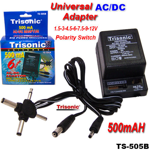

        Try to find a voltage you like for the fans, say 9V and then use a (transformer-based) wall adapter.
        But these have poor regulation and 9V usually gives 11V, so nice to switch to 6V. Or use a resistor to lower speed. The Noctua and Scythe fans are very good I find.
        Multi-voltage (transformer tap switch) AC adapters are harder to find now, there are switching power supplies that do the same. Pic is from fleabay.
        I'm against using SMPS wall-adapters here because they make a lot of RFI which can get into the audio gear. PWM fan controllers also are noisy.
