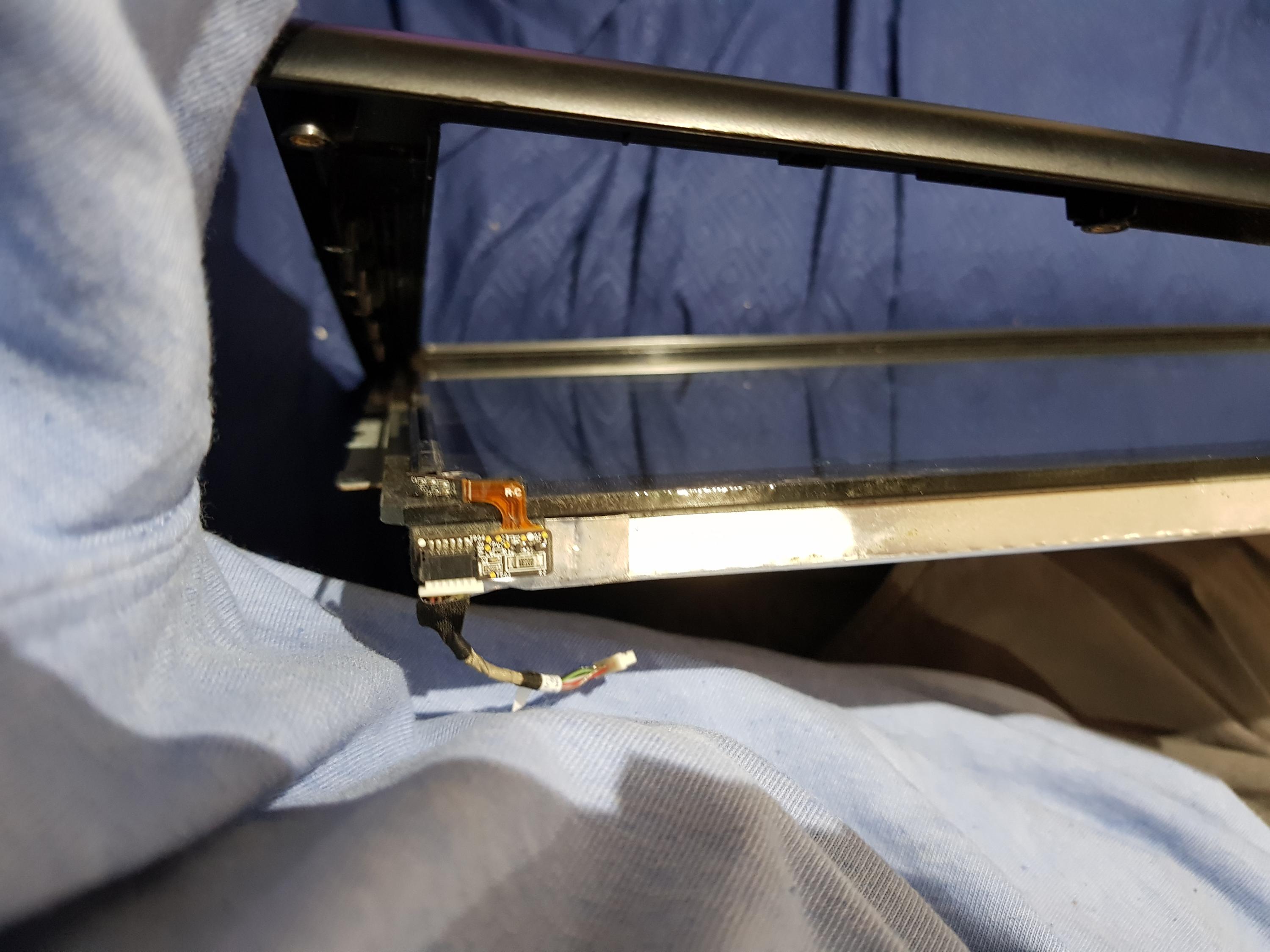

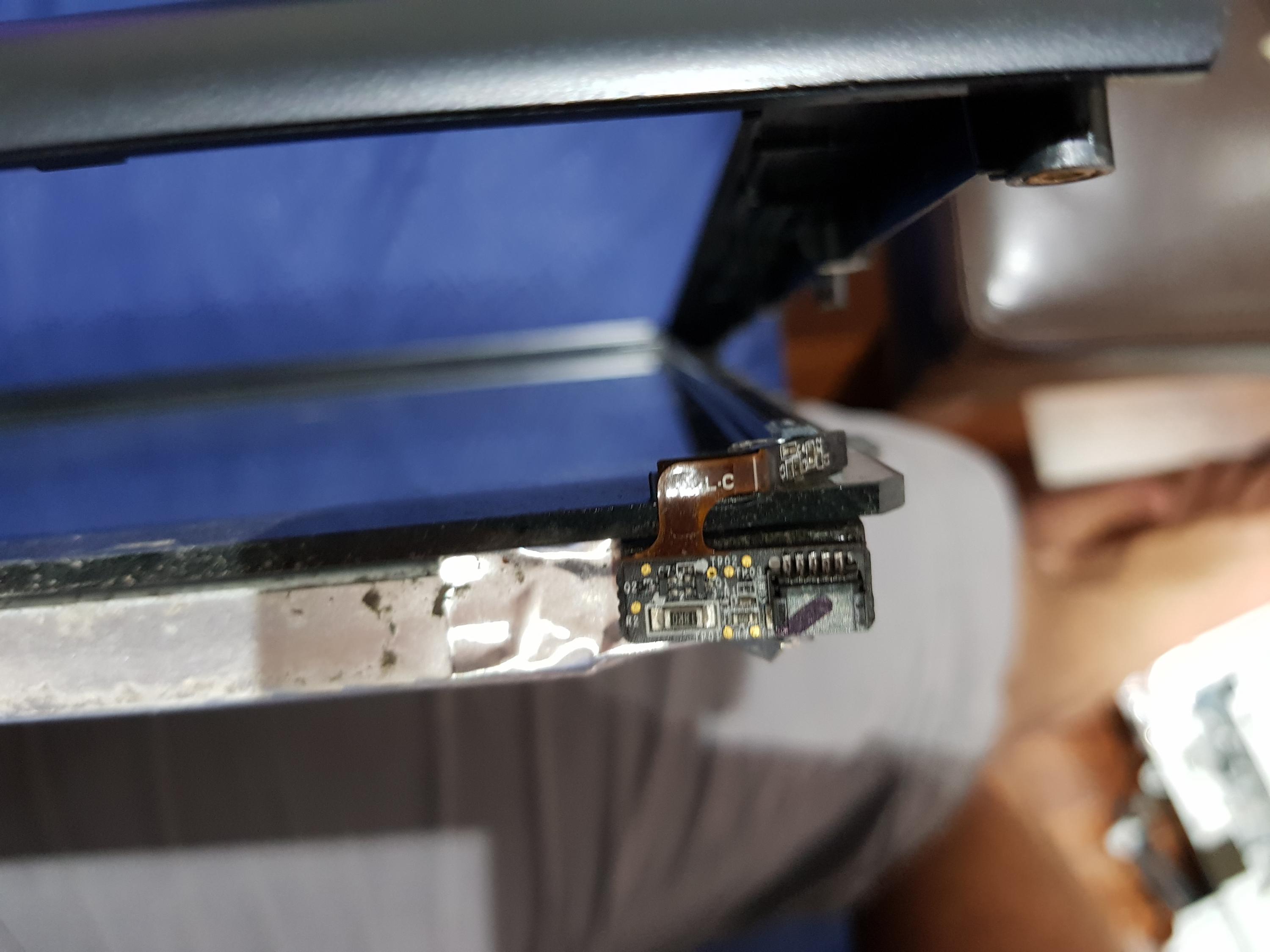

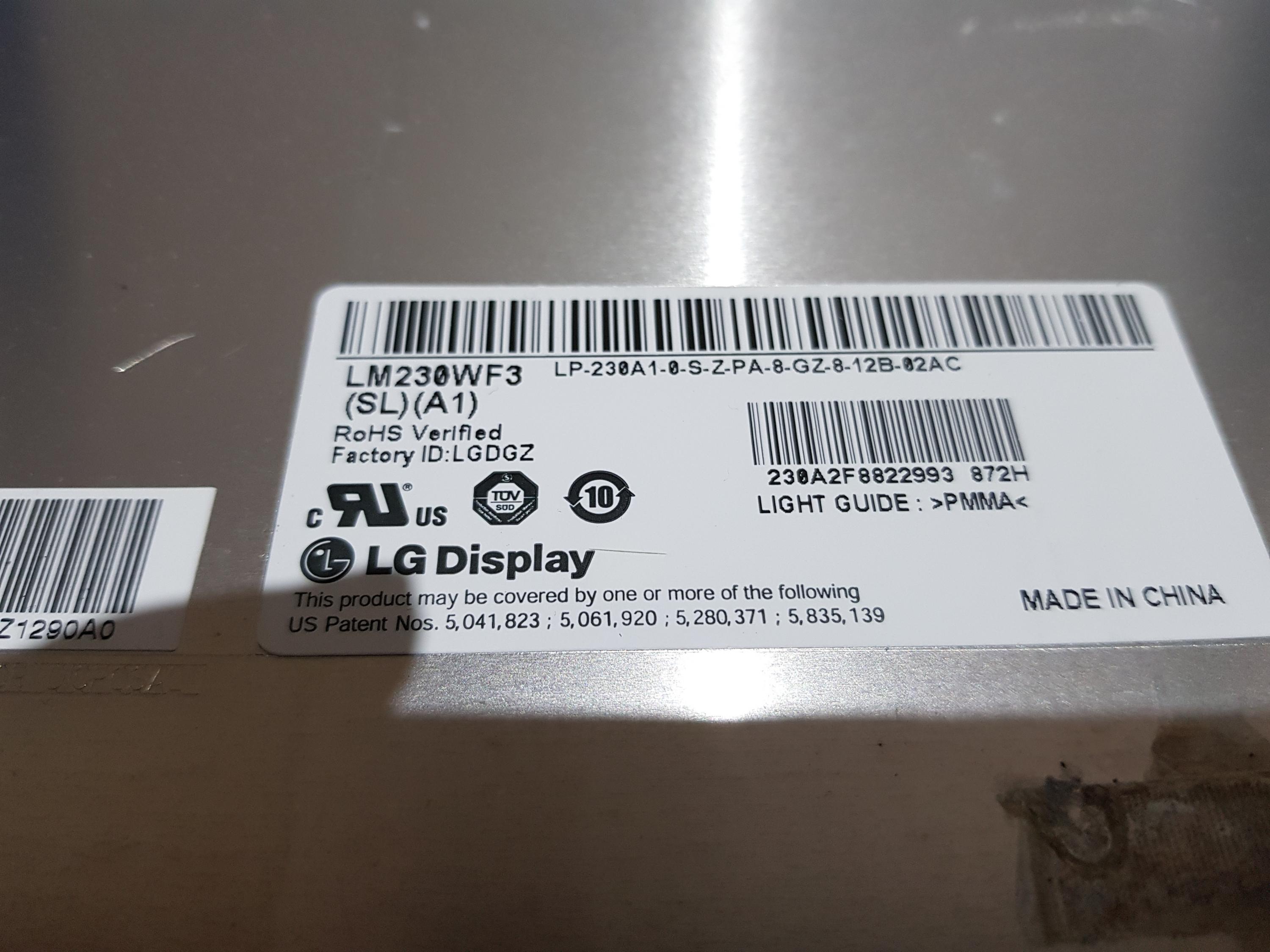

Hi, I have a HP touchsmart 610 display and touchscreen and am wondering if it is possible to DIY the touch panel and display for use on a desktop PC? Thanks
Use HP touchsmart display and touchscreen on PC
Re: Use HP touchsmart display and touchscreen on PC
it needs a controller board like data boards we see inside desktop LCD/LED monitors. If you want to buy it, search this: lm230wf3 controller
If you think it does not worth this conversion, you can sell it to anyone who needs it for his/her Allinone PC. or you can find the original mainboard of this Allinone PC.Last edited by caspian; 03-05-2018, 02:22 AM.
