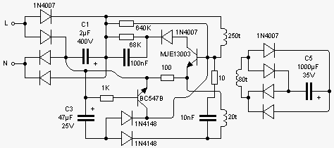

    Hola todos, USB chargers start to fill up your drawer, How can we use it?
    A dozen USB chargers in the lab: Apple is very good, but not quite the best
    http://www.righto.com/2012/10/a-doze...-apple-is.html
    Apple iPhone charger teardown: quality in a tiny expensive package
    http://www.righto.com/2012/05/apple-...n-quality.html
    Cheapest SMPS Circuit Using MJE13005
    http://www.homemade-circuits.com/201...-mje13005.html
    I try to use as a Poorman's LED tester power supply from 5v boot up to 300v is that possible?

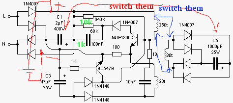

    I swapped input to output transformer and change resisters above pic2. By input 3vDC best I got is 27vDC ?
