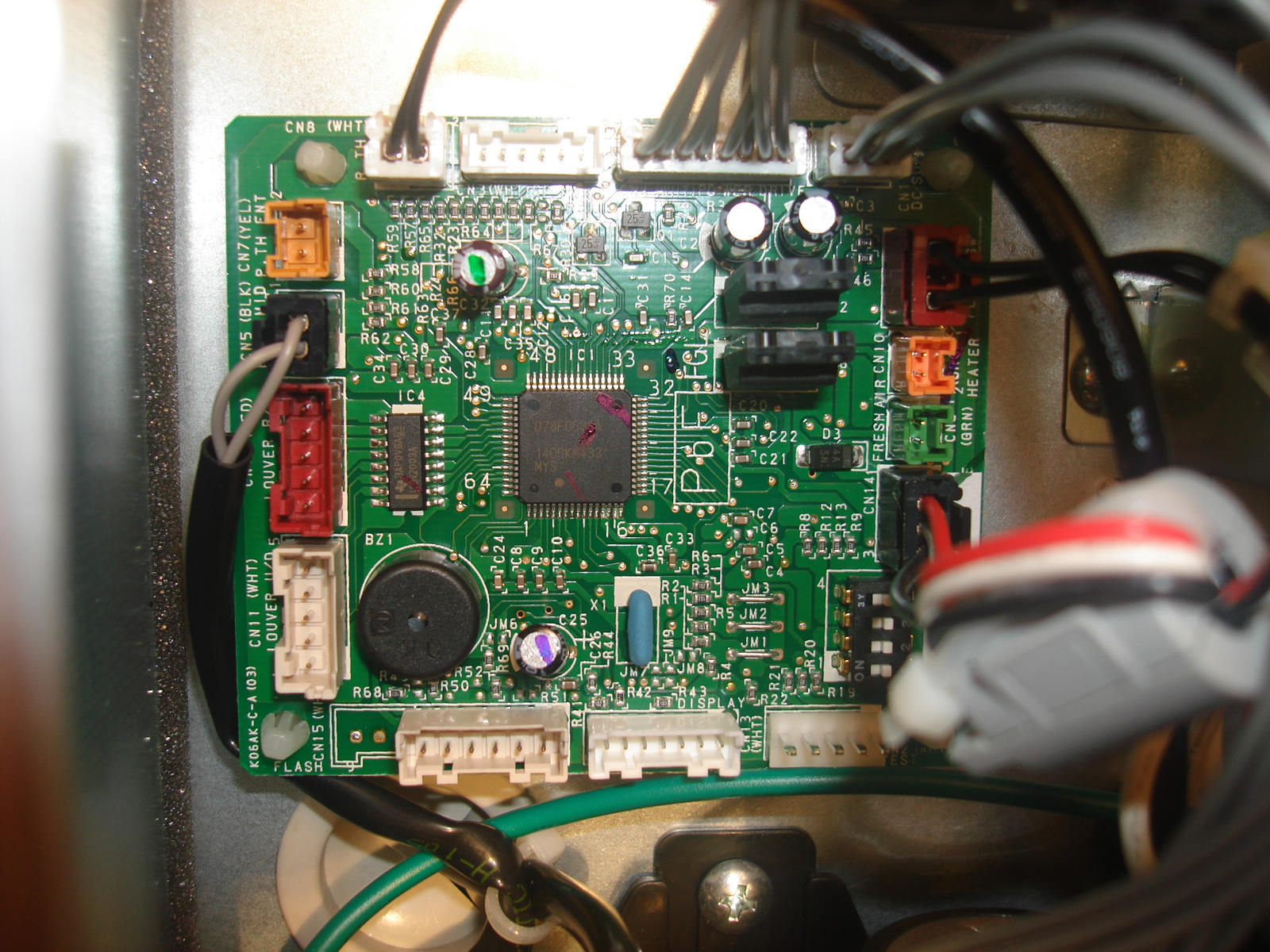

    Hi Folks!
    Does anyone recognise the type of connections used on this board. It's from a slim duct Fujitsu air conditioner. They might be of a type exclusive to Fujitsu, but I can't any info on them. I really need to make cables for these if possible for BMS, the only lead is they might be 'type C' connections.
    Anyone recognise them??
    Many Thanks

    there are 3 types there,
    the one lower right is JST NH series.
    i'm not sure about the other 2, but they may be JST aswell.

      Thanks, I'm after CN13 which is the 7 pin bottom middle white in this picture.
      I might just be better off ordering a Fujitsu cable. But paying for 2 of the things at 5 meters long when I only need 5 inches would be annoying (not that any suppliers have come back to me).

        Stj, Thanks for the JST lead (excuse pun)
        It turns out they are JST PA Series!
        http://uk.farnell.com/jst-japan-sold...713-pd-r2-acce
