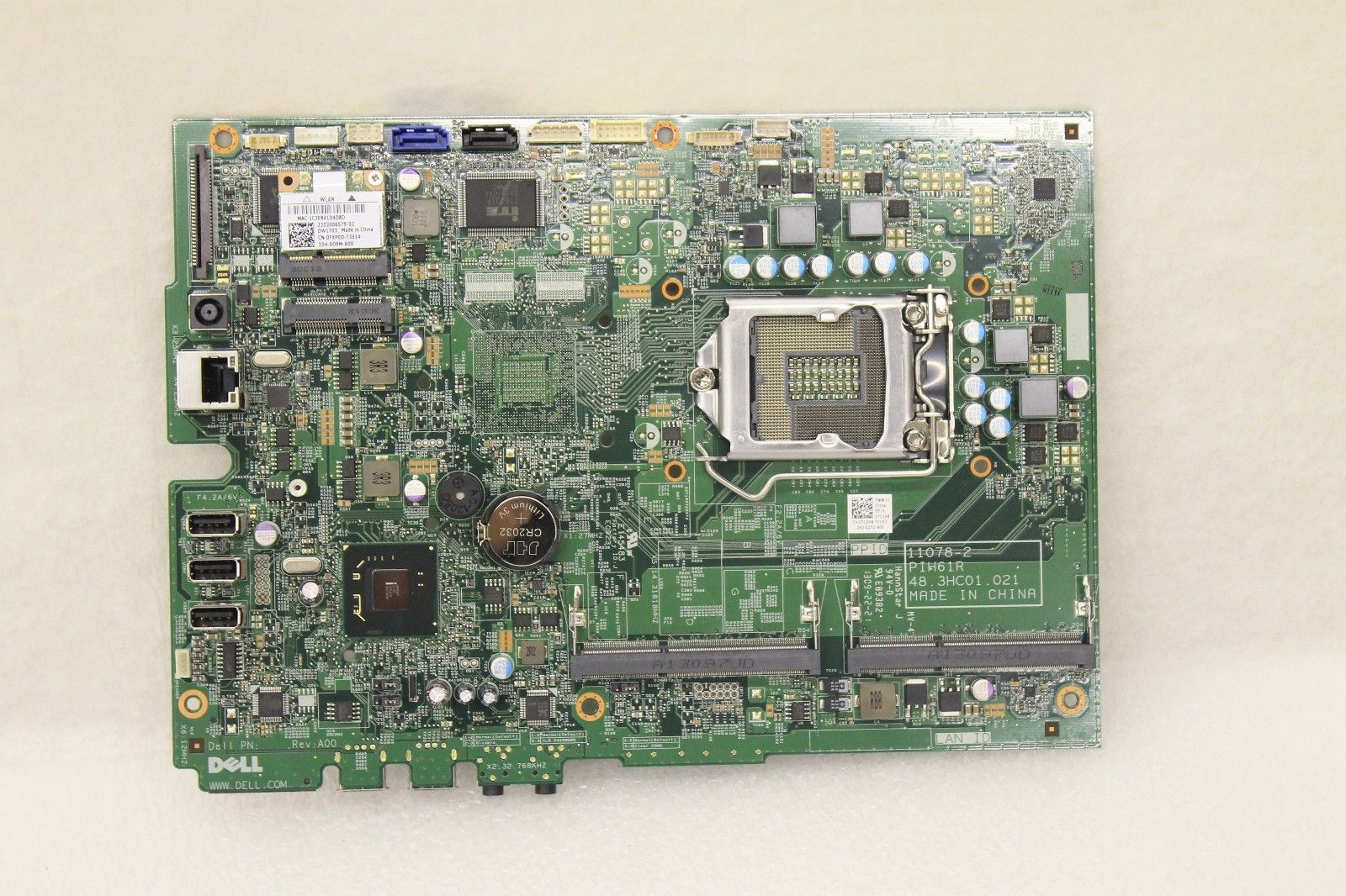

    Dell Inspiron One 2020 Eagleton Motherboard 7C0H8 07C0H8
    I bought this board.
    I am considering building a PC around this. The biggest problem (apart from my miserly endowment of cranial matter), is getting video from it. It has no VGA or HDMI out. I guess I have two options:
    1. Mini PCI-E to PCI-E adapter + PCI-E x1 GPU
    2. Get video from LCD connector
    Be there an amateur-friendly guide on measuring video signals so I can cipher the LCD connector? Or should I leave such to grown-ups who actually own oscilloscopes?
  • hardwareguy
    • Jun 2006
    • 405
    Re: Dell Inspiron One 2020 Motherboard Build
    Get video from the LCD connector. Find out what kind of LCD it had and that will lead you to the interface and very likely, the pinout.
