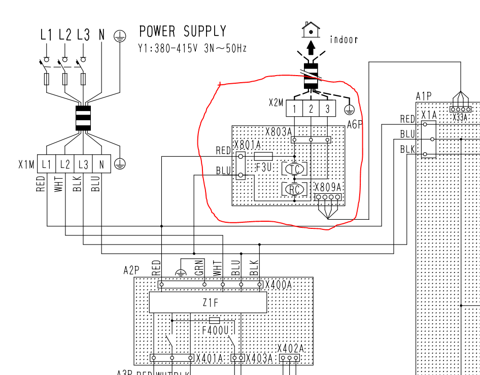

                    As you can see there is no details of the MCU or power module or whatsoever on the block diagram, however other than the 3F filtering it hosts an MCU with communication interfaces and driving a bunch of relays.
                    If I power up through Phase 3 (via L3A & Neutral) it powers up the mentioned HC0303-1B.
                    On heat camera the corner of the module starts heating up a bit, ~60 V DC appears on the primary electrolytic cap, however on the secondary side no power appears.
                    I traced the (presumably) output line of the module and the 7805 input line and they meet in an optocouple network what I have not yet analyzed further as the board is conformal coated (maybe it is the time for taking an acetone bath )

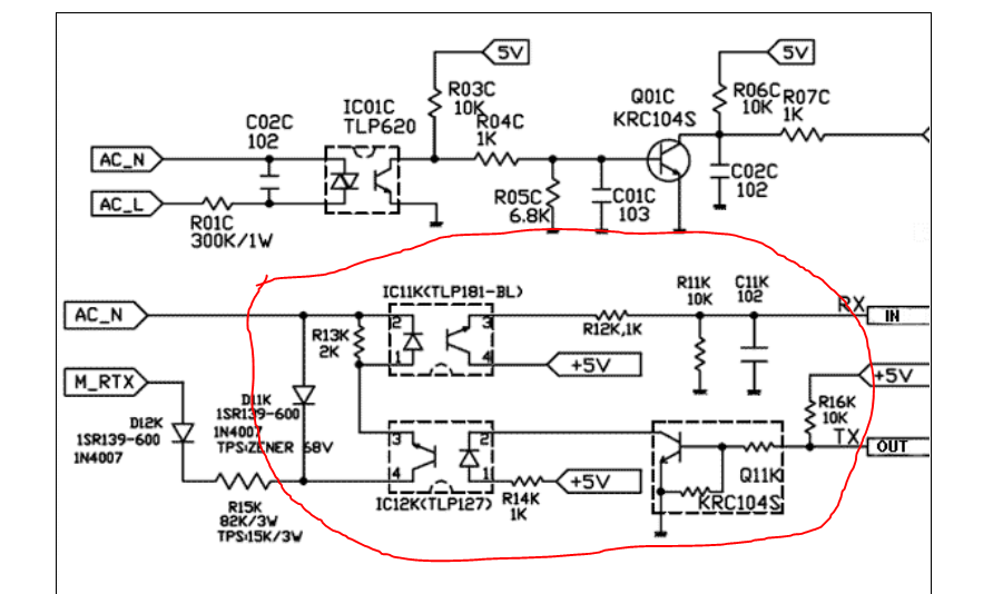

                      This switching board does not have a power supply, it is powered from another one, where the pulse transformer is located.
                      And the HC0303-1B module for switching (interconnect communication data exchange), if you look closely at this module from the back, you will see two optocouplers filled with compound.
                      You can see from the board that these four pins go to the controller, these are Tx and Rx, that is, input and output, and through this module through optocouplers it is supplied to high voltage and along this line S and N control commands go to the internal unit, and there is also such a module (or can be assembled using discrete components).

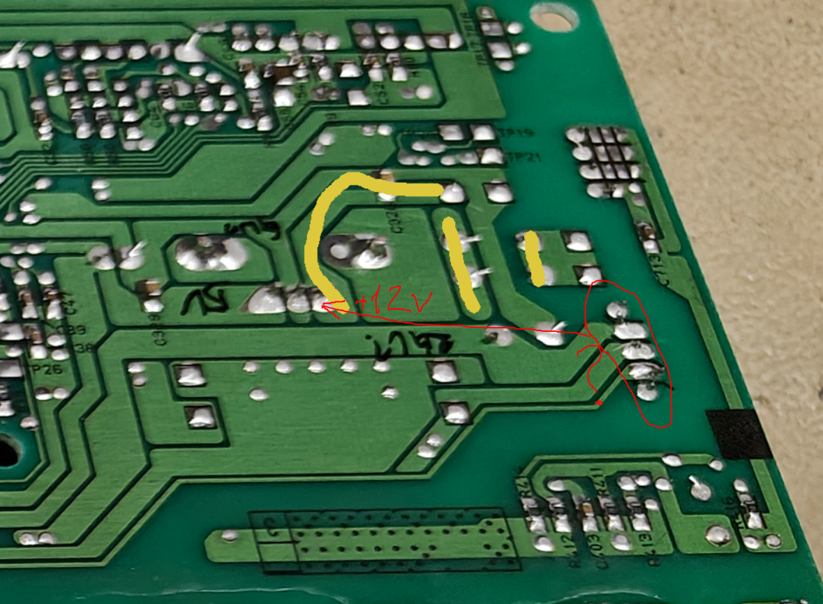

                        Look at the 12v input supplied to this connector.

                          Here is a rough diagram of this module, which you consider to be a power supply converter.
                          • martonmiklos
                            • Jun 2021
                            • 20
                            • Hungary
                            Ah I see the point now, many thanks for the explanation!
