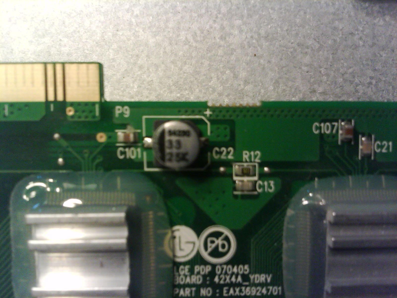

    identify surface mount capacitor
    i know, i know. sorry for the stupid question. still learning...

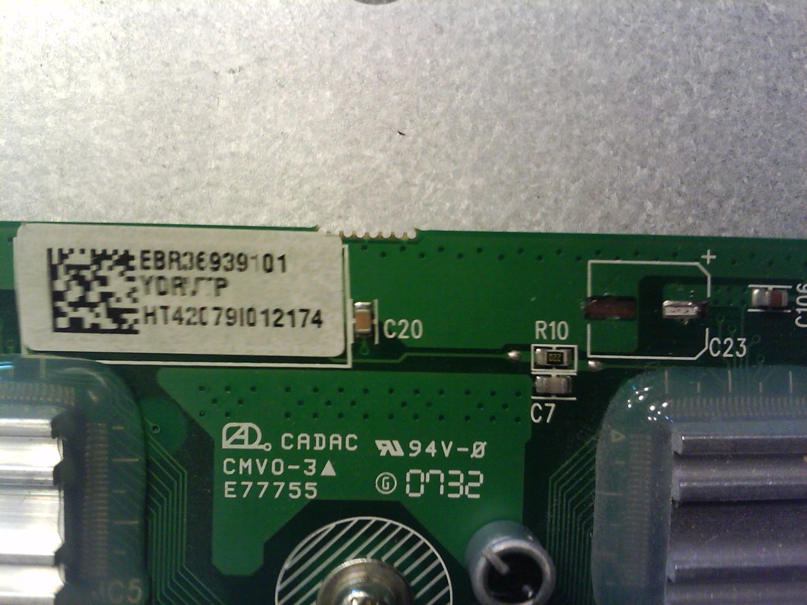

    anyhow while replacing a ysus hybrid chip i accidently pulled off a surface mounted cap on the ydrvtp board second picture c23, dont ask lol.
    i really dont know a thing about reading them and i tried google and it wasnt my friend
    picture attached. a digikey part number would be fantastic.
    thanks so much in advance.
    tim
  • saturnknts
    • 8
    Re: identify surface mount capacitor
    i'm just looking for the value not the particular brand. sorry didnt have macro on phone. numbers are 33 and 25k.
    • severach
      • Aug 2007
      • 1055
      Farad and voltage values are numbered so you can't get them reversed. 33uf 25v which is about right for a can that size. All I see wrong with the original capacitor is that a lead is broke off. Since you already need to mend a trace you can just use a jumper to the damaged lead.
