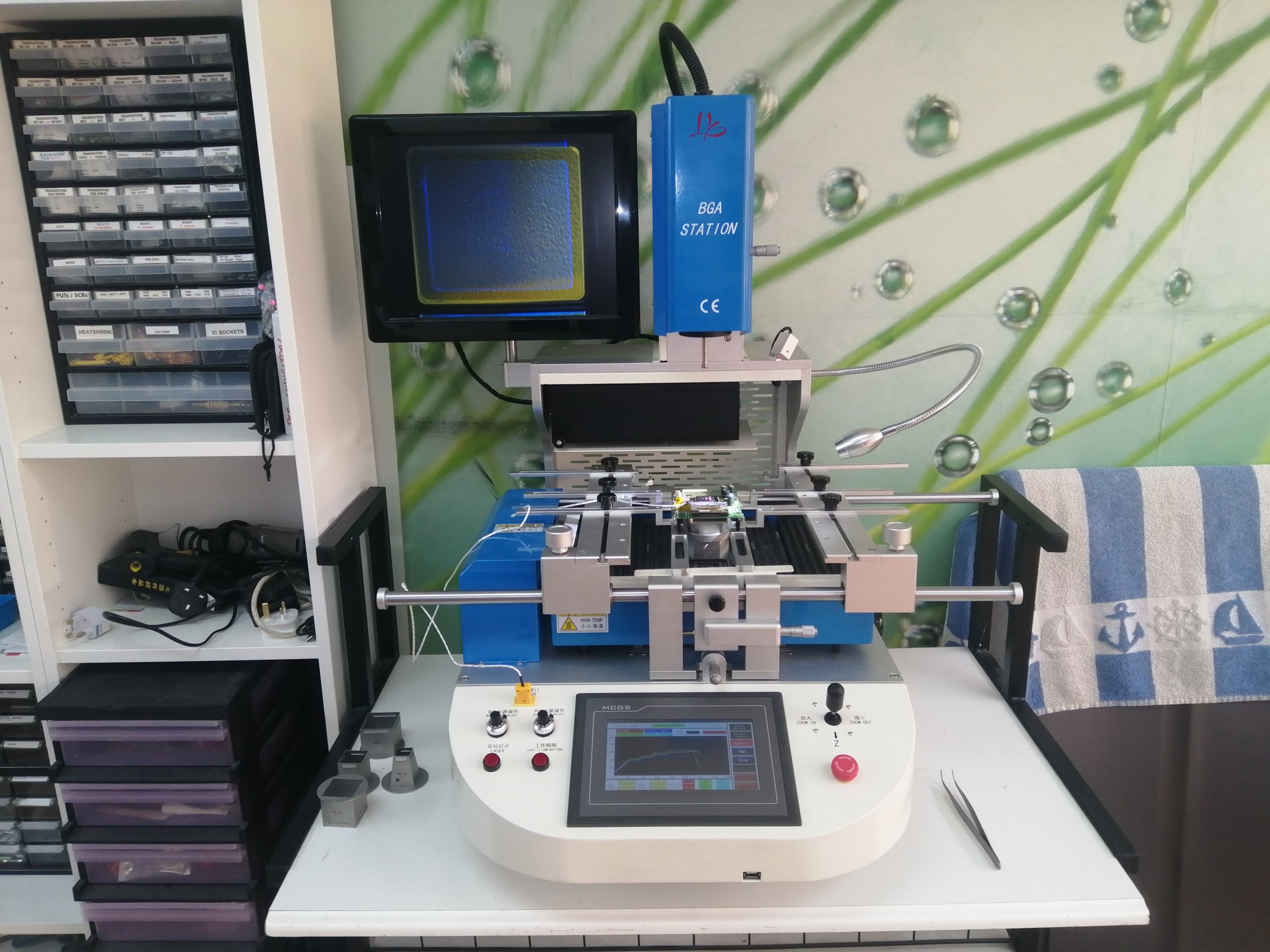

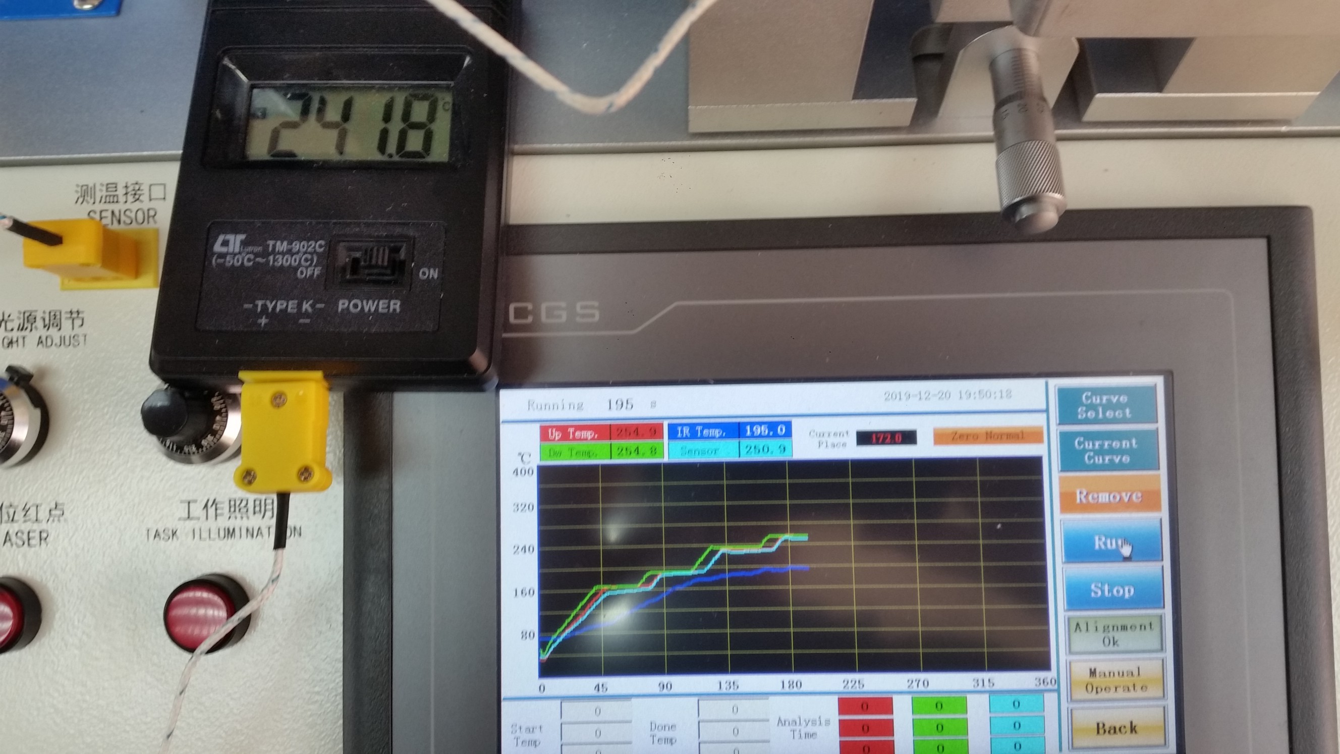

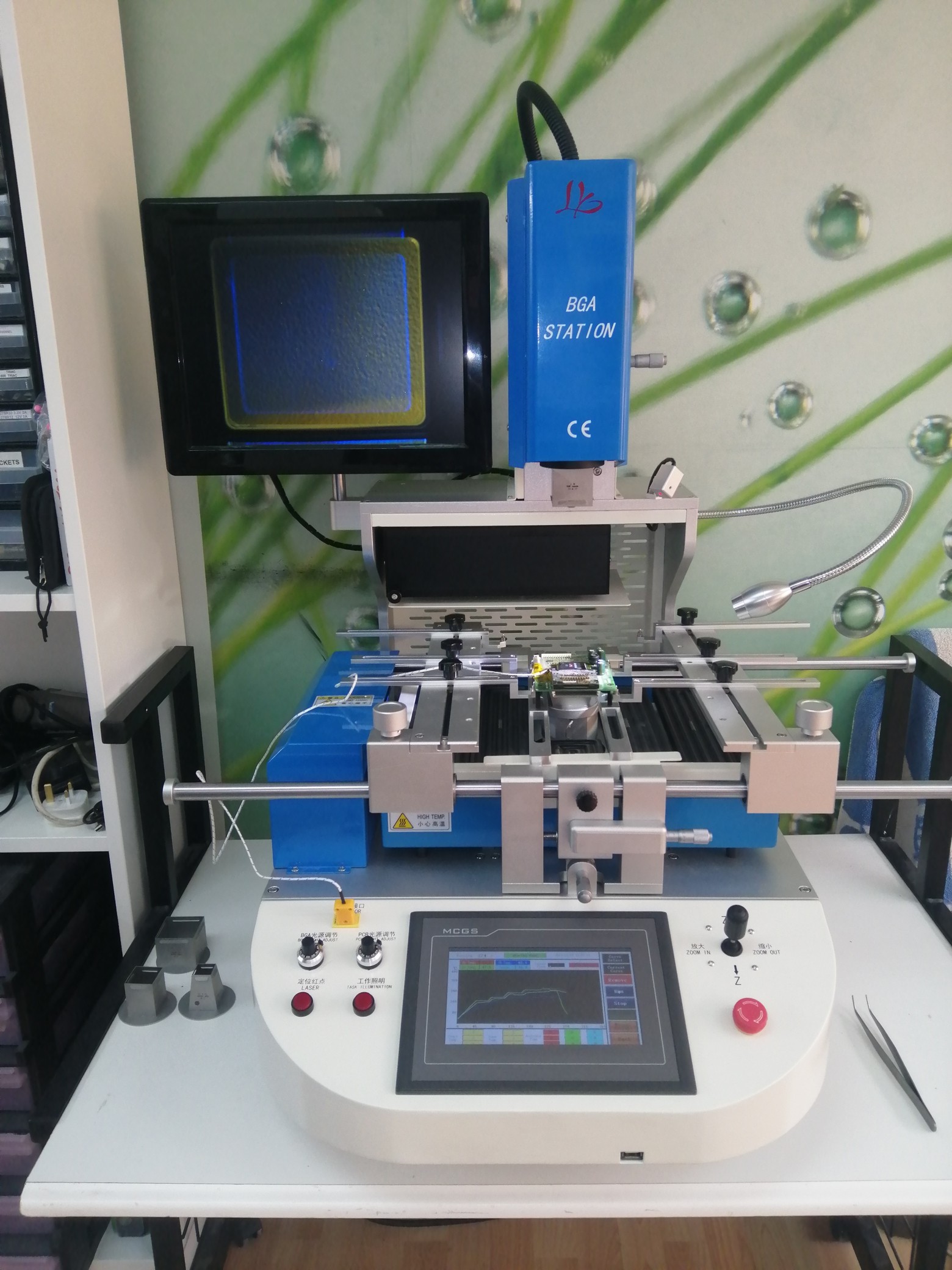

    Hi guys so the BGA rework station finally arrived yesterday.
    I came very well packed but without any instructions. I had to refer to a couple of videos showing these machines working on youtube to figure out exactly which bit went where, but now I have it all put together
    I did ask the seller for a user manual yesterday and today I have an English user manual PDF for the LY G720 in my email

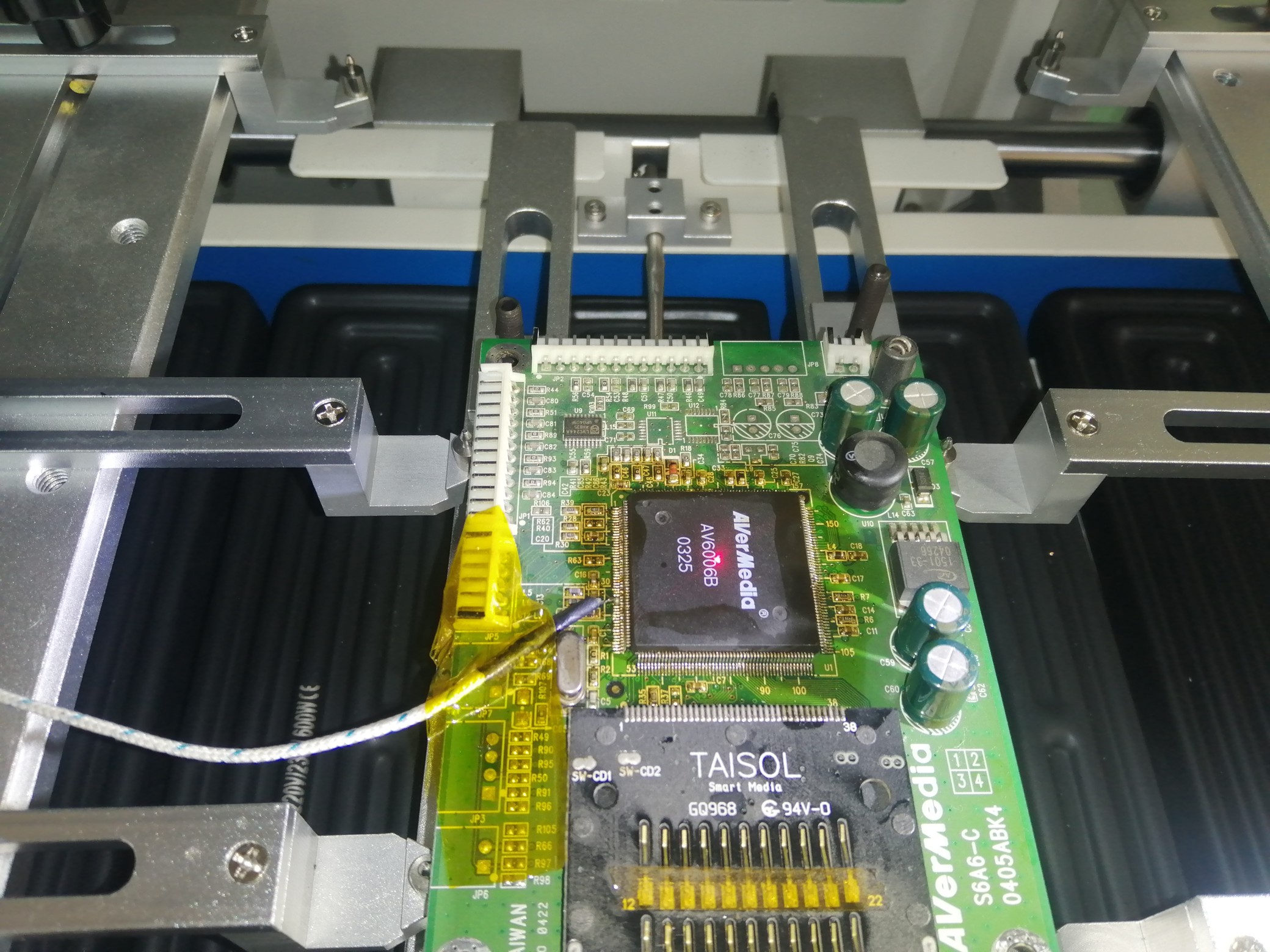

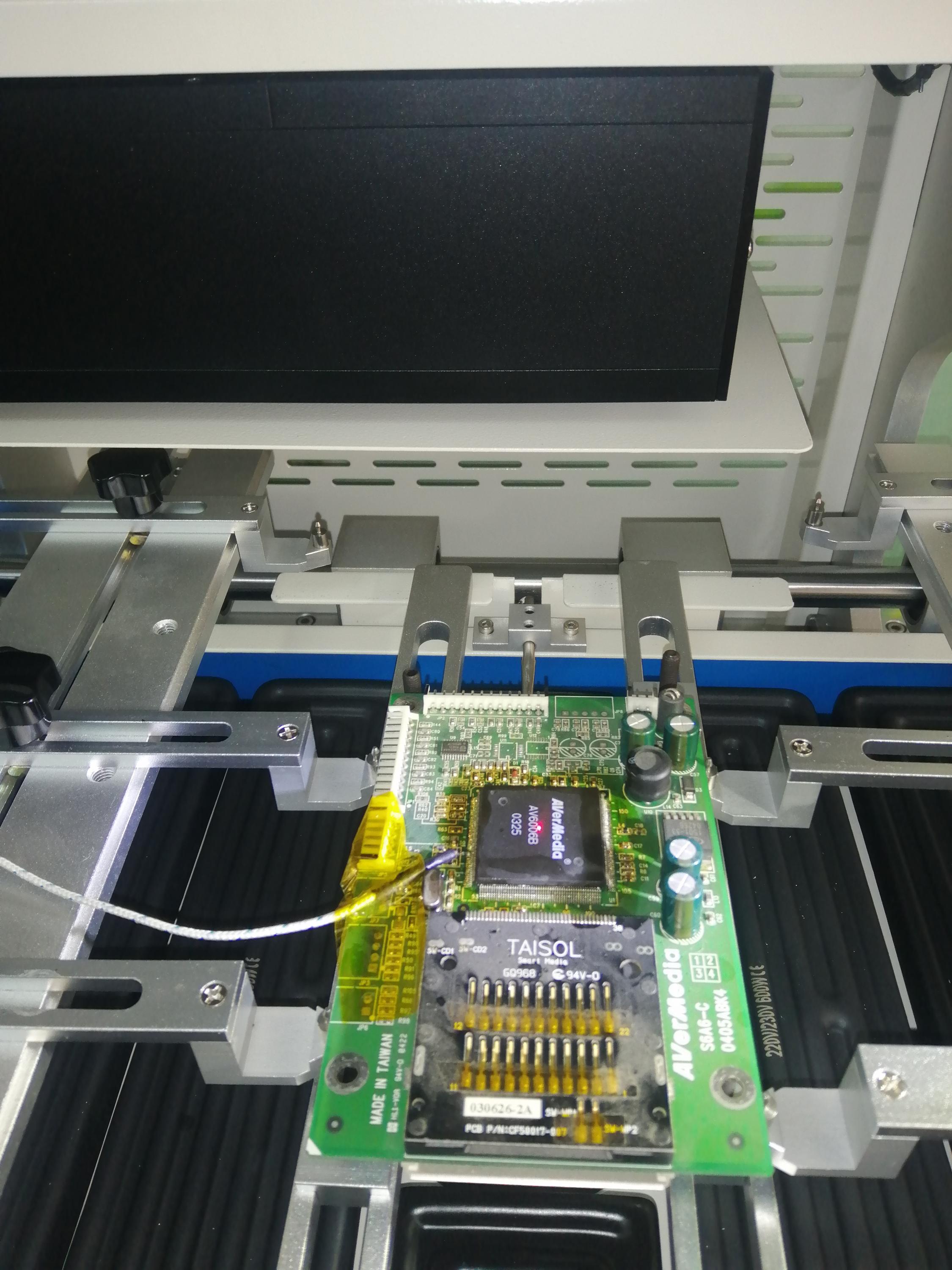

    It looks a nice well built machine. I have played around with some scrap boards with BGA and QFP chips on them but so far I haven't managed to unsolder anything. I don't think there is anything wrong with the machine I think it is something wrong with me lol
    It came with about a dozen preloaded profiles. Some have chinese names but others such as Leaded 1 2 and 3, Unleaded 1 & 2 seem fairly obvious

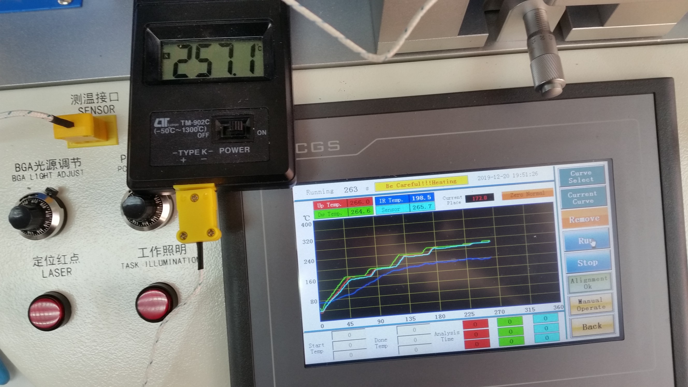

    The problem I am finding is that the solder isn't melting even though the thermo-couple tells me the temperature is high enough for Lead Free to liquify
    Here's a few pics, and a video I've made of the machine in operation and showing what is going wrong
    Can someone point me in the right direction to fix this?

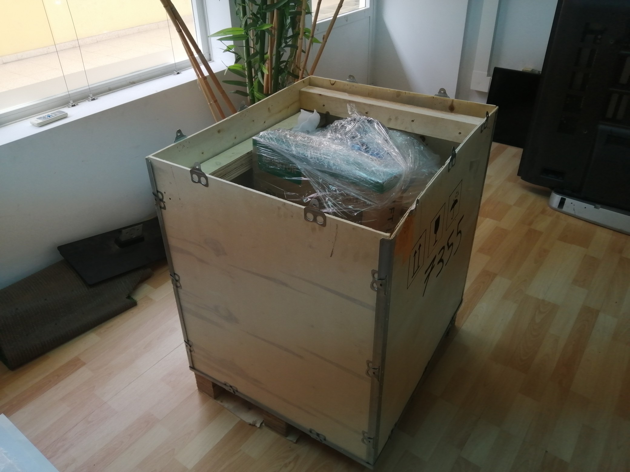

    This is how it came packaged!

      Verify the temperature with a secondary probe and device.
      Is the solder liquefying and the Winbond is glued down ?

        Re: BGA Station - having some problems with profiles
        Hi diif
        I've got two separate temperature meters and thermocouples, I'll try that tomorrow.
        No the solder did not look like it had liquified at all which is what is puzzling me. I accidentally cut the video recording off when I started poking at the QFP with my tweezers so you didn't see it - but the little discrete SMDs around the chip were still soldered solid as well.
        What do you think of the way the profiles drop the temperature during the last phase so the sensor near the chip drops by about 10C just before the vacuum pickup kicks in. Is there some reason for that?
        I browsed a few different profiles on the machine and they all seemed to be set to do that, like it's normal.
        I've attached the instruction manual pdf. It has examples of 'commonly used BGA profiles' at the end. Maybe that info will be useful to some folks here to use with other BGA stations
        I've tried a BGA chip on an old satellite receiver PCB as well as that QFP. It would be unlucky if both were glued down I think.
        I can't modify the profiles at the moment - I realised I need to log in as admin on the BGA machine and there is a password which I don't have. I've asked the seller for that but given the time difference it will most likely be tomorrow before I have that.

          No idea why the bottom hater drops off, incorrect programming of the profile perhaps ?

                Did you verify the K thermocouple is accurate with a secondary device/probe?
                You could try running a profile with a piece of leaded solder placed on the PCB. You'll be able to see what temperature it melts at which you can verify against its data sheet.

                  Hi guys
                  I tried this morning with a separate thermocouple and temperature meter. My cheapo meter actually read about 10C higher than the built in one, but the difference was consistent. Possibly the difference was due to the different placement of the two thermocouples?
                  Anyway today I decided to try a different preset profile - Lead Free 2
                  And this one works! So far I have removed a couple of BGAs (28x28mm) and a 30x30mm
                  QFP
                  I also worked out a couple of other things about the machine. Here is another video. Unfortunately I managed to put my finger over the phone microphone for a minute or two but I wasn't saying anything important at the time lol
                  So far it seems this machine is fairly easy to use, just by selecting the built in profiles.
                  To be honest this is proving far easier than I expected.
                  But I only tried component removal so far - maybe soldering components back on is more difficult.

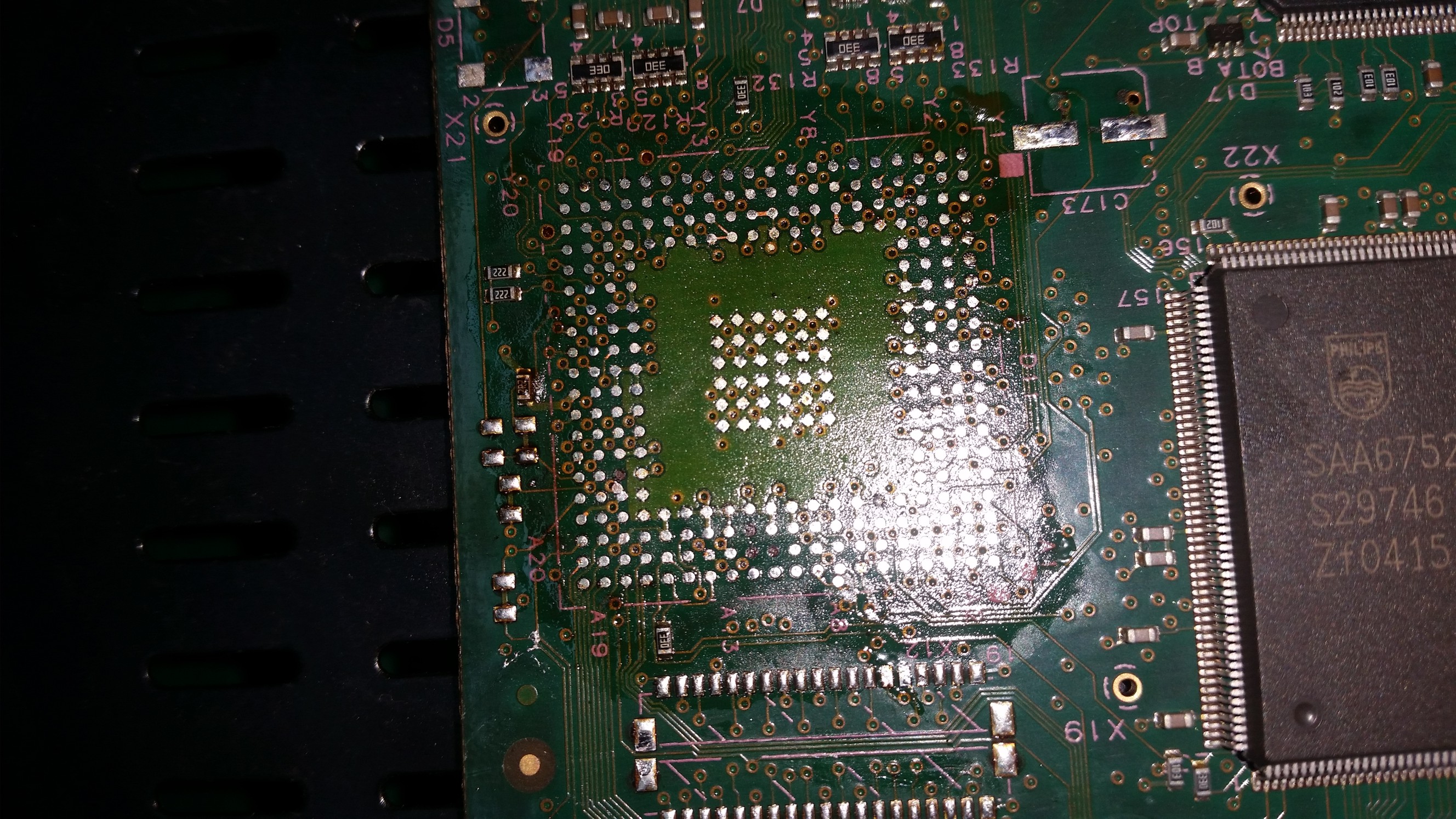

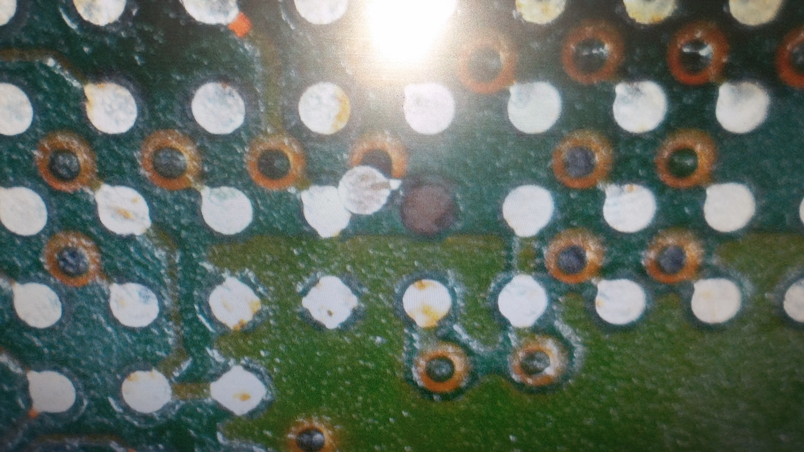

                    Evidentally my technique for cleaning all the old solder off the PCB under the BGA needs some improvement.
                    On the first one I tried I wondered if the machine had lifted these pads so I looked at the BGA chip under the microscope and the missing pads were not attached there.
                    On the second one I checked everything with the microscope first before cleaning the old solder and it all looked OK until I removed the excess solder from the PCB and I had managed to bend one track/pad over backwards on that one, though I didn't actually lift any pads clean off the board.
                    I'm using a technique I've seen on the internet - cutting a small length of desolder braid 1-2cm long, dipping it in rosin, then sweeping it around the PCB with a chisel tip on my soldering iron. I obviously need more practice or a better way of doing this.
                    Maybe my solder iron is set to the wrong temperature, or I need to use the preheater with the iron

                      Add flux then push a nice ball of leaded solder around the pads, ideally without the tip touching the board. Remove the ball with your iron then use decent braid.

                        Any particular braid recommended? I thought they were all pretty much the same as. Especially when dipped in rosin before use. The braid I have now is Servisol. But I'm happy to try something different.

                          No, braids are not created equal. I use Chemtronics, it's pre fluxed and is non scratchy like some of the cheap braids.
                          I've usually clear the old solder whilst the board is still hot and on the rework station. The less thermal cycles the better IMO.
