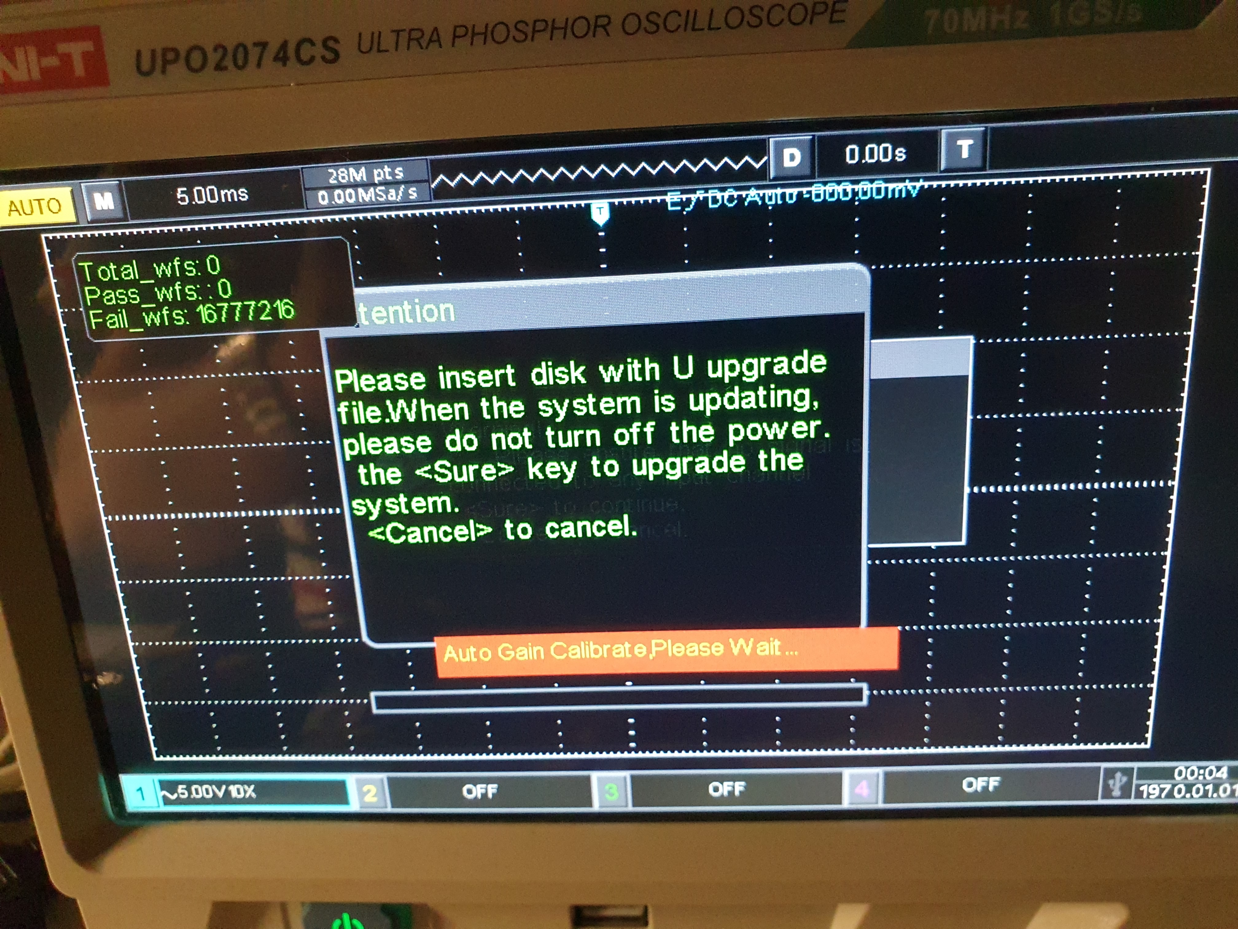

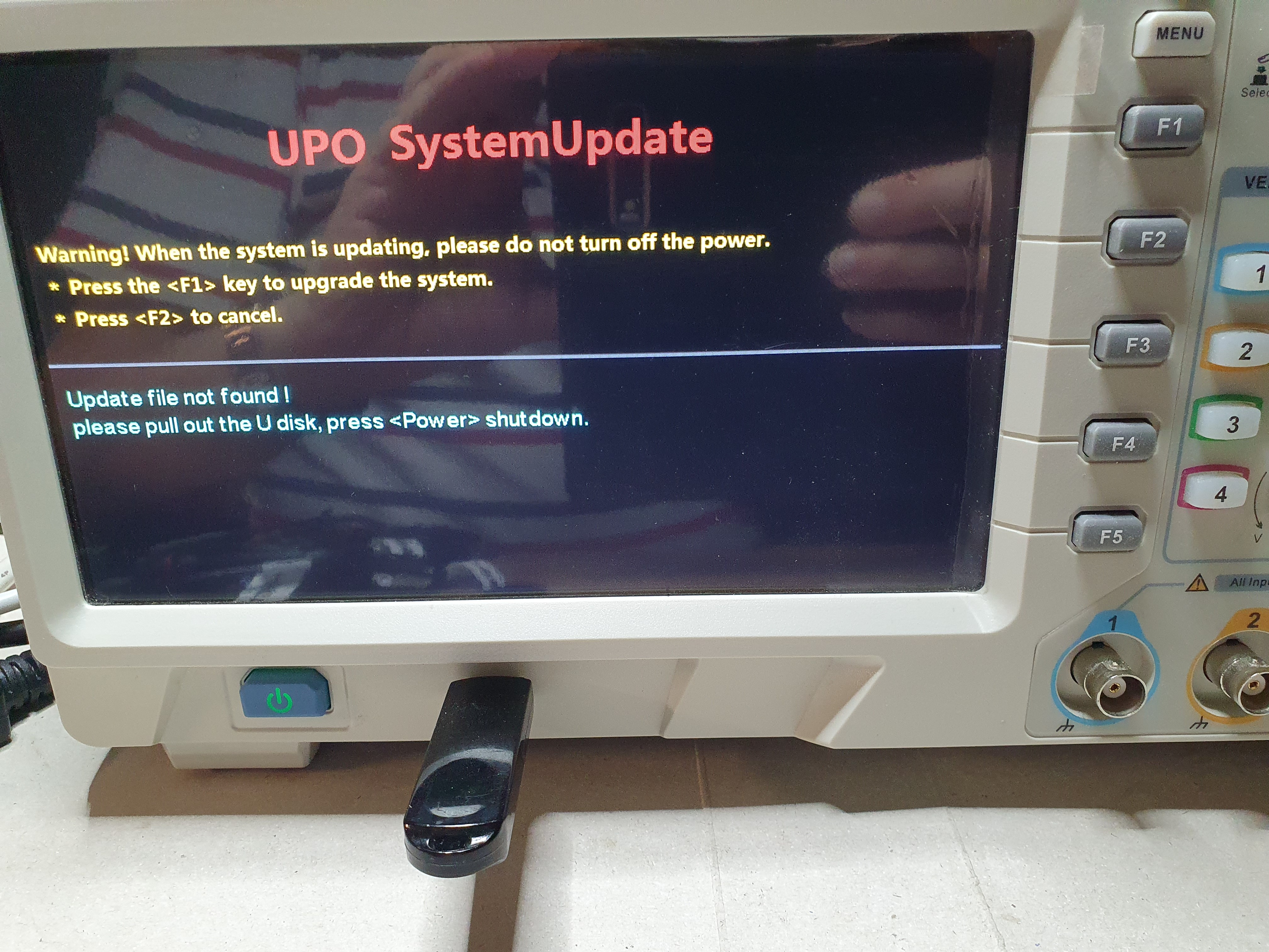

    I recently got a UNI-TREND oscilloscope UPO2074CS with an interrupted firmware update. It starts up with message in picture 1. When I put in a blank USB stick in, it searches for Firmware (USB stick blinks) and then gives up. (picture 2)
    I can't ask the former owner, he is deceased.
    I already looked on UNI-T website, could not find anything related to the UPO2000CS series. And I already emailed to tech support, no answer.
    If anyone has the firmware for UPO2074CS and perhaps the software for PC, would be appreciated!​

      Too bad, these files are for "MSO/UPO 2000" series, mine is an UPO2074CS from the "UPO2000CS" series, total different models.
      The "CS" seems to be important, here.

              There must be, otherwise pre-owner could not have started the update process.

                  UNI-T European support says, UPO2000CS series is discontinued and they can't provide any firmware or software files.
                  No I'm stuck.
