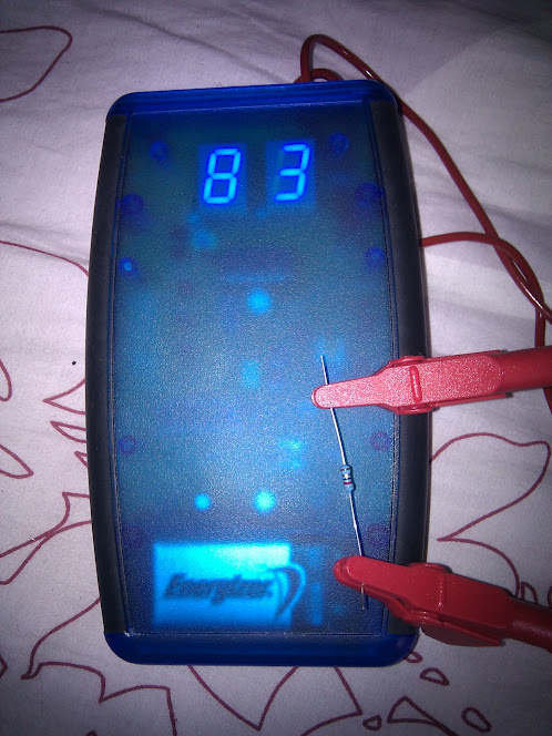

              Just to put everyone's minds at rest, he contacted me and after some confusion he got his Blue ESR meter working. Here's a picture he sent me....
