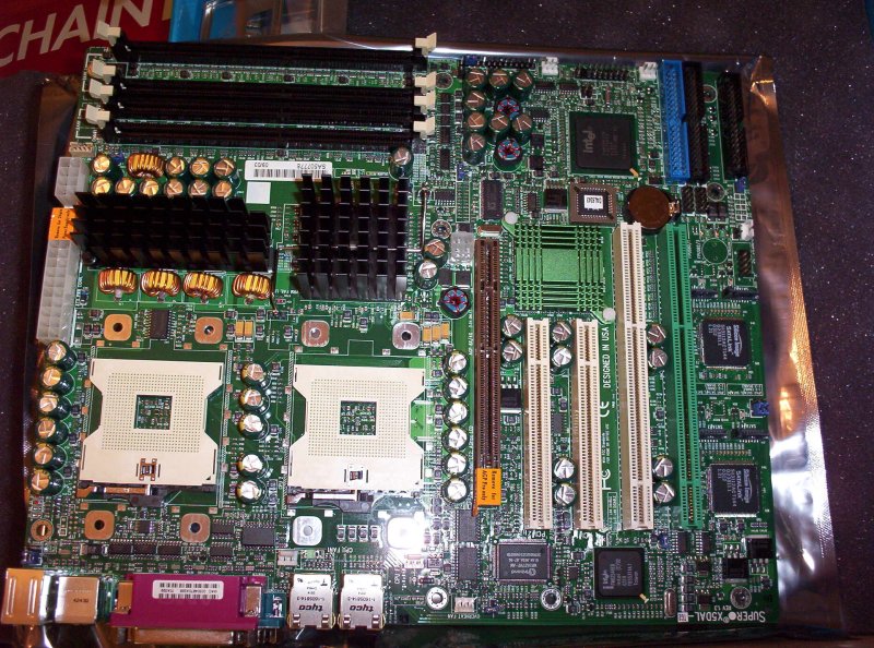

View Single Post
Old 11-05-2003, 11:15 AM   #10
Topcat
The Boss Stooge
Topcat's Avatar
Join Date: Oct 2003
City & State: Salem, MO
My Country: United States
Line Voltage: 240V @ 60Hz
I'm a: Professional Tech
Posts: 13,257
Default
About a year ago I had a Powmax 500 watt power supply incinerate itself... Smoke poured out of the case, and the PC obviously stopped workin...
I took the cover off and the switch-mode transistor had burnt beyond recognition, along with everything around it... With that kind of damage I didn't even think to look at the caps... HEH...
I've since thrown it away, but I'll keep my eyes open... I frequently recommend and use Powmax supplies!!
The 'nrsy' caps I've seen and removed bad ones from a DFI and an old dual slot2 Supermicro board. Thank God my new Supermicro doesn't have 'em... The X5DAL-TG2 has over 40 caps in it... I wouldn't even wanna recap that one... It's got a 2 year warranty though...
I've never encountered 'Rulycon' caps, but from the photo you posted, the Rulycon had a swollen top... A sign of lousy quality... Rubycon, on the other hand, I've seen many of those in many motherboards and different devices. I havent' seen any bad ones yet though.
HMM Recap this bad boy... HEH... Even I wouldn't look forward to it...
__________________
<--- Badcaps.net Founder & Owner
Badcaps.net Services:
Premade Capacitor Kits
Badcaps.net Capacitor Master List
Motherboard Repair Services
If you've come here in search of replacement capacitors or repair services, please use the links above.
http://folding.stanford.edu/
Team : 49813
Join in!!
Team Stats
Topcat is offline   Reply With Quote
