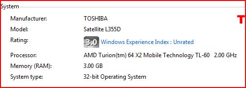

    Hi guys hope you ok on this difficult time.
    my son brought me a Laptop Toshiba Satellite L355D Amd Turion 64x2 TLco 2.ghz ,3Ghz ram 32bit with vista installed,but it's sluggish and might have virus and lack of updates,in the end doesn't work right,no updates no assistance from Microsoft.
    i tried to install XUbuntu 18.04 from a CD,it downloads right and after download it starts to install but some time after it goes blank and hangs in there ,it wont install, i restart and it asks for a boot cd , anything that i can do different?thanks.

    Re: Help with Toshiba Satellite L355D Linux install
    Please describe more clearly what's happening and at which step (post pictures if you cannot explain it properly).
      will it run a live version ok ?
        • 31294
        before you scrap windows, make sure the bios is upto date,
        you cant flash it from Linux.
        and booting from usb to flash only works if the bios is not in a damned wrapper.
          Thanks guys issue solved. i've got fooled by Amd Turion 64x2 TLco , i thought it was 64bit and tried to install 64 bit ,but i installed the 32bit and now all good.
            • 31294
            strange, turion *is* 64bit.
            what part number is it, TL68?
                Turion definitely supports 64-bit with no problem. And I personally haven't seen a laptop sold with a Turion where the BIOS didn't have 64-bit support.
                Even a dv5140eu runs smoothly under Lubuntu 18.04 64-bit. Note that this is a socket 754 one so it doesn't support Windows 10 (only up to 8, not 8.1). All S1 socket machines should run W10 fine.
                That's as long as you don't have a failing northbridge btw… RS780/RS880 (for S1g2 to S1g4 sockets) are not very reliable. S1g1 often have a 690 northbridge that's not as bad but you never know what can happen.
                An Nvidia 8400M is definitely way less reliable…
                On Intel platforms it's a bit more complicated as Core was 32-bit only while Core 2 was 64-bit but the underlying hardware platform supported both CPU. It often required a BIOS update to install a Core 2 on a machine that came with Core, and not all of them did get an update. Even more confusing on the desktop side with Pentium 4 and Pentium D…
                                Ok guys i was able to install Xubuntu 19.04 64 bit on this Toshiba L355D and it runs great now,what i did different . I did another new CD iso,
