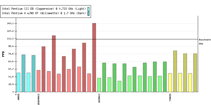

        comparison from fahinfo:
        for a single p3, so probably no big difference.
        the dual p3 probably sucks more power and runs louder.
