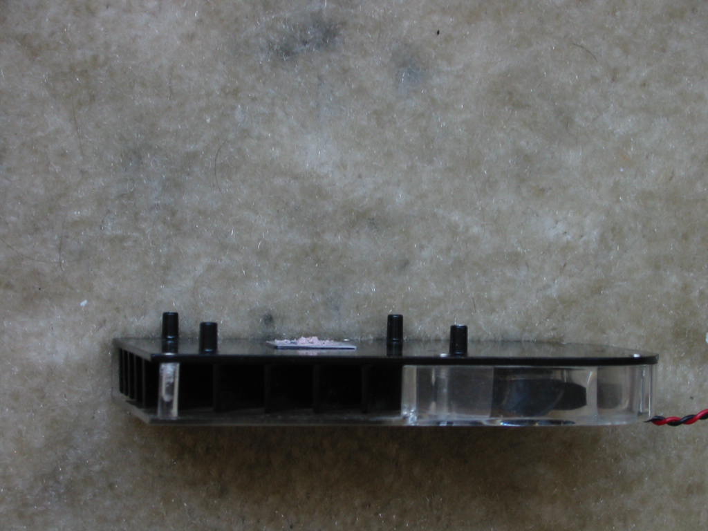

          another candidate up for modding is a sapphire radeon 8500le 64mb. i bid on it on junkbay cuz those gf4 ti cards just have overinflated prices! before the seller shipped the item, he said that while testing the item before shipping out, there was some noise from the fan and that he included a second fan in the package.
          when i got it and tried testing it on the abit ic7-g, i found that the fan had partially seized with a dry bearing most likely from the noise it made tho it was still spinning very slowly. i still had my dual 80mm fans blowing at it to keep it cool. i tested it in win98 by forcing the driver to see it as a radeon 9000 series card (because the omega drivers i was using no longer support the 8500 series) and it worked fine in many games i tested it with.
          i tried removing the fan to lube and clean the bearing but the stator broke apart while i was trying to remove the rotors. grrr! the screw holes for the spare fan the seller provided dont line up with the original fan. there is no way to remove the heatsink because it seems to have been glued down onto the gpu with thermal epoxy. so the only way is to mod the heatsink to attach a more powerful fan onto it.
          after cracking my head and having a headache from it for over a week! i finally had an eureka moment. i decided to use cable ties and to use the stator frame of the original fan as an anchor point to secure the cable ties onto. i had to run two cable ties in a "U" manner under the stator frame and then screwed the stator frame back onto the heatsink with the original screws to secure the cable ties onto the heatsink.
          took me a few tries to get it right. then i just ran the cable ties sticking up from the heatsink through the mounting holes of the 40mm fan the seller gave me for free. used one of the mini 2-pin to 3-pin fan adaptors i got off aliexpress to connect the fan to the video card fan header.
          i ran some game tests with dx8 games to see how hot it ran and if the mod cools well. i also had the usual 140mm fan blowing air over the pci and agp slot area. measuring the temperature of the rear pcb side of the gpu with the scythe ir thermometer, i got 53-54°C while gaming. so this means the gpu core probably runs at around 60°C at max gaming load. so i wouldnt say it cools well but this is the best it can do since i cant replace the heatsink as its glued down with thermal epoxy.
          so anyone have any ideas for removing and weakening thermal epoxy? does acetone work?
            No ideas, but I do know temperatures below freezing weaken the epoxy, though. In the past, I've removed the heat spreaders on PS3 GPU chips just with heating the heat spreader to around 60-80C and using brute force to pry it off. But that's always a bit risky.
            Anyways, I do have a Radeon 7500 AGP video card with what appears to be the same heatsink as yours (in fact, the whole PCB appears to be very similar to your card with a few minor differences.) And on mine, the fan still works (though it was very noisy and almost stuck when I got it), but I do plan on changing the heatsink on it, just for the sake of having a more quiet card and maybe more reliable too when I use a different fan. I'm thinking to use the same HS as the ASUS V3800M I put in post #2 of this thread.

                      Anyways, back story aside, I’ve been using these HD2400 GPUs quite a bit. However, just because their TDP is 19 Watts doesn’t mean that they actually run cool under load. I only found this after a few years of using the cards.
                      With room temperatures around 27°C / 81°F, these OEM HD2400 GPUs easily get their cores to reach 65°C at high load. The worst I got was 67-68°C with 28°C / 82-83°F room temperatures in a PC case.
                      Not that it would be a big loss if one of these died on me, given how many I have and their value (or lack thereof). Still, it didn’t hurt to try to improve their cooling - at least for fun, if nothing else.
                      So, move forward a few years after I had started my GPU collection and restoration hobby. I had accumulated quite a few different stock coolers from dead and upgraded cards.
                      In case of this HD2400 Pro/XT, I had a similar-looking (same profile, fan size, and PCB footprint, actually), but much better designed cooler that came from a low-profile PowerColor Radeon HD6670 card I got for farts/repair. After managing to get the HD6670 working with a reflow, it was clear its stock cooler was not doing its job well enough (more material for this thread someday ). Because the HD6670 uses the same heatsink hole pattern as the HD2400 (as do most low-end and mid-end Radeon HD and X series video cards), the HD6670 cooler was a perfect fit on the HD2400.
                      So how did that affect the temperatures? - Have a look at this temperature graph.
                      Basically, with the same room temperature (27-28°C / 81-83°F ), the GPU core temps maxed out at 42-43°C with 100% GPU load, even after hours of loading. That’s over a 20°C drop in temperatures! And from what I observed, the stock fan on the HD6670 heatsink did not run faster than the stock fan on the HD2400 heatsink (both being 50 mm fans), nor did the BIOS make it go faster under load (it ran at 13% PWM under full load and mostly off when the GPU was idle.) Kind of amazing what few mm of extra aluminum on the base thickness can do for the temperatures. Of course, I’m sure the extra cooling fins (approx. 2x more) helped too. Just as a comparison, here you can see the thickness of the stock HD2400 cooler (along with stock pink “bubble gum” thermal compound.)
                      https://www.badcaps.net/forum/attach...1&d=1602288323
                      So with the HD6670 cooler, the 50 mm fan has to do a lot less work - which is good, because this is the main reason the HD6670 died – the stock HD6670 heatsink was too small, which made its BIOS crank up the fan speed to keep itself cool, and that led to the fan failing/seizing. What’s even more annoying is that the 50 mm fans that typically come with these cards are sealed sleeve bearing type. Fortunately, I have figured ways now to open these (the stuck fan on the HD6670 was one of the first I experimented on.) The pictures of the HD6670 cooler you saw is with the repaired 50 mm fan. It’s not 100% perfect (had to cut through the back to service it), but it does work OK now. The HD2400 card with this modded cooler has been installed in one of my GP PCs for 2 years now and I usually use it in the hottest months of the summer. So far, all is well.
