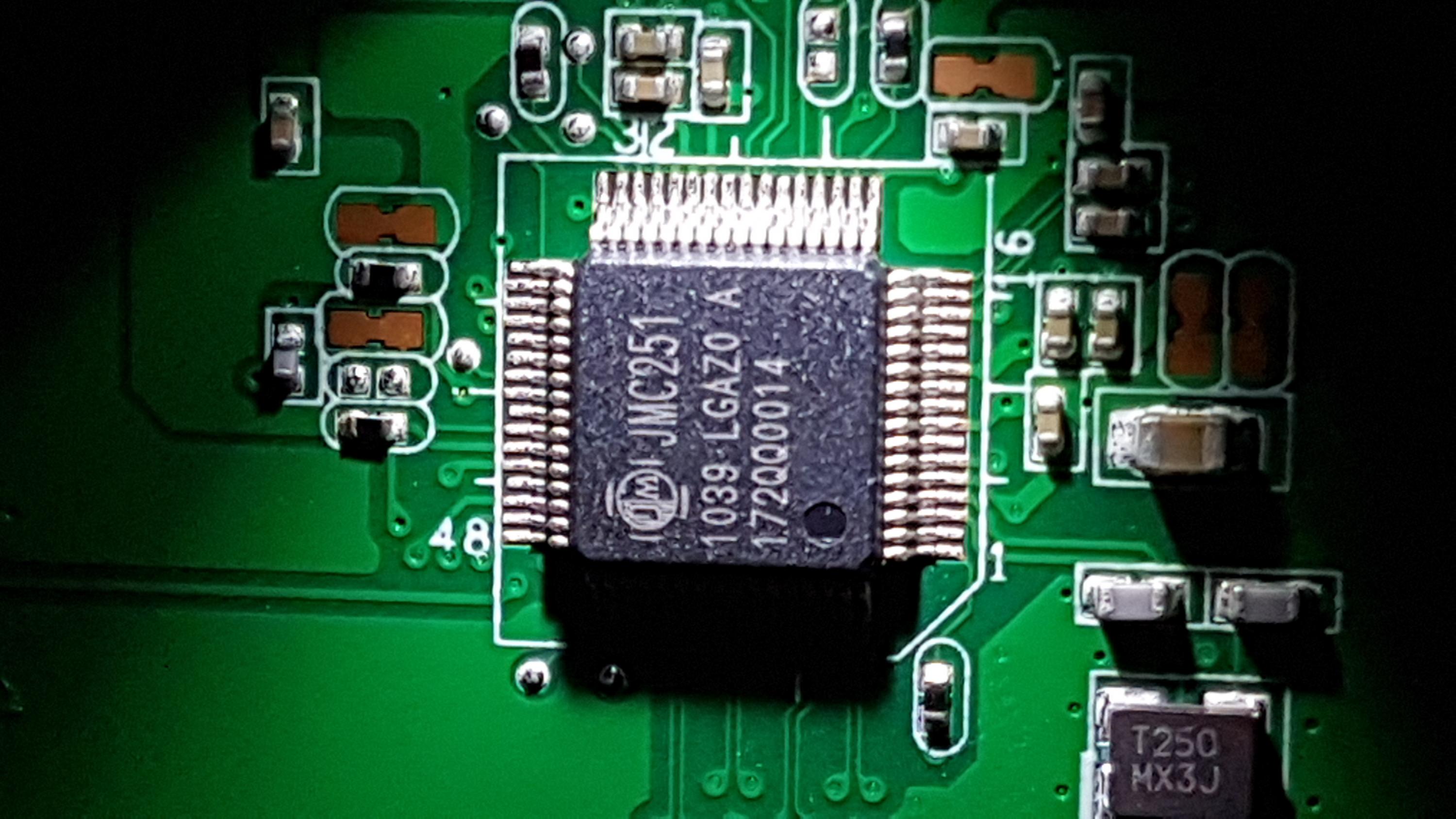

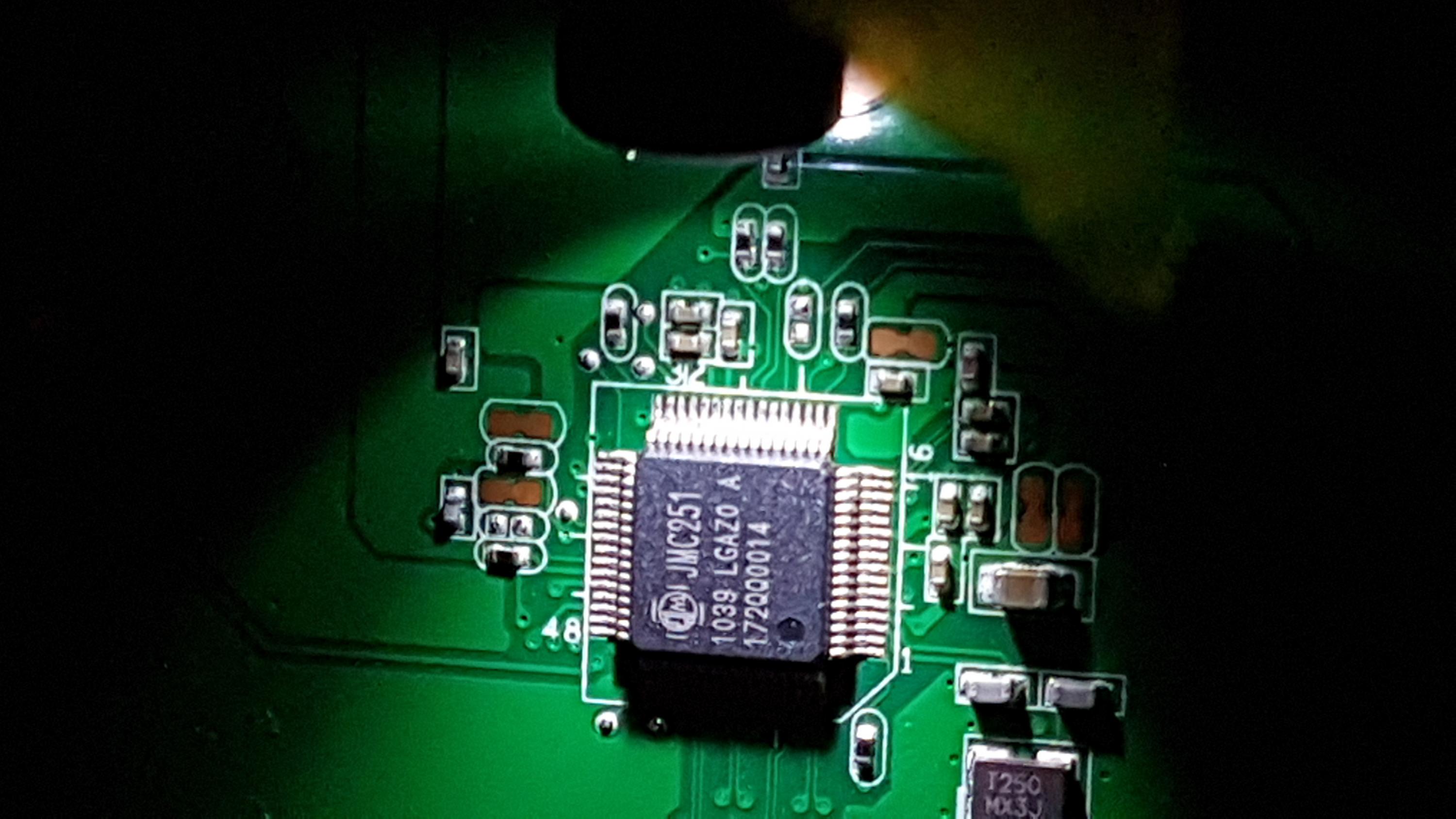

    Asus a52f
    Power is 19v 3.42amps from specs.
    It has a power fault diagnosed using dc power supply.
    The voltage gets drained to 6v and the ic on the board gets heated so am guessing that ic is bad.
    Please check attachment i need that ic

    Re: Need help findind this ic for laptop power
    Remove the ic with hot air. It's the ethernet controller.
    Available on ebay and Aliexpress.

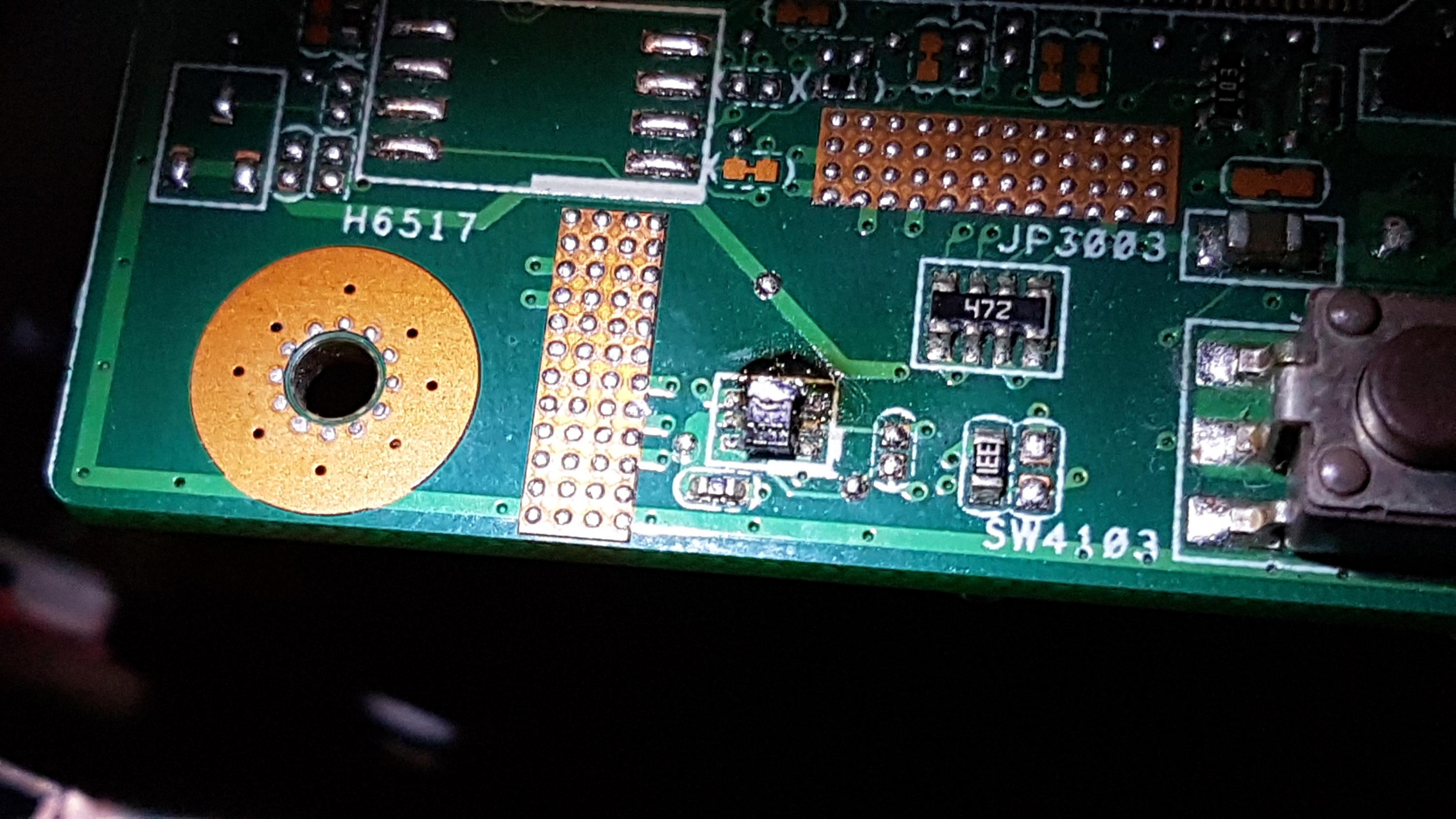

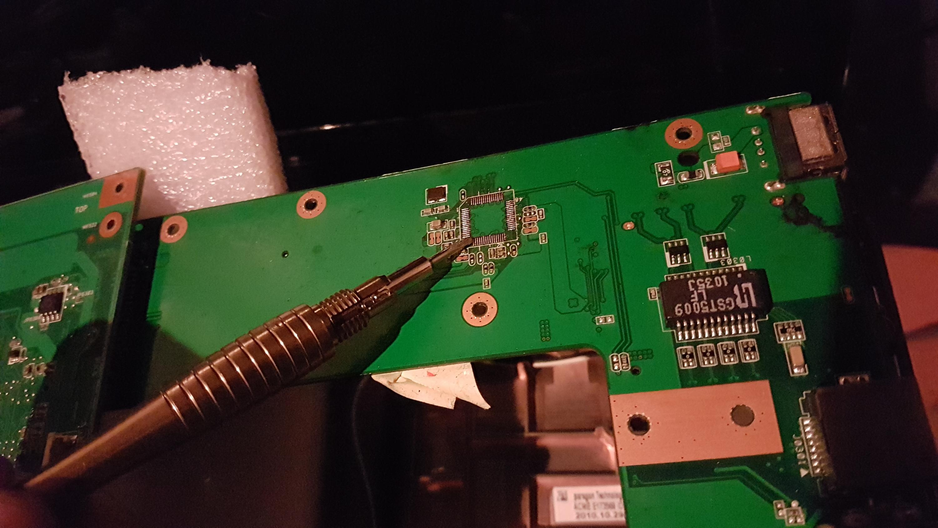

      Ok removed the ic and then voltage remained same and this part started to smoke maybe it is this that causeing the voltage drop ? What part is this any idea.
      Look at the attachment
        Where are you injecting 19v ? That Ethernet controller isn't on the 19v rail.
          Connected directly on power port

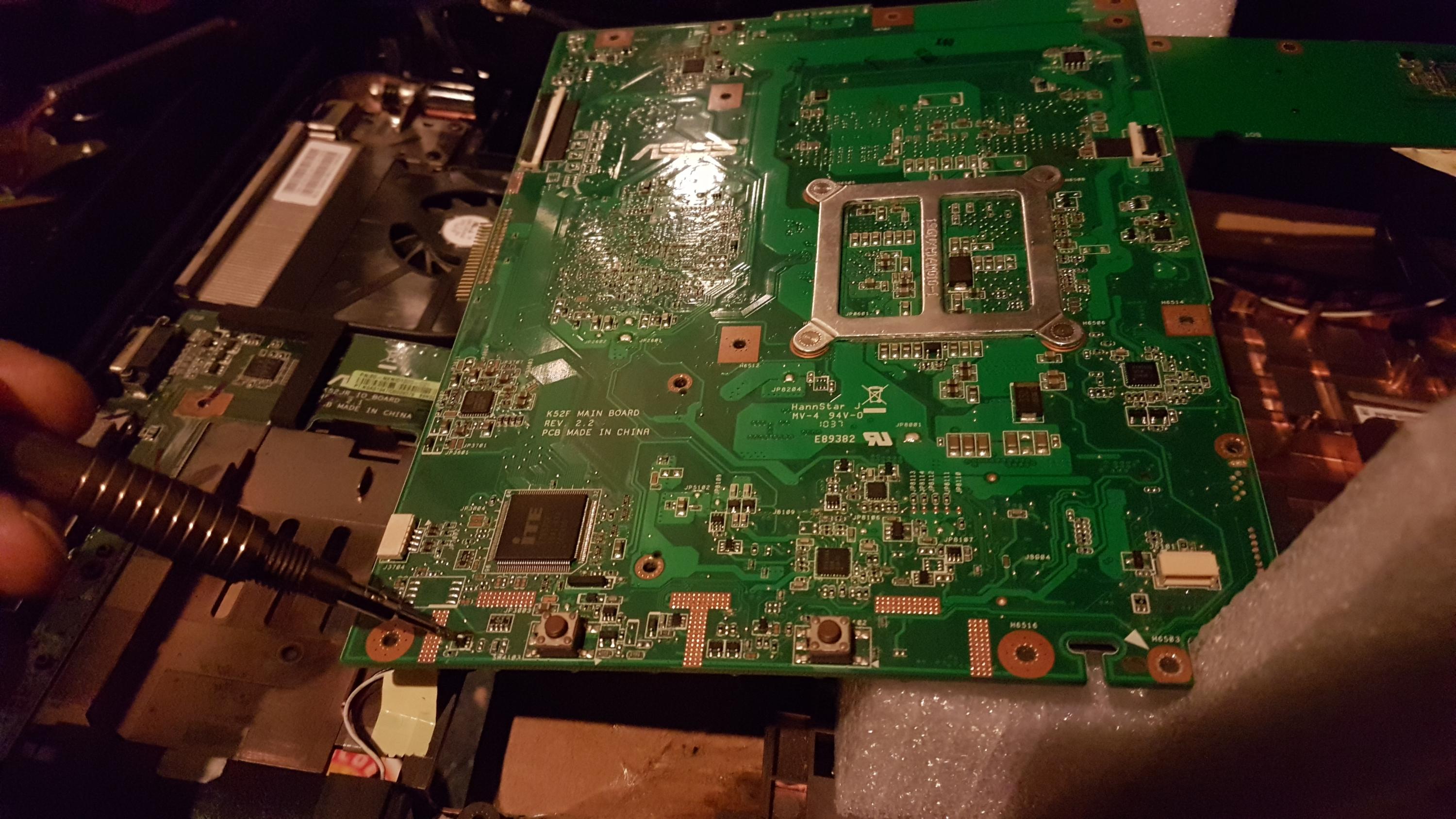

            That ic i removed you sure its not power controller why would it smoke other part of the board chk post 3 or 4
