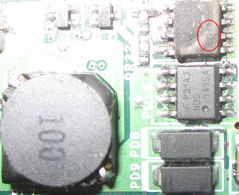

    Today I have opened a notebook HP Pavilion ze4500 because suddenly it doesn't work anymore both with battery and external PS.
    I found a melted Mosfet or at least I think it was a Mosfet: the marking type is P31AJ and it should be from Fairchild.
    The problem is that I have not found the datasheet so I don't know which are his characteristics.
    I was not able to remove completely the board from chassis so I don't know if on the other side of the board there are more damaged components.
    I think this Mosfet is a part of step down regulator with synchronous rectification because there is another Mosfet connected which is in parallel to 2 diodes before an SMT inductance.
    I hope someone here has experience on this notebook and can give me some suggestion about this part of the circuit.
    I found a screw dancing free inside this notebook so I think it has caused the short circuit on the Mosfet.

      Note the leads goes to these pads. See the one side have 3 all connected while one pin is base or gate while other 4 pins are all connected. Definately a transistor of either type. You will need to find another board that has the exact same IC part number and use it to cross to suitable subsititute and replace both to keep it matched.
      Fairchild starts this off with FDSxxxx or FDDxxxx on the IC. Read off the intact IC for us or more clearer pic with dirt cleaned up off the top of IC please. I feel this is like pair in totem pole fashion.
      I usually find that happen when the PWM IC controller that runs these is also bad, holding one of them on and frying.

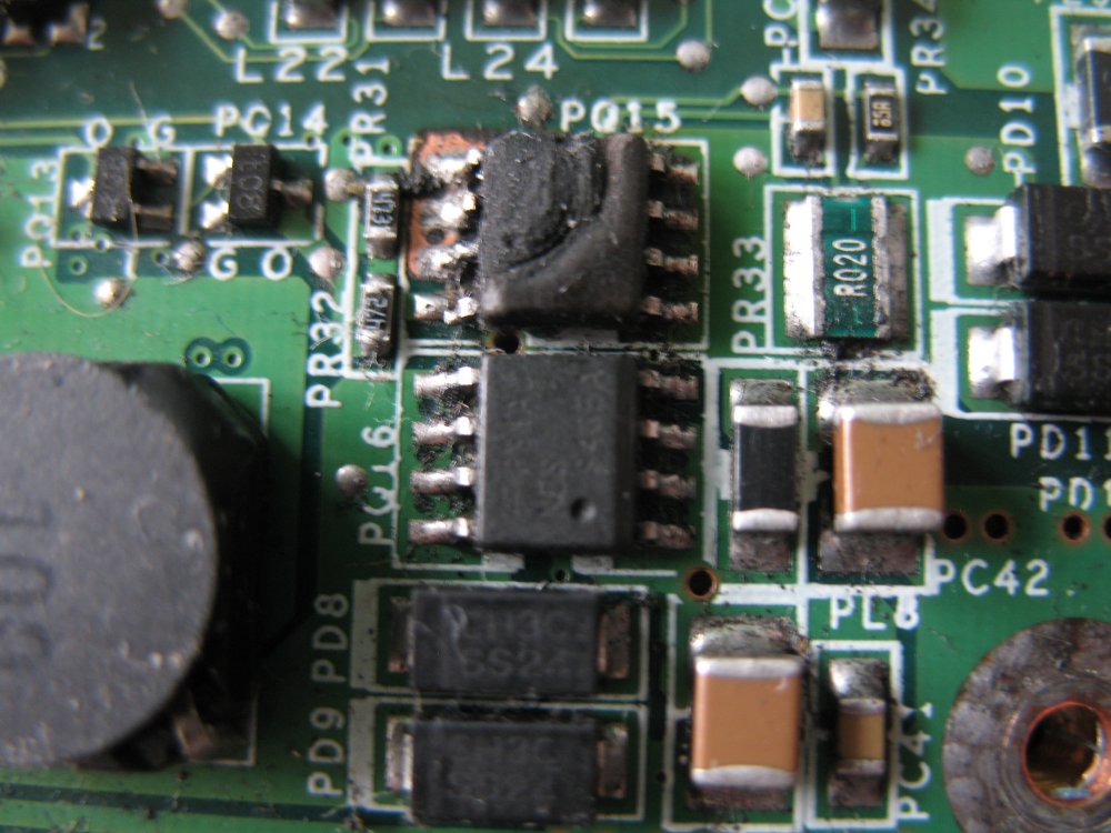

            Re: Melted Mosfet on HP Pavilion ZE4500
            Hi Wizard and PCBONEZ
            I am convinced it is a Mosfet because it has four pin connected together on one side, and on the other one there is a pin alone (probably GATE) and 3 together.
            See the new attached pics, you can read the marking type.
            The marking on melted Mosfet was clearer before I cleaned the board, now only "31A" is still visible; part of the body was so burnt that fall away when I touched it, but the marking was readable.
            Another curios thing is the date code, 9435A, if I am correct, this components was produced in week 35 in 1994, ten years before the notebook was assembled. If this is right, this is an obsolete device and could explain why it is hard to find the datasheet.

              Everyone, guy was using date code. :o
              The part number is NDS9435A, Fairchild have data sheet up on their website so you can pick out suitable substitute from junk boards and replace BOTH and try.
                  Thanks Wizard
                  I was so stupid to think the type was the first string and I didn't try to search for what I thought was the date. At least I identify correctly the manufacturer.
                  Thanks very much, now I can look for suitable replacement.
