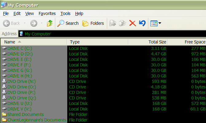

          u dont need to clone the whole physical disk of 250-500gb etc. just create an os partition dedicated for the os only. make it 20-30gb in size for recent windows e.g. vista/7/8/10. 20gb is enuff to fit on a bd-r or bd-re. 30gb is enuff to fit on a 32gb thumbdrive or micro sd card. that way if ur os ever gets borked by virus, malware etc. just overwrite the existing os partition with the backup copy of the os partition on the blu-ray or thumbdrive. this wont take more than 10-15mins to copy/restore 20-30gb of data to the hard disk and u're good to go. the rest of your data can be restored from the external hard drive backup in case of cryptoware/ransomware infection. the important point with this is the fast restore back to uptime duration with the os for enterprise mission critical computers.
          i attached a screenshot of how i partitioned my hard drive on my p4 htpc rig. its a wd caviar blue 500gb ide hard drive (wd5000aakb). drive c (fat32) is the win98se and fixed size 256mb win98se swapfile plus 2gb winxp swapfile partition. i put the swapfiles there cuz the beginning of the hard drive is the faster part. drive d (fat32) is the winxp partition. i have the winxp partition in fat32 so its much easier to access my winxp stuff in win98se. if i didnt, i would need to have two instances of the same stuff and that would waste space on the drive. the free space available in the two os partitions may be alarming to some but its fine... never had a non-booting issue due to lack of free space since i dont store my stuff in those os partitions. together, the two os partition disk images make 7789MB of data which barely fits on either an 8gb thumbdrive or dual-layer dvd.
          drive e (fat32) is the high performance data partition. i use it to store games that use a streaming engine to load data from the hard drive without having to go thru load screens. drive f, g, h (fat32) are for medium and low performing stuff. drive u and v are ntfs drives meant for media file storage since i use this pc as a htpc as well and the video files typically exceed 4gb which is the file size limit for fat32.
          together, the first 6 fat32 drives make up 128GiB (binary bytes) or 137GB (decimal bytes) which is the 28-bit lba addressing limit for win98se. thats why i chose partition sizes like that. ~30gb is also the limit winxp will let u format a drive as fat32. anything 31gb or larger, winxp forces u to use ntfs and doesnt display the option to format as fat32.
          drives n, o, p, q are the virtual cd/dvd drives for mounting drive images for games that require the game disc in the drive. much easier than hunting around for the game disc when u wanna play urgently, which then becomes an anti-climax when u cant find the game disc and u lose interest... also saves u from security issues when it comes to using no-cd crack .exe files. speeds up game loading as well when the cd/dvd drive image is on the hard drive.
          btw, for my own computers, i always make a backup image of the os partition after installing everything fresh. that way, instead of reformatting and reinstalling the os, i just overwrite the os partition if i want a fresh install of windows again. saves the hassle of 30mins to 1 hour of work having to reinstall the os from scratch and setting up the drivers again. i am aware u can slipstream drivers into the os install but isnt it faster if u spend the time just to make a backup copy of a fresh os install for a specific machine instead?
          of course, this wont work for spork who sets up and manages hundreds of different machines a day. but for me who has only a handful of machines, it works faster for my usage scenario. however, spork, u might wanna consider just storing your customer's os partition or just compress the os related folders like "windows", "program files" and "documents and settings" etc. into one rar file, then password protect it to encrypt the data to protect your customer's privacy (this step may or may not be necessary depending on privacy laws in your state or country) and then storing it somewhere on your 4tb hard drive. if your customer's pc ever comes back, just restore the os from the compressed rar file then boot the os with only that one hard drive connected and nothing else!! much more space efficient for you imo instead of cloning the whole physical disk. of course, u have to ensure that 4tb drive doesnt get attacked by virus/malware/cryptoware/ransomware or else u'll have to do a install from scratch from the dvd to preserve the "sanctity" of the os that it is "clean".
          and if u wanna have two hard drives as backup, make sure they are different brands or different hard drive models but same capacity. this is because of the hard lesson learned from raid 5 failures: identical model hard drives have a higher tendency to fail at the exact same time and u end up with two bad backup drives at the same time!!

            When I redo a customer's PC, I'll create a special OS partition, but I generally make it 40GB in size. Keep in mind though, we're not talking personal PC here, we're talking customer's PCs. The OS partition, to me, is the best way, because then we don't have to worry about data backups so much. I still backup their auto-fill data, their favourites, etc. I'll still clone the hard drive, just in case. I won't keep it forever though. That way, I know no matter what, I can always restore it to the condition it came in (ie, they refuse to pay me my money after I fix it).

            This is my partition scheme:
            Code:
            fdisk -l /dev/sda
            Disk /dev/sda: 2.7 TiB, 3000592982016 bytes, 5860533168 sectors
            Units: sectors of 1 * 512 = 512 bytes
            Sector size (logical/physical): 512 bytes / 4096 bytes
            I/O size (minimum/optimal): 4096 bytes / 4096 bytes
            Disklabel type: gpt
            Disk identifier: 21C55480-B314-422C-A6C6-6CBB5D8F566D
            Device     Start    End  Sectors Size Type
            /dev/sda1    2048  41945087  41943040  20G Linux filesystem
            /dev/sda2  41945088  62910463  20965376  10G Linux filesystem
            /dev/sda3  62910464 272623615 209713152 100G Linux filesystem
            /dev/sda4 272623616 5856077823 5583454208 2.6T Linux filesystem
            fdisk -l /dev/sdb
            Disk /dev/sdb: 1.8 TiB, 2000398934016 bytes, 3907029168 sectors
            Sector size (logical/physical): 512 bytes / 512 bytes
            I/O size (minimum/optimal): 512 bytes / 512 bytes
            Disklabel type: gpt
            Disk identifier: E51CA9BF-2528-497B-9C9D-B697FBB39F2E
            /dev/sdb1  2048 3907029134 3907027087 1.8T EFI System
