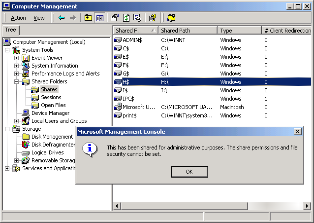

    Now that I have sorted out my other software problems with a complete format and reinstall I now have a stable Proliant 1600 server running Windows 2000 server.
    Now to set file permissions and session timeouts....oh god....
    -For my windows 98 systems, the only account they see is IPC$, no such account actually exists and making that account does nothing.
    -If I try to use Hamachi to access the system it will error out with
    Code:
    "Windows Network: 5.87.172.62" couldn't be found. Perhaps it has recently been deleted.
    and me and anyone else on my hamachi WAN will be unable to access the server.

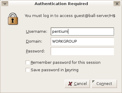

    -If I try to connect to a network drive in ubuntu, it will constantly prompt me to login and even with the correct login info, it rejects it.
    -If I manually look the server up using something like network neighborhood it will error out with
    Code:
    This server is not configured to make transactions.
    . WTF?
    -If I do manage to login and even if I tell the computer to remember the login info so I don't have to login to my network drive every half hour, it will still force me to login every half hour.
    -If I specify that an account session will never expire, it will still expire.
    *cry*

                    With ubuntu, you can see the server on the network but if you try to access it, you are not greeted with a prompt or a bunch of folders which represent the drives on the system, you get this:
                    Code:
                    "Windows Network: ball-server" couldn't be found. Perhaps it has recently been deleted.

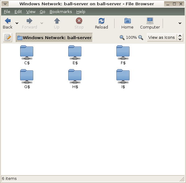

                      Okay, I went and deleted all the user accounts I added so now only the three default users exist (administrator, guest and one other whose name I can not remember). After that I then removed all the drive sharing (and selected "do not share" for each drive), reset anything I did to my security policies and then shutdown and restarted the system.
                      After restarting, two things happened:
                      1. Rupsmon hung (it's the software for my UPS, it does it every time so that's normal) but then unfroze and resumed working.
                      2. All the drives had their sharing switched back on (C:, E:, F:, G:, H: and I: were shared as C$:, E$:, F$:, G$:, H$: and I$: )
                      I then went and tried to login on all my systems.
                      -The Windows 98 systems still couldn't login (because I had not done this yet).
                      -The Windows 2000 and xp systems were able to login to any of the drives so long as I used the administrator account but then logged out a half hour later.
                      -Ubuntu was once again able to see the server and the drives however access to any of the drives required me to login as the administrator and I was logged out half an hour later.
                      -Mac systems were now able to login as the administrator but were also still able to login using the disabled guest account. I was never logged out on a mac.
                      -The unix systems were not tested as I still do not have Unix file and printer sharing enabled.
                      -Hamachi was also able to see the server drives however access to any of them required you to login as the administrator but you were still logged out after half an hour.
                      I ran another series of scans and came up clean and I also ran other checks.
                      One thing I did notice that for anything shared with a $ sign was somehow controlled by the administrator (even though I don't know how) and if you tried to modify it as the administrator it would tell you that it cannot be changed as it has been shared for administrative purposes and revert back after a restart.
                      Okay, then that must mean that my Administrator account is not properly set and any setting I have configured (like a session never expires or where a logged-in user is directed to or even another user account) is being ignored by the system and continues to bind to a set of policies the server set by itself, yet I can't find.

                        The $ suffix means the share is hidden.
                        • pentium
                          • Mar 2006
                          • 2778
                          Re: Server accounts driving me nuts
                          Interesting.
                          Anyways, I spent another two hours setting up each user account one by one and I have made progress.
                          ALL my systems can now properly login, the guest account is properly disabled and I am no longer getting a login prompt on my systems EXCEPT the windows XP computers my parents and sister use. It forces you to log back in if you happen to logout of your XP account.
                          Well it looks like now all I have to do is finish setting the camera server up and finish configuring the File and printer sharing for Unix package I downloaded and I should be set.
                          I also learned something from this: If it's working, don't screw with it.
