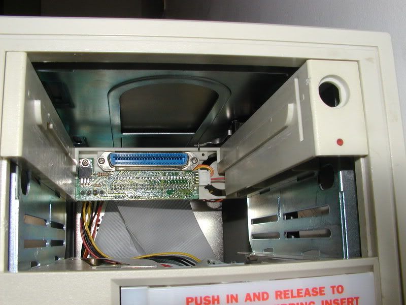

I first grabbed one of my dead external SCSI cd drives and pulled the sound components and the drive itself. I then removed the keylock on the drive bay and pulled the wires back so I could connect them to the NO (Normally Open) contact and the common terminal on the switch. After pulling the wires, connecting the power and scsi cable and mounting the bay it looked like this.
I now needed to mount the switch.
To help prevent data loss, make it so that the caddy socket is still connected to the bay when the switch shuts off. This means installing the caddy until the connector is half seated and then screwing down the switch while at the same time noting that the pin is touching the back of the drive and the switch is in the off position.
In some cases, the pin might be too short. Using pliers, bend the arm downwards until at least half the pin is making contact with the drive.
Once that is done you can set the on position.
Being positive the switch is secured to the bay, push the caddy all the way into the drive. You may or may not hear the "click" as the switch engages.
If you do, double check that the connector is fully seated. If you did not hear the click, go with pliers and bent the arm towards the front of the drive A LITTLE. Continue to adjust the arm until You get the click for both on and off in the right place.
Now go back to the two wires you removed from the keyswitch and connect one to the common terminal and the other to the NO terminal. USE electrical tape at the least. I should of not used duct tape.
