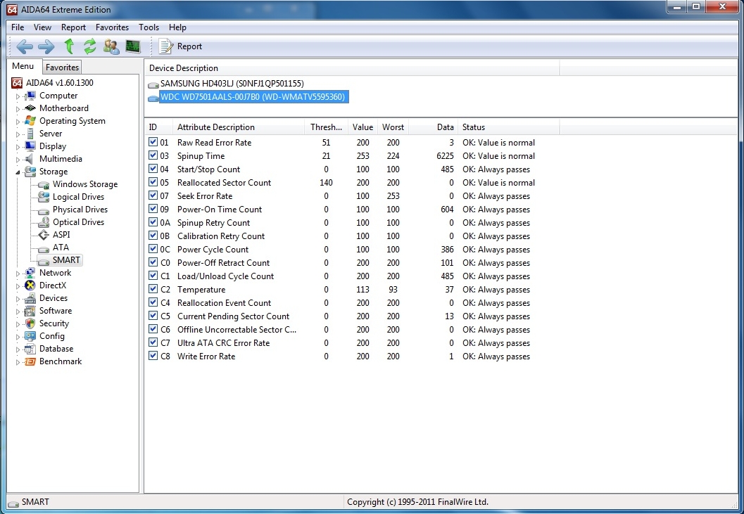

    Pretty much once every 3 months the last two years this machine has had a bluescreen or locked up. I have checked everything several times, smart logs looks nice, memtest is no problem, changed memory, changed psu, reinstalled and so on.
    And now when the machine locked up I took it apart to see if it was possible to backup the 2TB green driver - I was pretty sure it was to blame but no, backed up the drive and had no problems. Did a backup of the black 750GB too and had no problems and decided to check the drives with Wd's test program.

    I guess it's not a smart thing to only trust the hd smart logs.

    Yes, you shouldn't only trust the SMART logs, but in this case, yours is actually showing problems. You have 13 pending sectors - that's not good!
